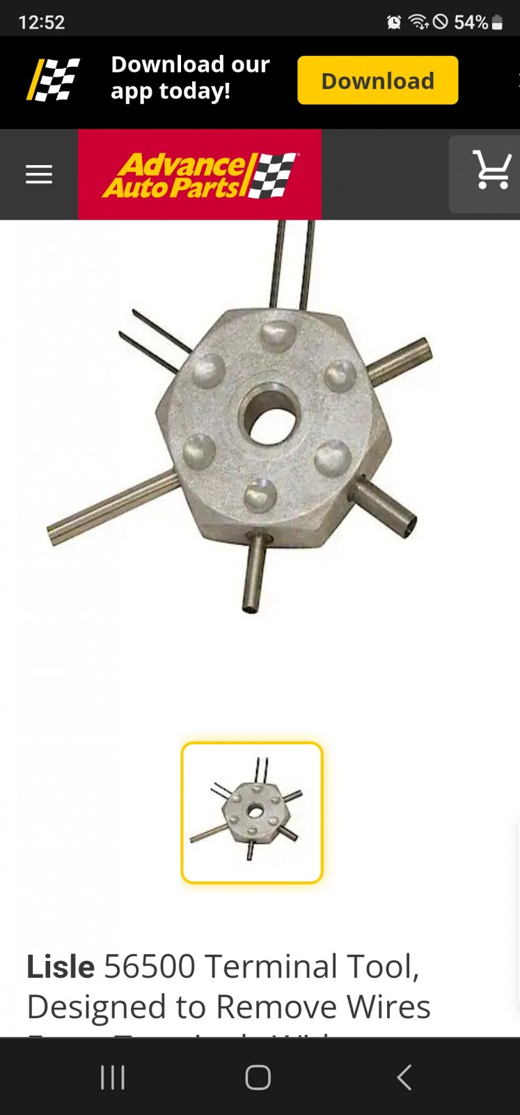

Have you thought of pulling the pins and tightening them up. I've one of these and find it very handy.
