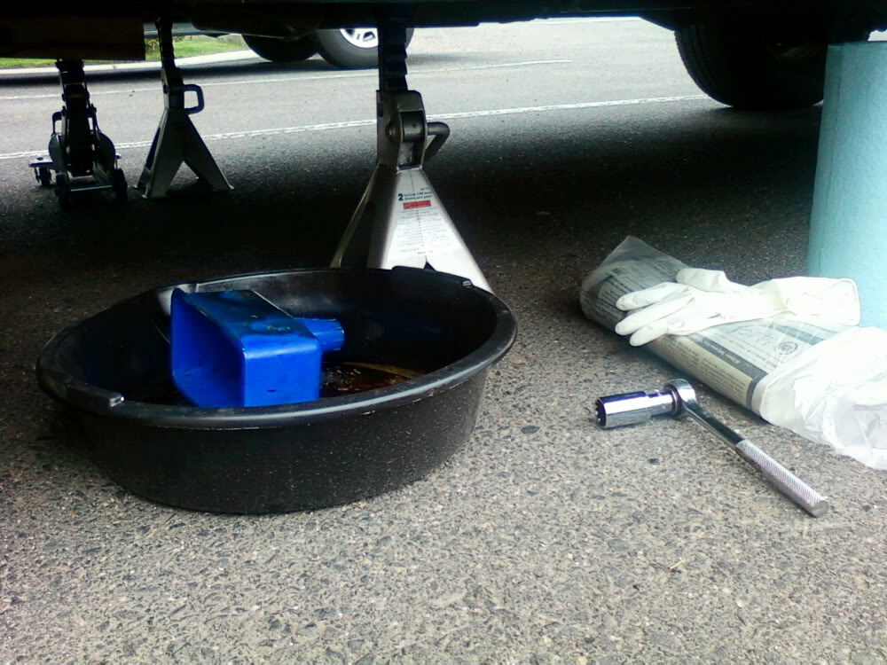

Once again, another simple DIY that I wasn't able to find around this site. Changing your oil is relatively easy as long as you have the appropriate tools and take your time so you don't make a mess. Here's what you'll need:
-6 qts of your favorite (preferably full synthetic) 5w-30 motor oil
-a new oil filter, I used a Mobil 1 filter, any auto store will be able to look up the part number for you
-drain pan
-funnel
-15mm socket and torque wrench (possibly a breaker bar if the plug is on there too tight)
-filter wrench or screwdriver & hammer
-newspapers, shop towels, latex gloves
-jack and stands
1. Jack the truck up from the frame rail and get it set on some stands. You only need about 12" of clearance to get under there, so if you took off your running boards, you might be able to do this on the ground.
2. Position all your tools under the truck or within reach. Spread out newspaper under the plug and filter area and center your drain pan. Make sure you can move around easily without knocking the jack stand or touching the exhaust parts.

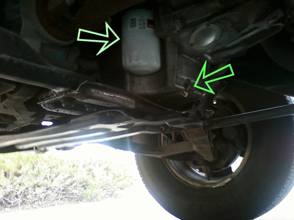

3. Use a 15mm socket and break loose the oil drain plug. If it is too tight, use the breaker bar (make sure you're turning the right direction first!). It is a horizontal bolt plug that faces the rear of the truck, directly in the middle of the oil pan, just next to the filter (which is on the driver's side). Slowly remove the drain plug by hand. If anything other than oil is dripping out, put the plug back in and try again.

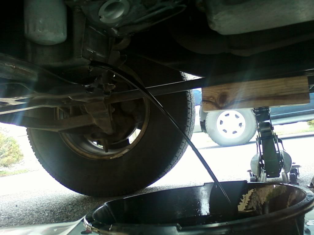

4. When you have the plug almost all the way out, get a hand on the drain pan. It will drip directly under the plug at first, but as soon as you remove it, the oil will arc out with some serious velocity. Get ready to move the pan QUICK or you will spill A LOT.
5. Let the oil drain until it slows to a drip. This could take upwards of 5 mins. It flows faster if you open the oil filler cap in the engine bay to let air in - just be patient. Crack a beer while you wait . . .
6. Clean off the drain plug and wipe around the plug hole to get off any oil and debris. Slowly thread the plug back in and wipe off any residual oil. Thread it by hand and make sure you don't cross-thread it. Torque to 22 ft/lbs (just SNUG if you don't have a torque wrench, don't over-tighten).

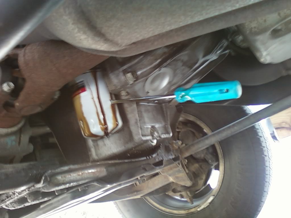

7. Now on to the filter. I like to punch a hole in the bottom of the filter and let the oil drain out, that way when you unscrew it you don't have to worry about it spilling out all over the place.
8. To get the filter off, you usually have 3 options based on how tight the filter is on there.
Method 1: Remove it by hand. Consider yourself lucky and move on.
Method 2: Use a filter wrench. This usually works pretty well, but a good filter wrench that will work on most filters is usually $20 or more, which is why I prefer method 3.
Method 3: Hammer a flathead screwdriver through the entire filter and out the other side. Grasp the handle and turn. You might have to do this a couple times to get it loose enough to turn by hand.
