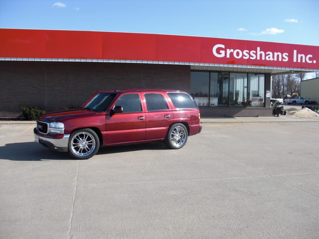

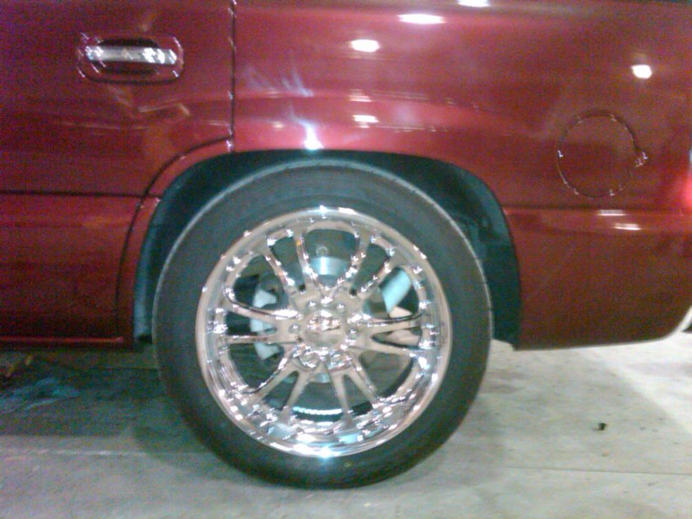

Well today I finally body dropped my Yukon. It was definatly a fun time doing it! I took some pics, but there in my Yukon and its still at my shop. It took us about 2hrs because we took our time. Just the body drop lowered it 1.25" at the very least. We made little rubber inserts to go inbetween the body and the frame, but they were only like 1/16 thick. Like Clean95 said, the only hard part was the front, and it wasn't even that hard, it was just a pain in the ass. Here is 2 pics from my cell phone, and there not the best. If you guys have any questions just ask! Thanks to Clean95 for the help when I called him today!
The first pic is just the body dropped down. No bolts or tightened, and the spring Isolaters still in.
Will get more pics tomorrow!

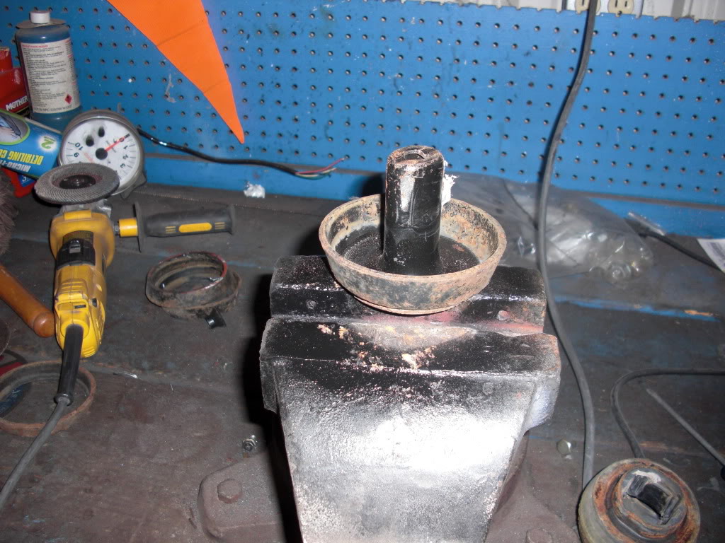

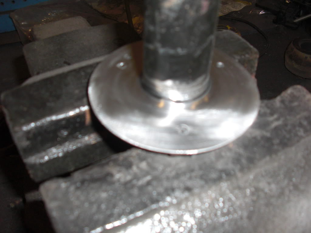

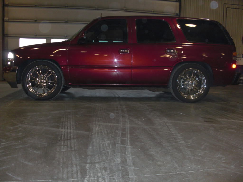

Thats what I did max. The rear hatch is so close to touching the bumper, its crazy. The more I measure today, it lowered it right at a 1.5" in the rear, and 1.25" in the front. I am very happy I did it, but it is a little louder in the cab going over bumps, but It's not even that bad to worry about it!
Here are some pics!

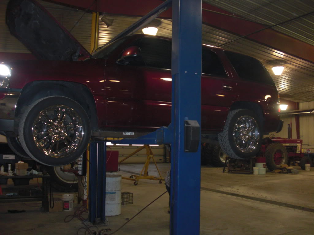

Just got it on the lift

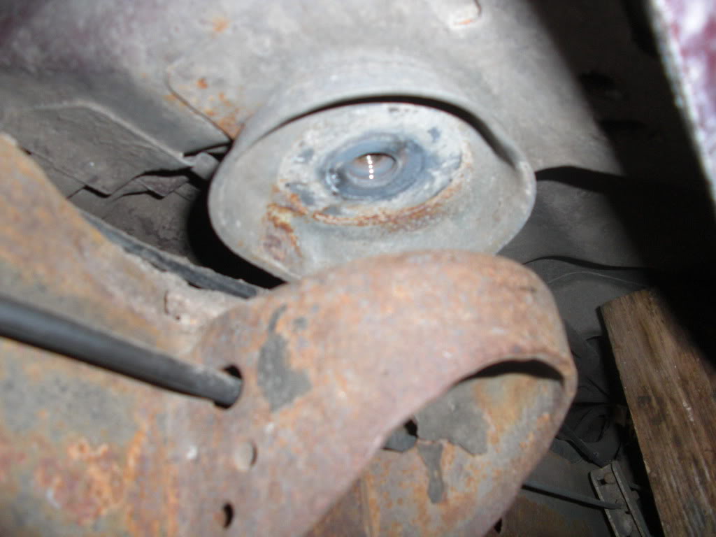

The piece you cut. You cut the circle part that is stucking up flush with the cup.
This is how you can make it lower, we cut this one just for an example to show you guys then welded it back together!

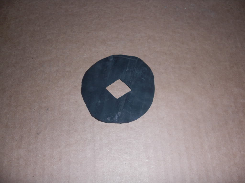

The little rubber piece that we put in place of the big bushing. This is just so the frame doesen't squeak against the body.

First time off the lift!

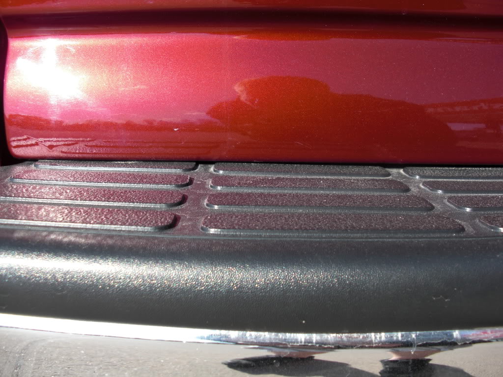

The gap between the grille and the Bumper.
The gap between the rear hatch, and the bumper! Can't even it a paint stick between it! haha

Also just curious how you guys went about lifting the body up with it on the lift so high in the air....floor support jacks??
B
8
89 chevy
Jan 23, 2010
212
We used a tranny jack, with a piece of square tubing and thats how we lifted it up.
