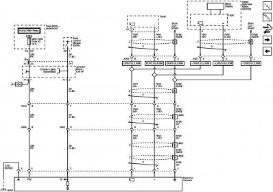

Has anyone installed the OEM backup camera and rear view mirror monitor combo? I found someone selling the Onstar/Video Monotor mirrors and soemone else selling the OEM cameras. The guy selling the mirrors claims that newer LT or LTZ Tahoe/Suburbans are pre-wired for everything making it almost plug and play. Although that would make life so much easier, something is telling me GM did not do us the favor of adding those wires.
Aside from removing the liftgate trim panel and searching for the camera plug, can anyone confirm wether or not the wiring is already there from the liftgate to the console for the camera and the mirror harness to the console for those connections. I suppose a reverse activation switch would also need to be added.

I just completed an all OEM rear view camera install on my wife's 2011 Tahoe. It's far from prewired but it's an easier install than one would think. I bought a OEM Mirror from a guy on Ebay and I bought the rest of what's needed from the dealership. You'll need the GM accessories part# 19170348 rear vision camera kit for dealer installed navigation. The guy on Ebay goes by copper_z71 and he will provide not only the mirror but, a sheilded cable that you'll need to extend the wiring from that would normally go into the NAV unit and make it so you can connect it into the rear veiw mirror itself! I just finished mine yesterday and it works perfect!

I bought the inside rear view mirror for $200.00 and the GM rear camera kit was $249.00 with my GM employee discount. So for $450.00 approx. I think I did OK! As far as the install - It was definately a long process. All and all, it took about 10 hrs from start to finish, but I'm pretty particular about how I do things.

Do you know the wires that I could tap into to pull the camera video from my factory rearview mirror w/camera to my after market head unit?
The video positive is the white wire in Pin 6 at the mirror and video negative is the blue in Pin 7.
Cut the end of an RCA cable off and connect the center conductor to the white and the shield to the blue...
