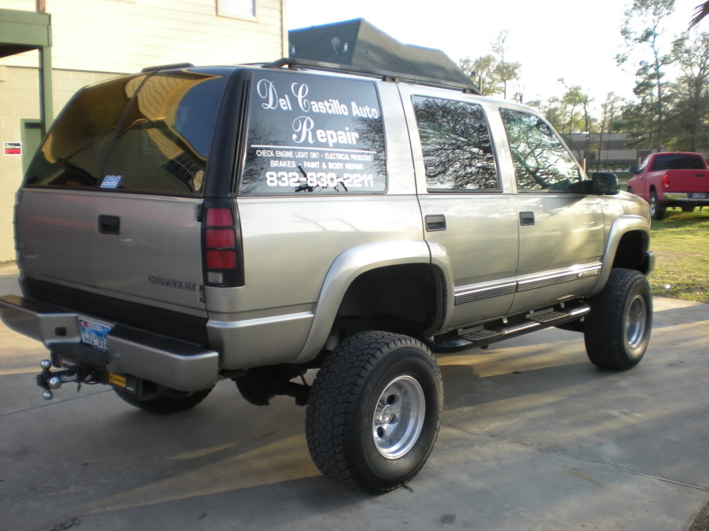

Hell I think that the gap guards is all needed to make it look good. I got a 3" BL on my Z71 and I personally think that altering or modding the stock rear brackets or hitch is not going to have the same strength as the original stock location. Front bumper is the only one that I raised. Heres a pic:
Note the rubber gap guard. You cant even tell I got a bodylift on her except the bigger gaps in the fender wells.
