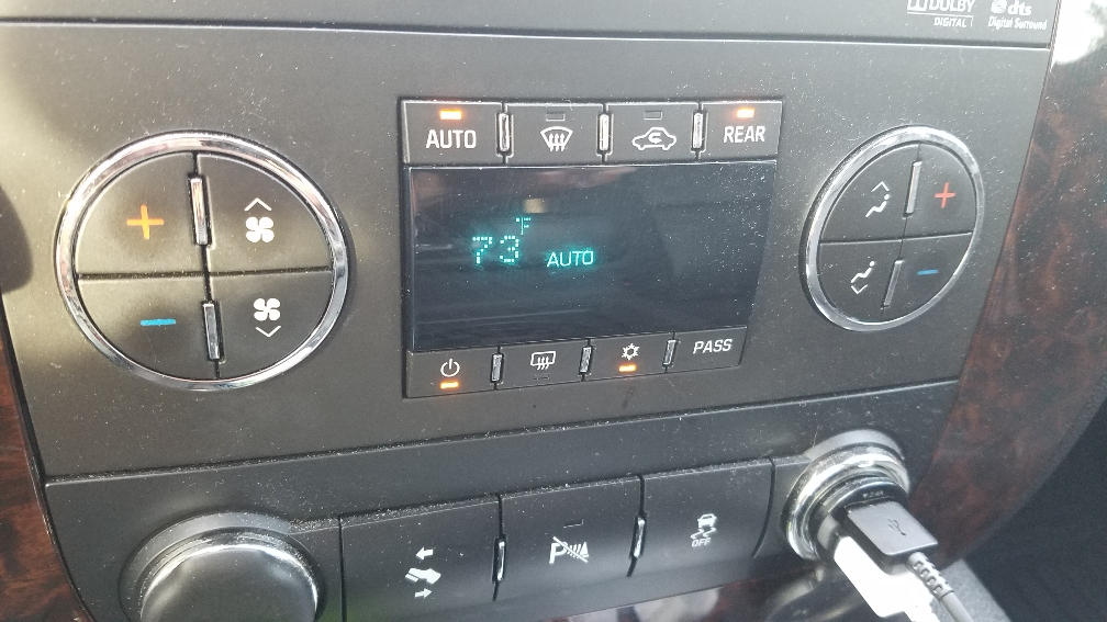

When I push ac or recirc buttons they just flash 3 times and do nothing. Last summer tried doing relearn reset procedure disconnect battery wait hook up hold buttons etc that did nothing. Read before ac won't work without recirc. Checked all fuses and relays. Where is the recirc door and how is it changed was thinking trying to replace it with one from parts truck but can't find any info on how to do that for the 07-14s anything else that could cause it?

You've got another problem Carl and really need a bi-directional scan tool that can read the BCM codes to know what is wrong with it. Those resets do nothing. Could be just low on refrigerant or a sensor could've gone bad. Don't guess, put a Tech-2 on it and know in moments what needs fixin'!

Defrost setting will disable the resurc feature. I’ve also encountered situations where <50* temps will defeat the resurc feature like that.
This may head off any concerns...
https://workshop-manuals.com/gmc/ac...7/a/c_indicators_flashing_(normal_condition)/
This feature is sure to carry on into past and present models in a slightly different way to somehow save a drop of fuel or ... some manufacturers do stuff like this when cold to allow already present cold air into the car while letting the a/c system equalize the system pressures. It prevents a slug of liquid refrigerant from getting into the compressor.
There’s a lot of different scenarios but the $279 tech II purchase will allow you to master your destiny and pay you back several times the first year.
