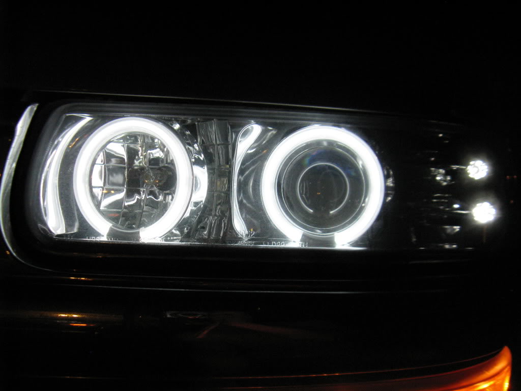

Even if you do little to no highway or interstate driving, it's important imo to have headlights functioning properly for safety. If you really need the halos, get some ccfl's or smd led halos(the regular led halos suck) and add them when you do a retro. Most aftermarket projector housings are made for halogen, not hid. So, for proper hid headlights, a retro is most necessary. If you don't want to do a retro stick with depos or the denali projectors. They will be better than any aftermarket halogen projectors housings. If you want to do a retro there are a few write ups around here. Here is one that seems very straight forward and fairly easy and appears to result in really good output-

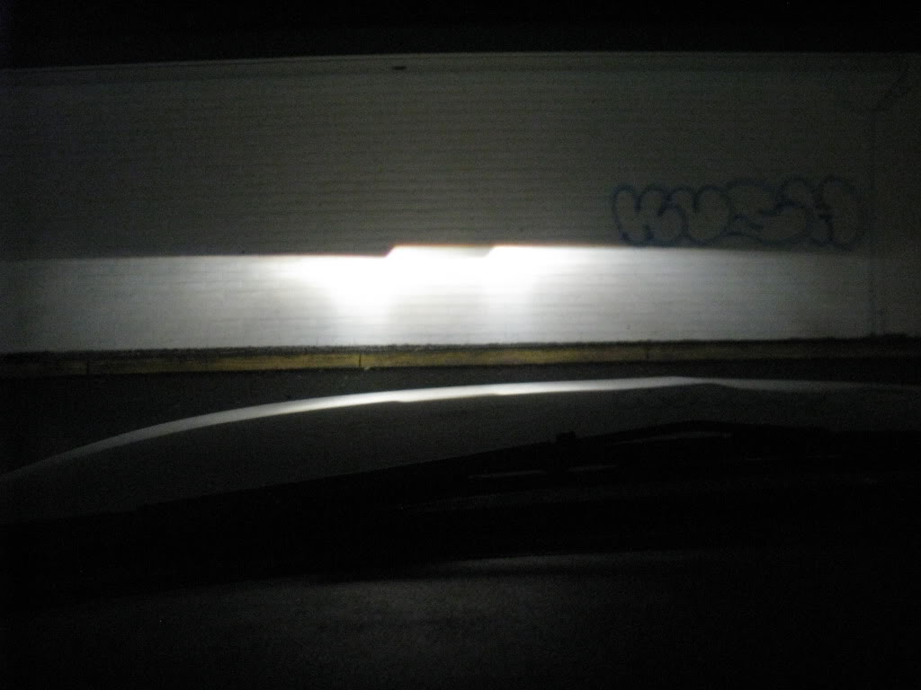

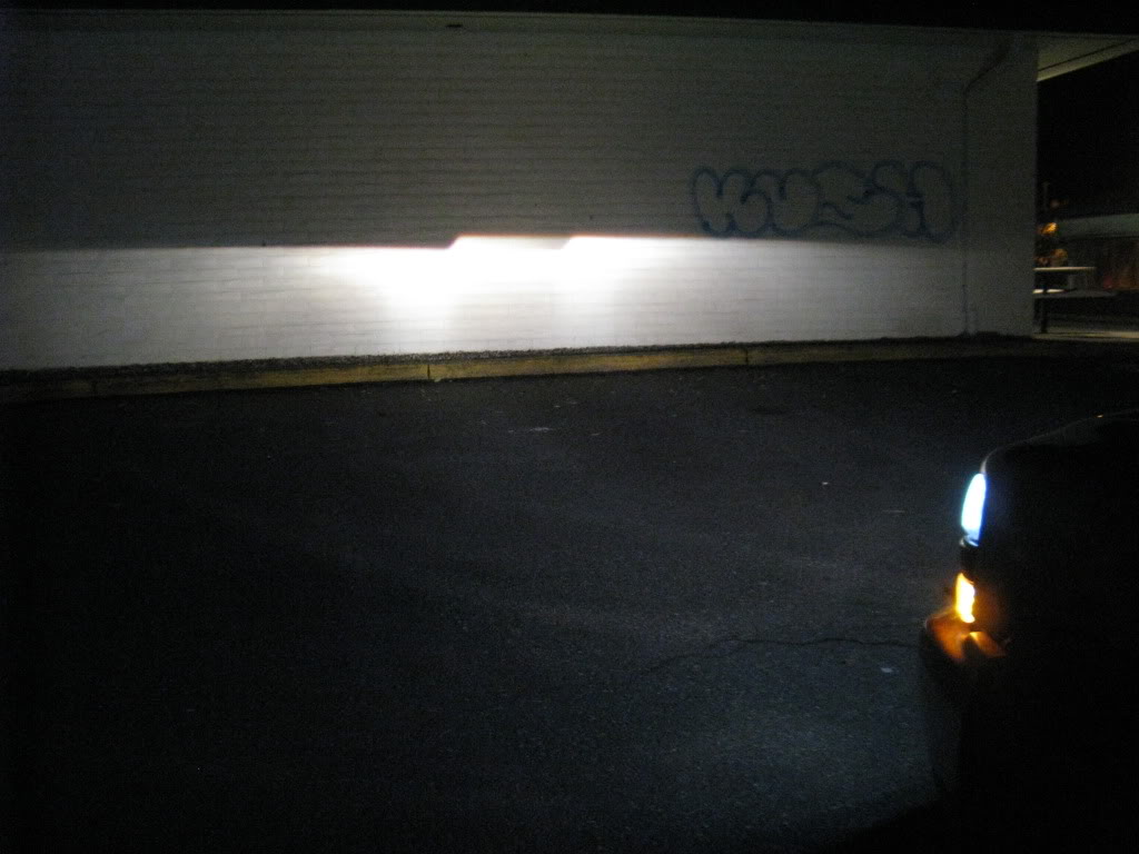

If you just want some halos and don't care about output with hids, search for sonar ccfl projector headlights. I have them for my tahoe but haven't gone hid because of the horrible output. Here's a pic of mine with halogens-

Like psyph stated depos are good for HALOGEN bulbs and somewhat ok for hid to get the best setup for hid retro and to use HIDs legally without blinding people you must put hids in a hid projector for maximum output, safety, and visibility... the Morimoto Mini H1 set up can be aquiered by may at trs (see my post above) for relatively cheep.. If you don't want to join another forum you can still search through it there's endless mini setups installs and how too do's very helpful site highly recommend

DFW those. They look like stock denali projectors cleared with halos. Those would be awesome for a retro
The Depos are an exemption to this. The cutoff is great and does not blind oncoming traffic.
