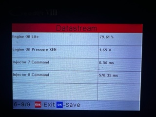

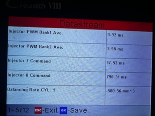

Cruising on the highway today and CEL sets. Hooked up my scanner and its p0300. Looking at data the rest of the way home I notice my TPS has ZERO voltage via scanner. Also misfires on cylinders #1 (2 misfires), cylinder #4 (826 misfires) and cylinder #7 (3048 misfires). Truck does hesitate and buck just a tad in low gear going about 10-20 mph (which thought it was an evap leak that was fixed due to gas cap just does it not as rough) and shift hard a tad rough every now and again. No other codes, no reduced engine, fires right up, really runs like nothing is wrong. Oh and p0300/misfires come and open throttle/highway, no misfires city.
What would cause the TPS voltage to read ZERO instead of triggering a TPS code p2135? Could it be the catalytic converter not allowing flow which prompts the p0300? Only got about 10 miles on motor (brand spankin new). 6.0 LQ4. Figured I'd get extra input before I go fiddling with things.
