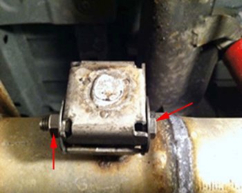

The parts catalog calls out not one but two different exhausts for this truck (probably one for the AVF trucks) so while I figure that out I figured I'd just hold the valve open. This remedied the squeak as I knew it would but it also added a great growl to the truck as well; much like the 2014 and previous had.
I'm also seeing a slight uptick in gas mileage at a time when it should go down due to colder weather. I have yet to hear any really bad drone at all in fact with my intake I havent really heard any YET.
The cool thing about this is it literally costs a $1.00 in parts LOL All you need is a 1/4x20 2" Bolt and a washer/lock washer. You rotate the valve counter clockwise till it stops and then put the bolt in under the spring holding the two halves still as shown.
