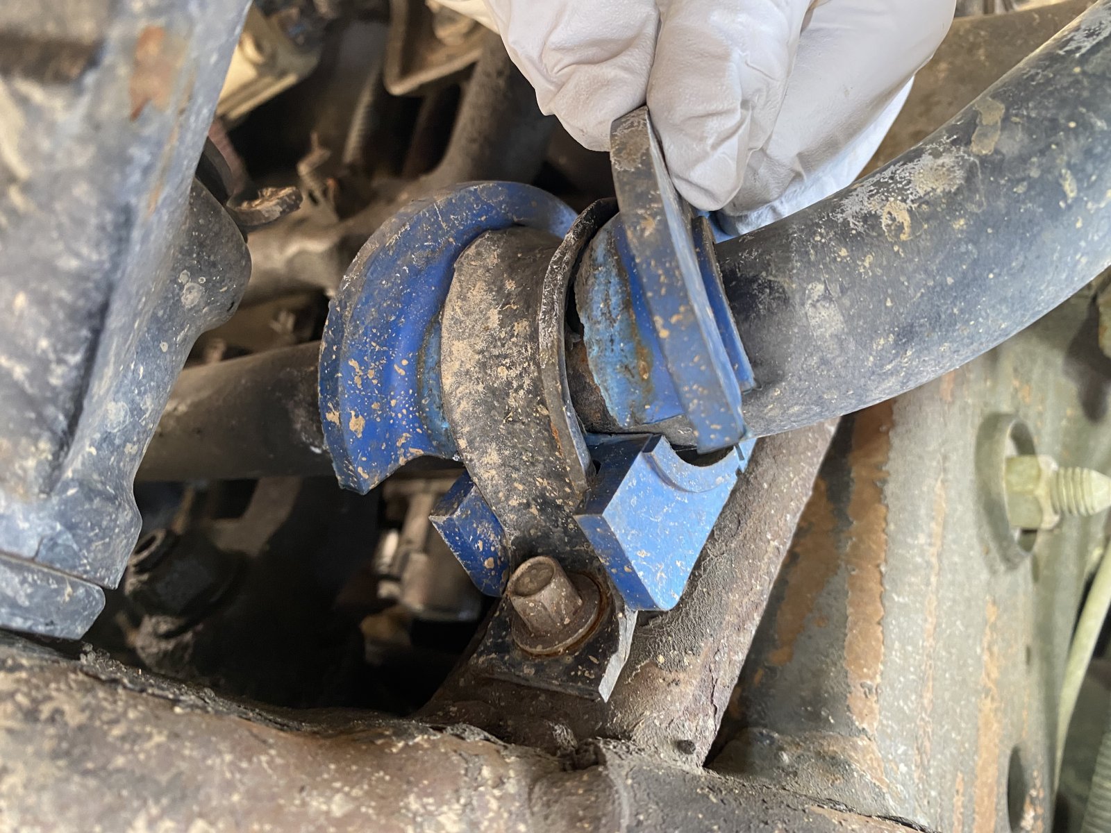

Does your Moog kit include the saddles, and are you using them, or the old ones? Do your instructions say that you could or should lube them?
No instructions just the bushings in a box. I did re use the old ones and put only a dab of gease to coat it this time

They might be the wrong size. Hopefully you bought some poly ones from Energy Suspension, the ones with the grease fittings like I suggested. Mine have been on for 30k or more and still look great. And believe me I drive it hard.
Wow that is exactly what mine look like. Did you ever find out what the problem was?

Sup all. So I have. 2001 Yukon Denali awd with 195k on the dash. I recently converted the air ride to a strut master kit since both my back shocks and compressor were busted. I also replaced my front sway bar links and bushings since they were cracked. Not 6 months later the bar bushings are getting loose again and allowing play. Should I go down a size on the bushings or try a different brand? I want to say I used mook or some brand close to that.
Thanks
Bro let me know if you end up figuring out what the problem was . I have the exact same situation.
I’m blaming it on defective moog bushings cause the new ones I put on are still holding strong. No issues so far.
