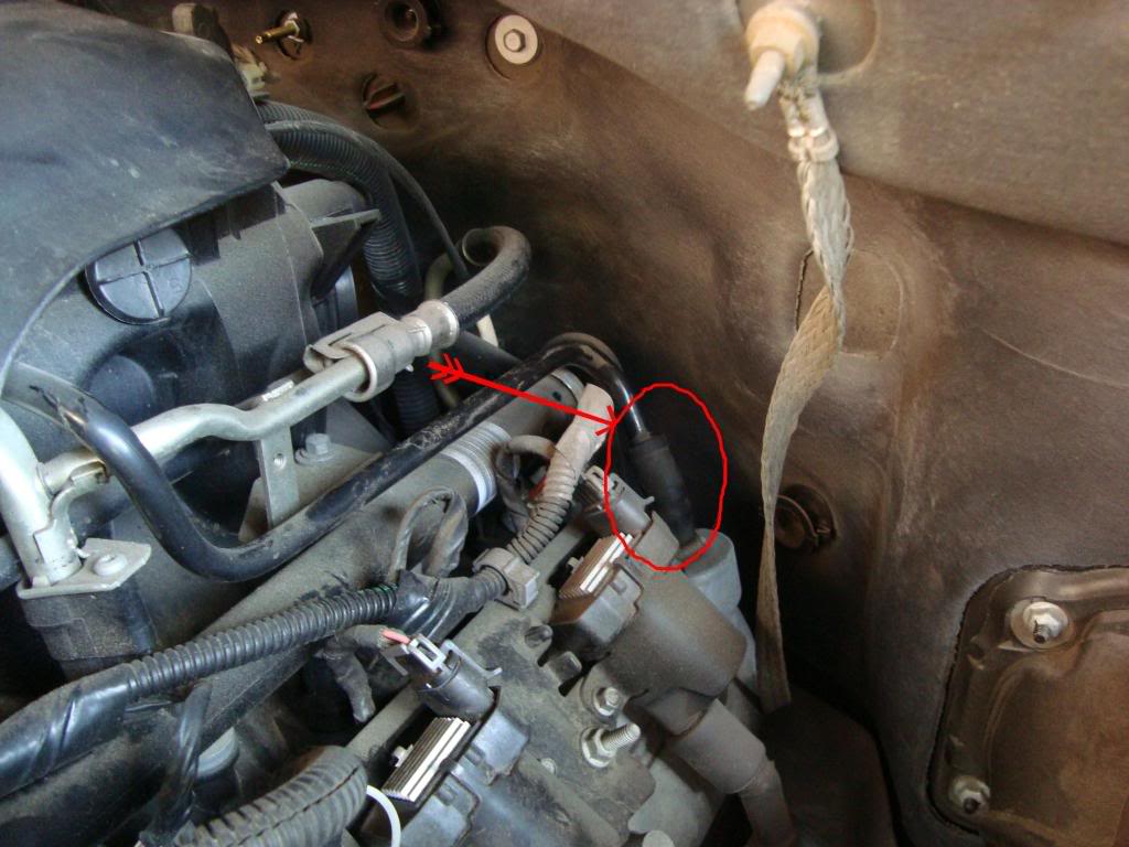

You can get this stuff at walmart as well, its only 8 bucks a can. i did my 03 tahoe about a month ago, put about half in pvc hose, half in oil, and a full can in the gas. Got alot of smoke but didnt notice a big difference after running it through. The one thing you have to watch out for if you put it in your oil is that it will definately get dirty faster if its the first time using it from all the junk getting broke up in there. I think i noticed a slight increase in mpg but nothing to do backflips over. all in all i am happy with it and plan on doing it every year now and maybe put it in the gas tank twice a year
