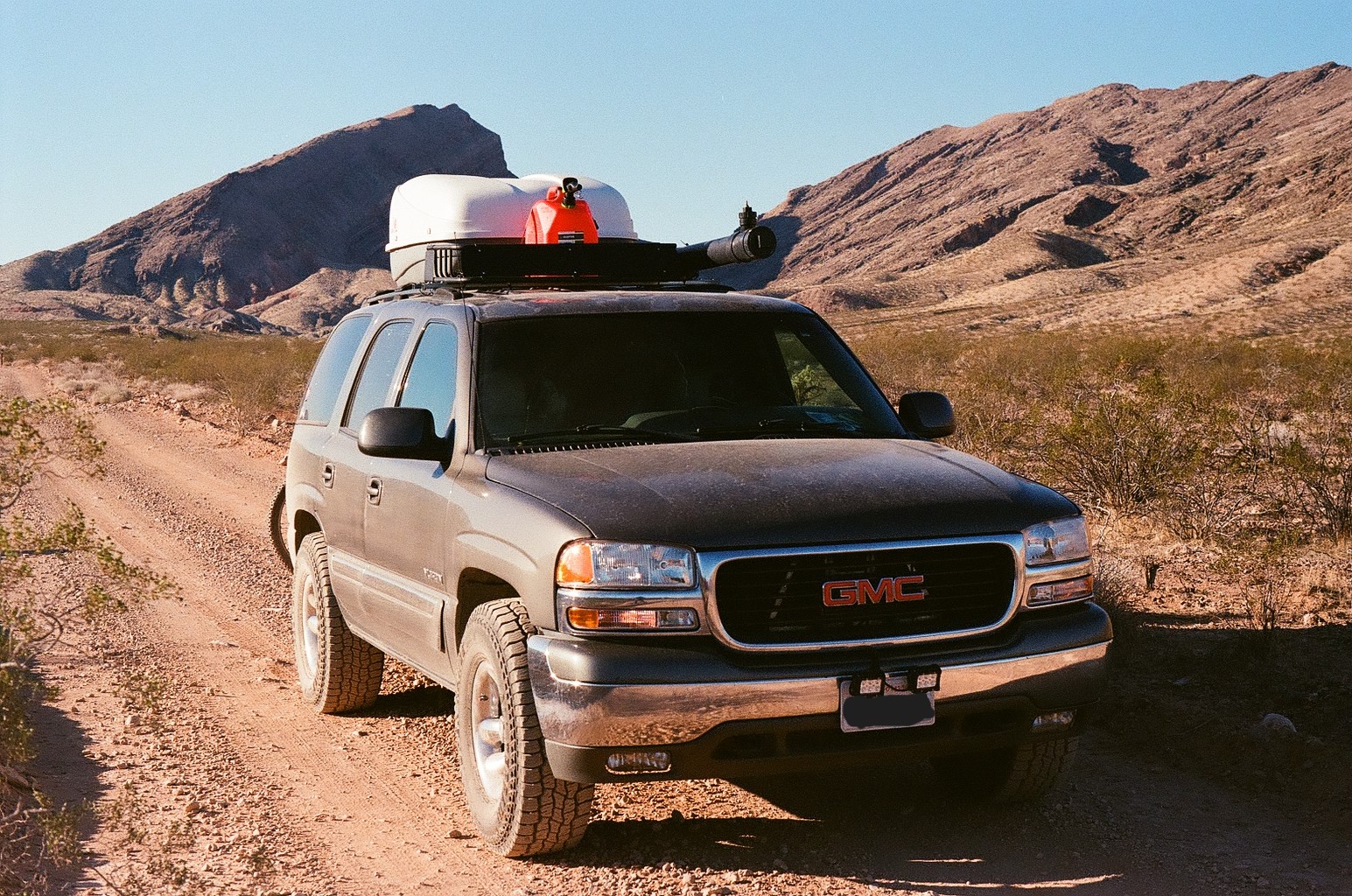

Welcome to the Forum from NH.
Pics of the truck, please.

I'm glad that I asked, lots of good advice here!
