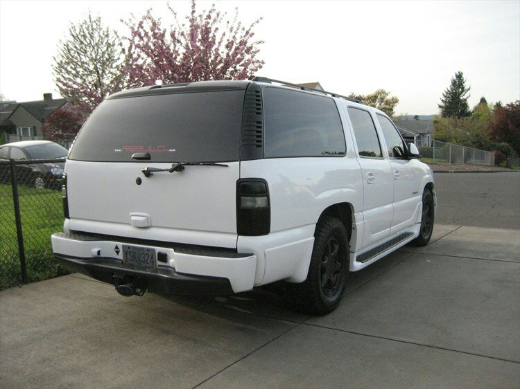

Anyway. On my 2004 Tahoe I need a new hatch glass since the rear defrost tab has broken off. I don't really like the rubber moulding around the glass and like the look on the 2005-2006 rear glass. I know I've seen it on a Yukon for sure. Has the plastic trim on the top of the glass and no rubber moulding around the glass. Question is will this fit on mine without swapping the whole gate for the newer style?
The one that looks like this one..
What I have..

Ooohhhh...so that's what you told the wife, the tab's broken, need new glass! LOL. I personally don't care for the huge rubber piece at the top of the one you're looking at. I also believe you need the third brake light that goes with it. And it has a bigger handle that bolts through the glass as opposed to the molded-in one on yours. You'll need that hardware too if you're buying new. It's not necessarily a newer/older thing either- it was installed on random 00-06 models but seems to be just a hit-or-miss thing. There wasn't an option for it as far as I could find out. I almost bought one from a forum member by mistake, then decided to just fix my tabs.
