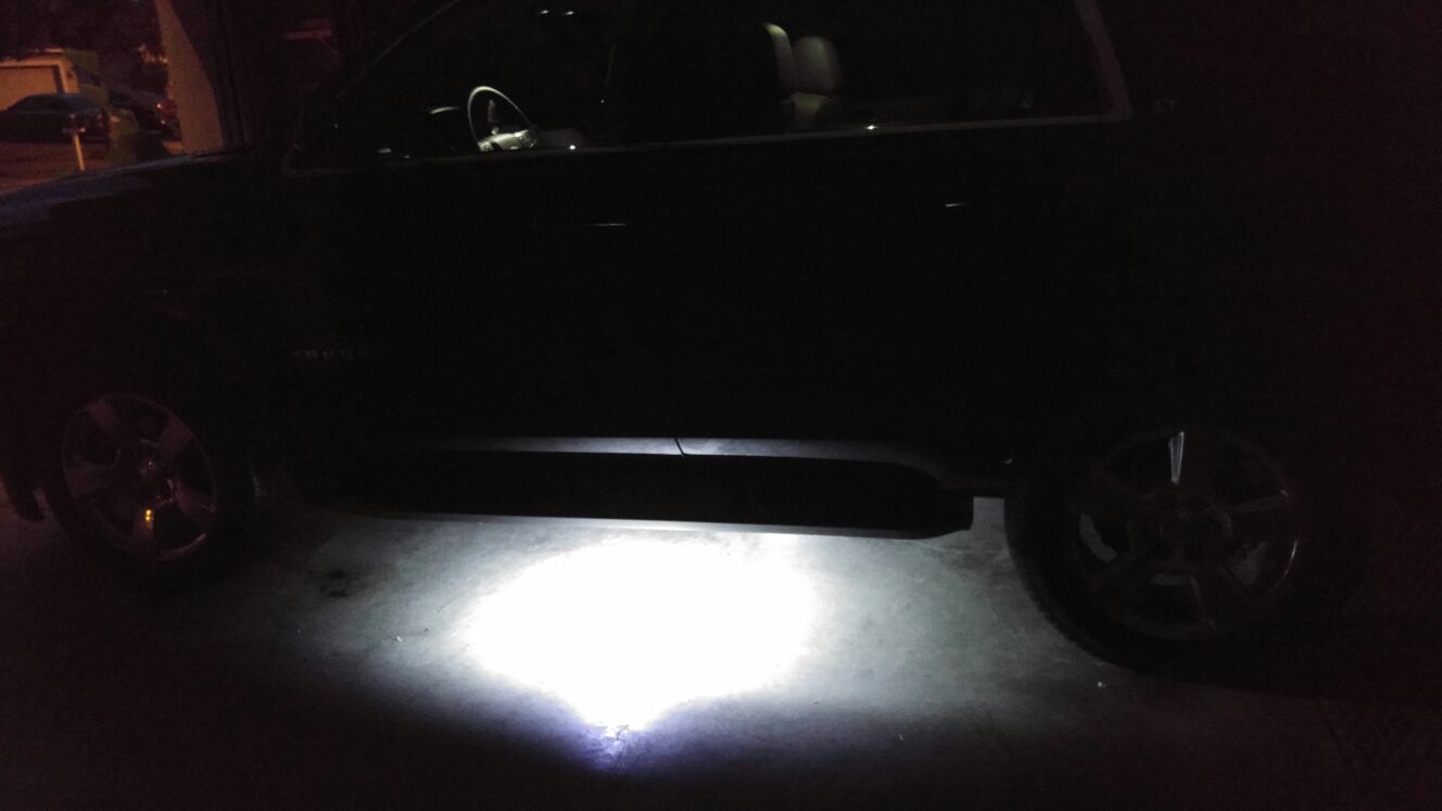

So I just did this mod on my 2015 Tahoe. The lights I used are $10.95 with free shipping. They are rated at 550 lumens. For the price they were worth a shot.
http://m.ebay.com/itm/2pcs-12V-LED-...7-/111777155545?nav=SEARCH&varId=410768035751
I am posting because my truck did not come with puddle lights so I could not use the same wire stated on pin 8 the grey with green line. When I tried that wire the light would just flash but would not stay on. I had to use the solid grey wire which is pin one on the first set of connections under the dash looking left to right. I assume the other would not work due to them not being programmed for puddle lights. The wire I used is for the courtesy lights. Will post after a while to share how they hold up. Mod on.
