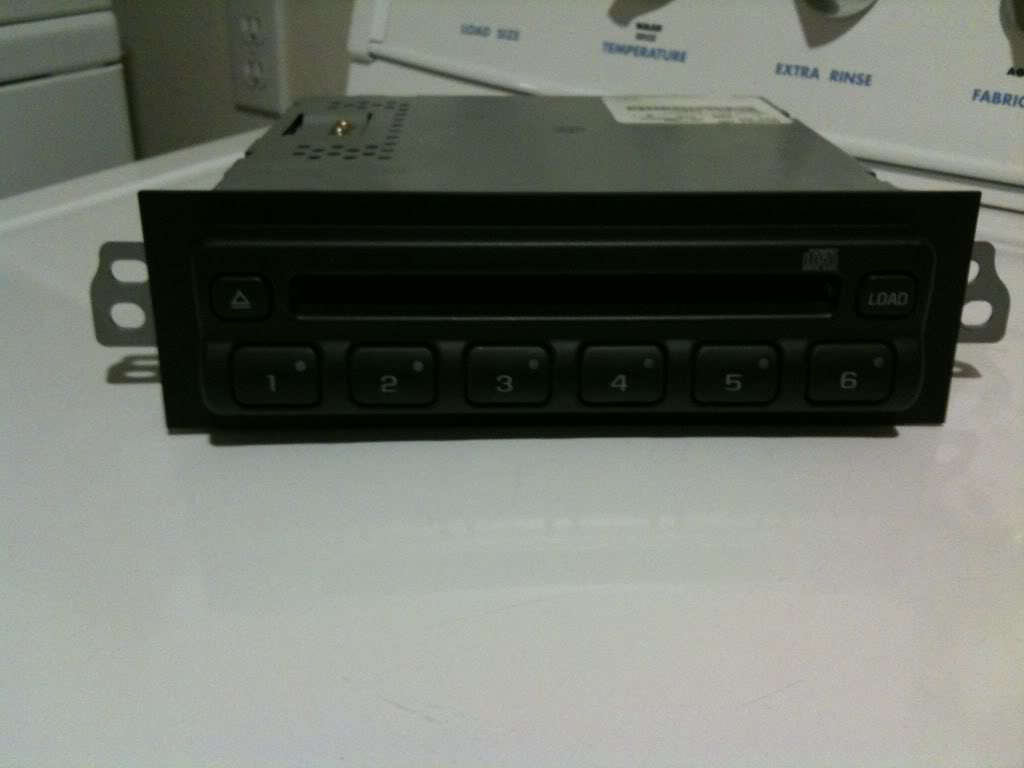

By the way, I have a 6 disc CD slave changer from my 2004 Denali for sale if anyone is interested. No longer need it since I have my indash DVD. See pics below- I will let it go for $150.
