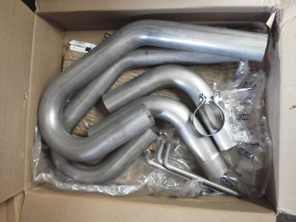

parts
409 stainless exhaust parts

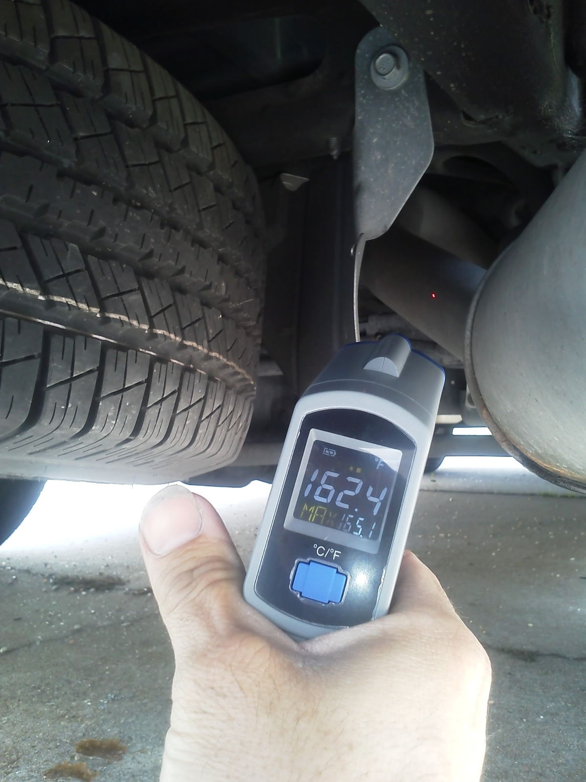

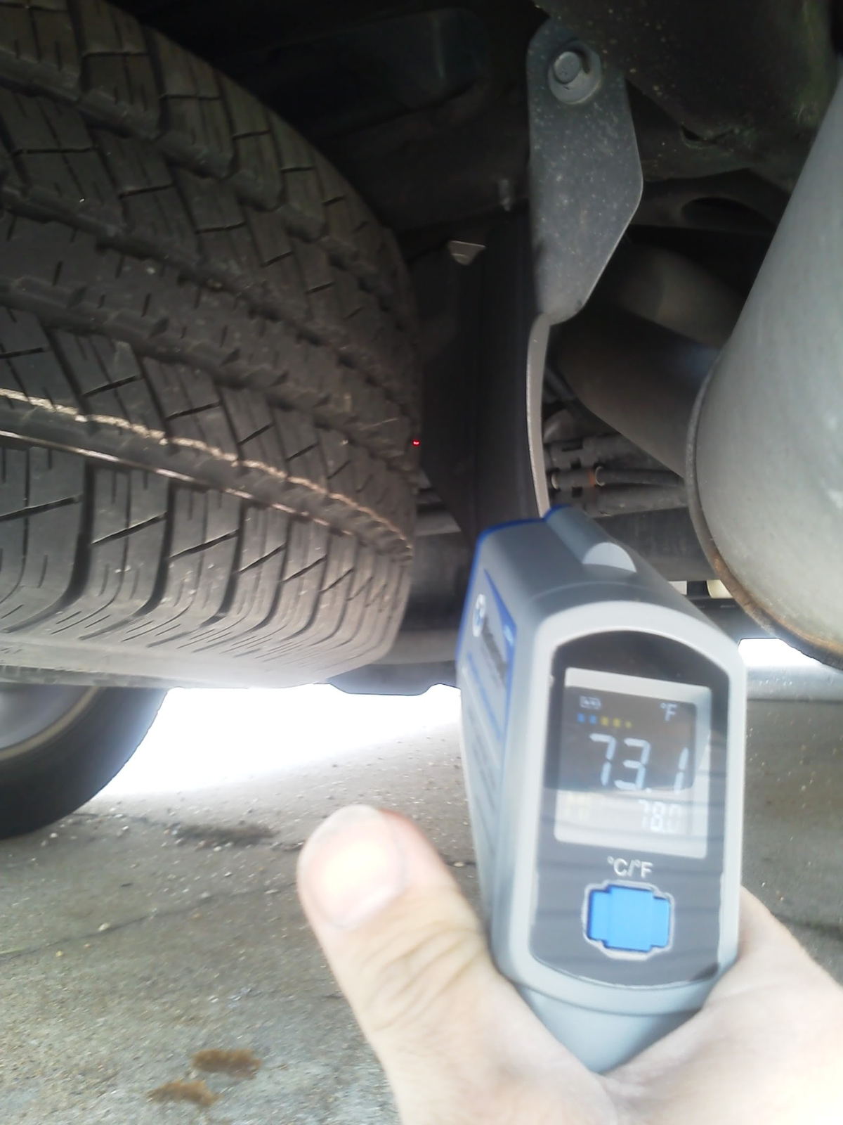

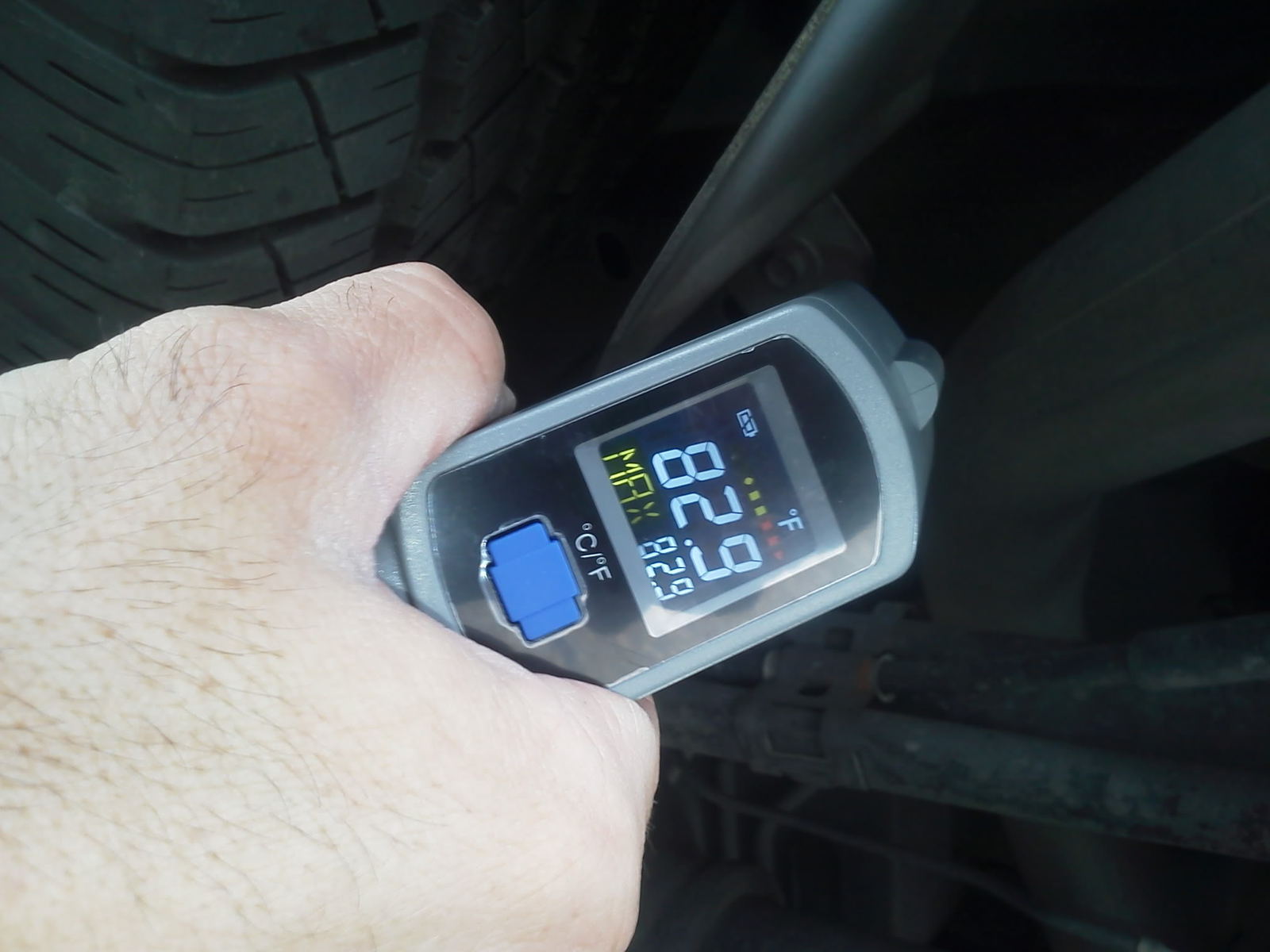

temps around the spare with factory exhaust

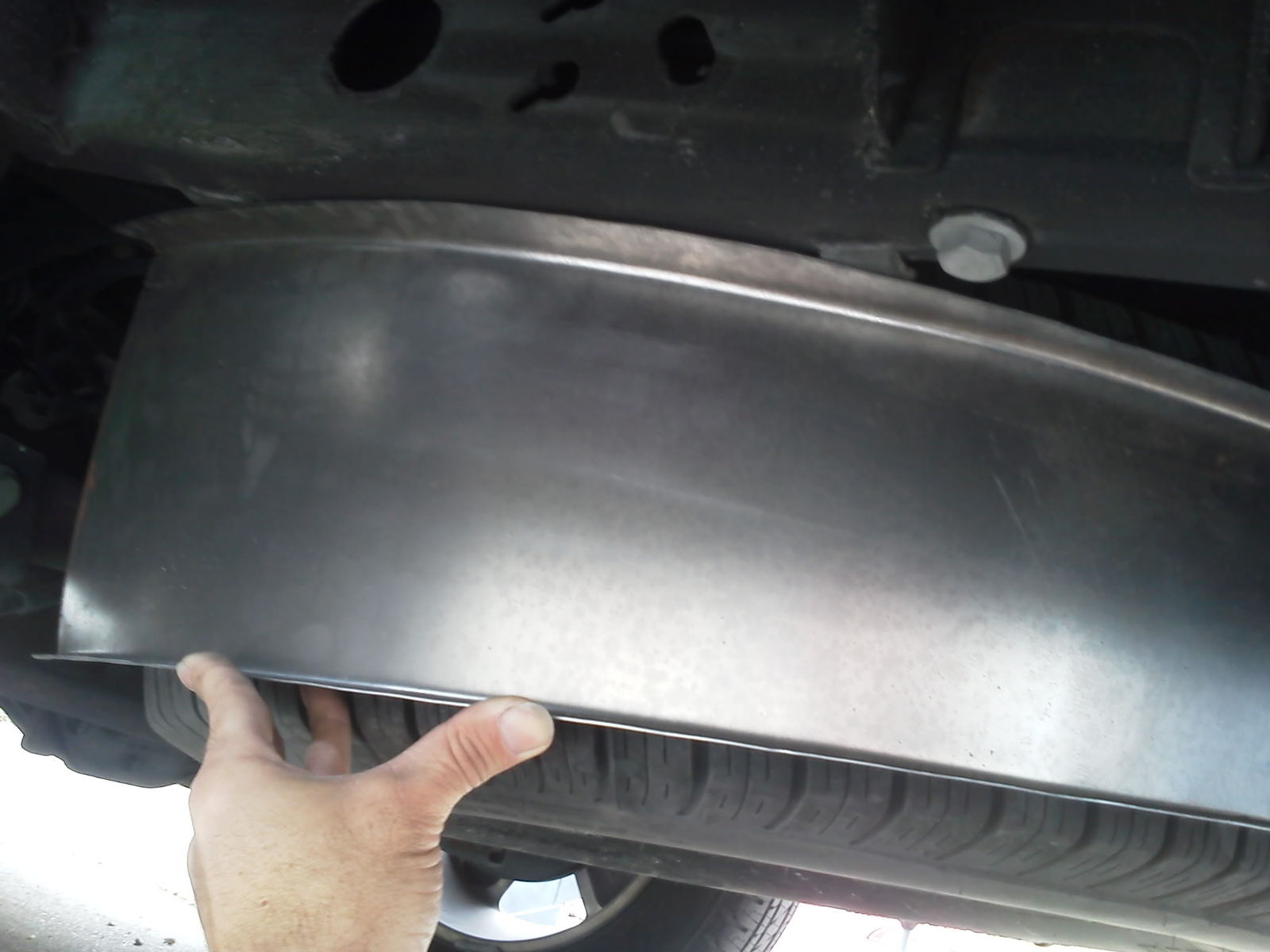

started making a heat shield for the spare but i think im going to wait until the exhaust is finished then decide how i will make one

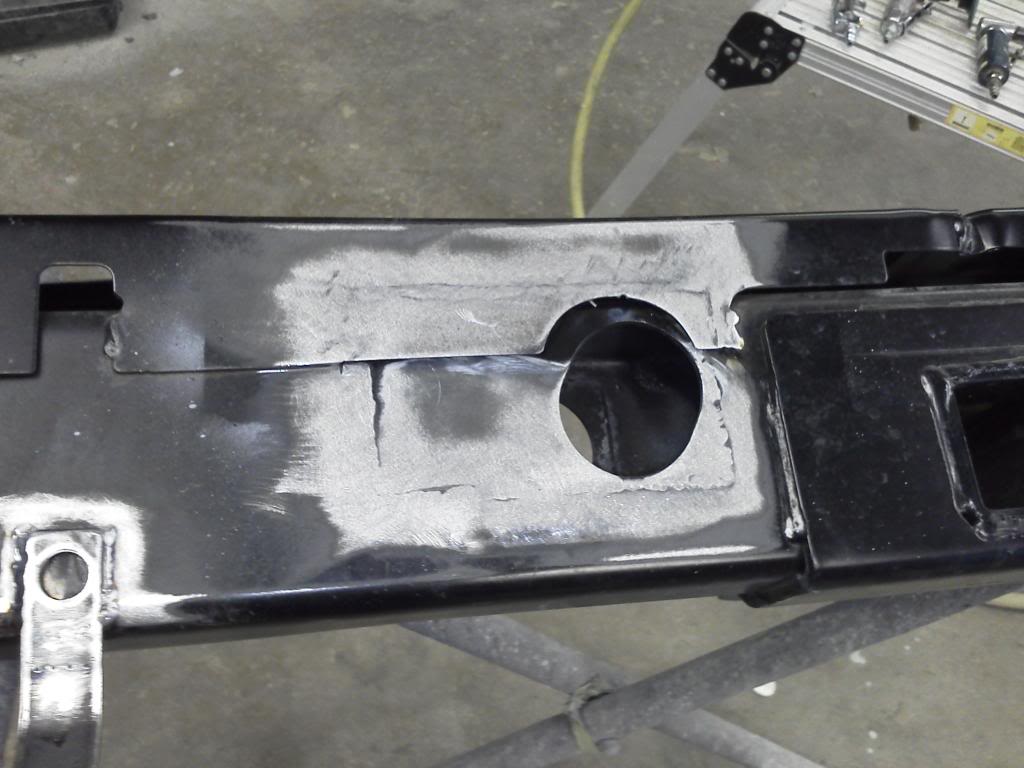

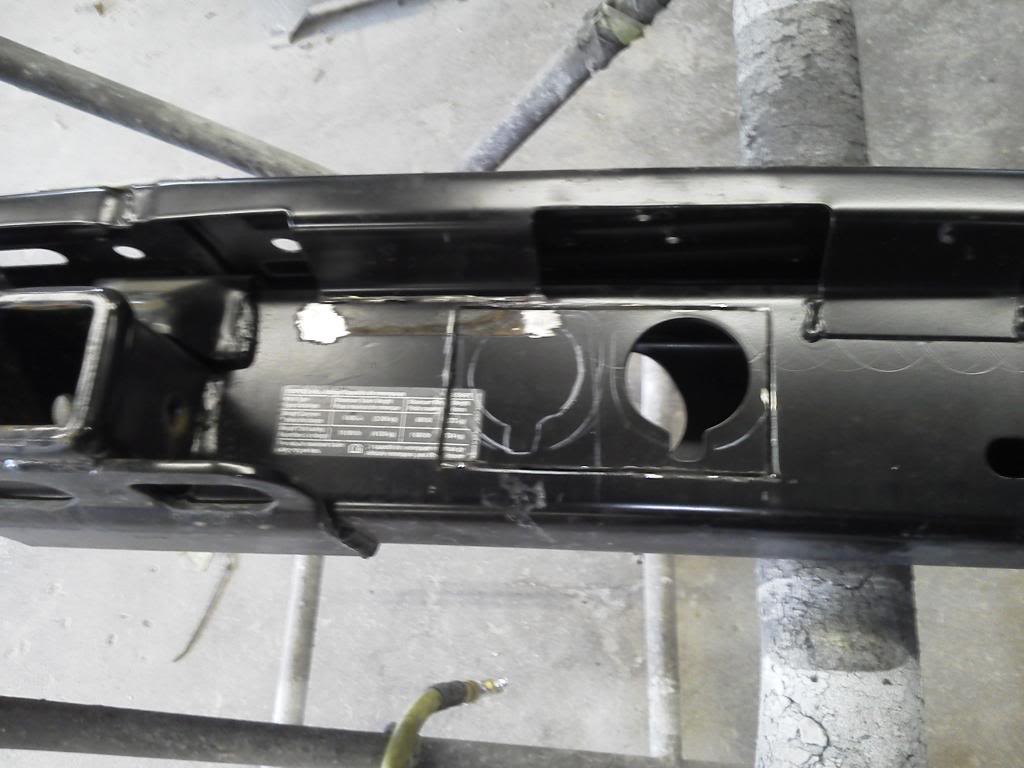

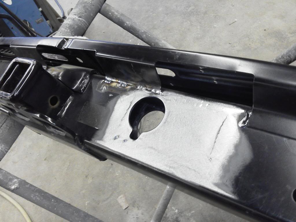

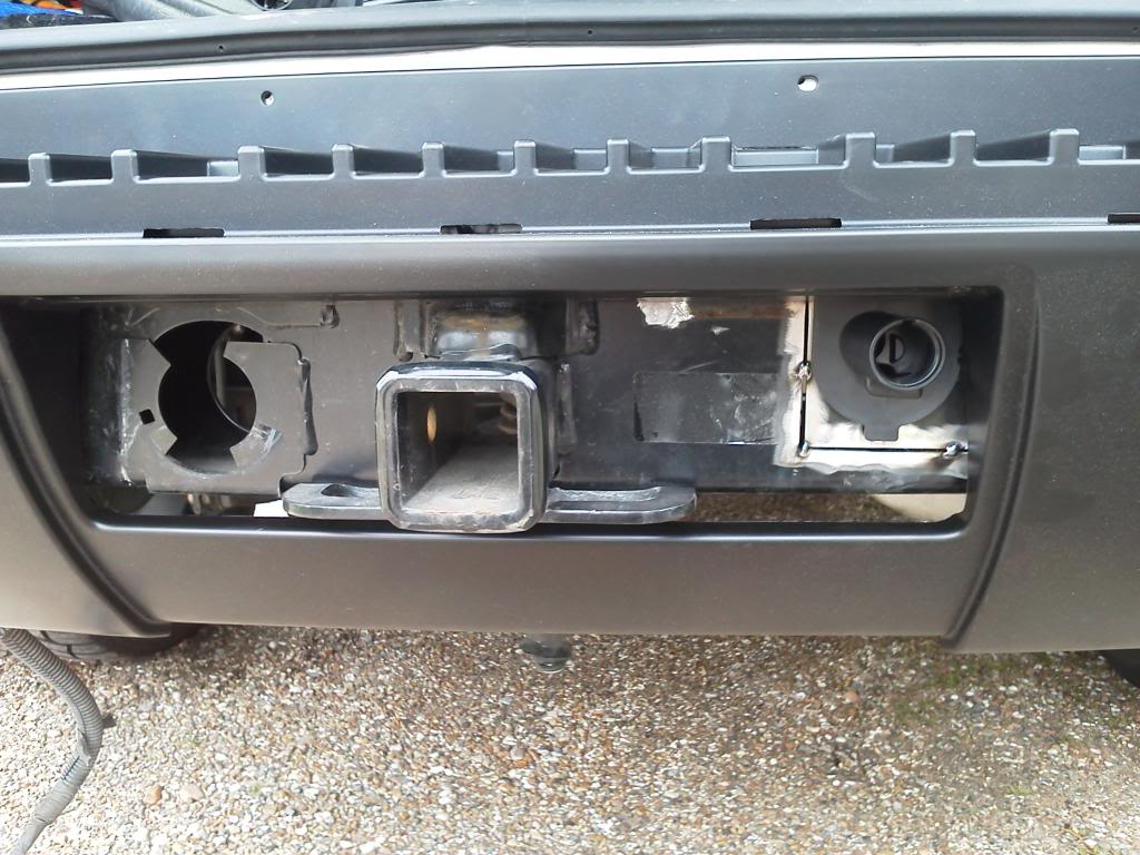

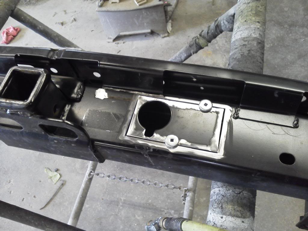

getting ready to flip the cut out for the hoist so that it will be moved over 3' be hind the hit cover
flipped over
test fit
welded up

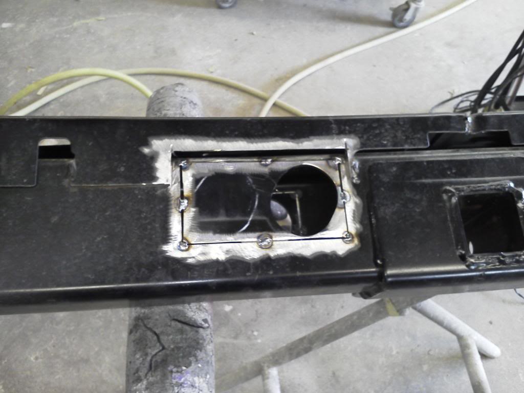

flipped the rear access hole on the reinforcement
welded back up

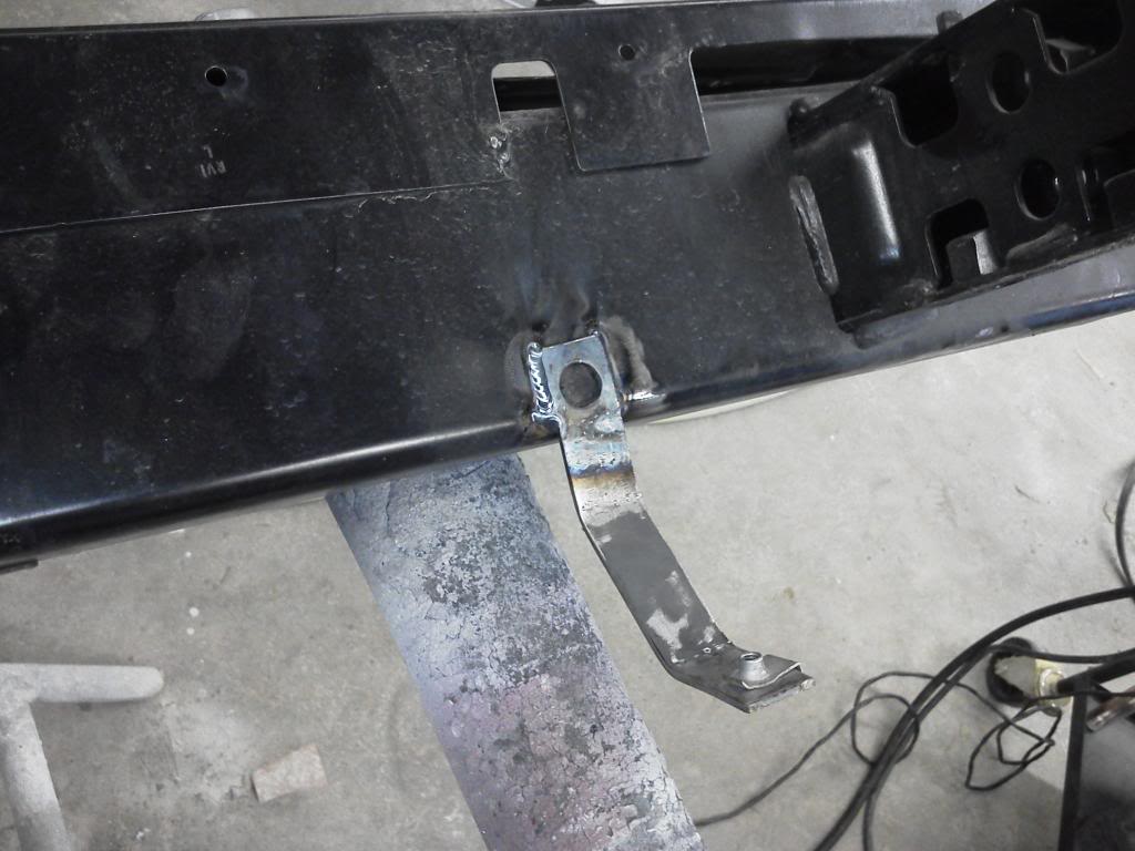

new bottom support bracket for the bumper

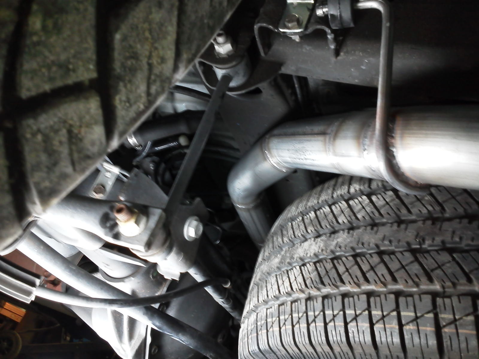

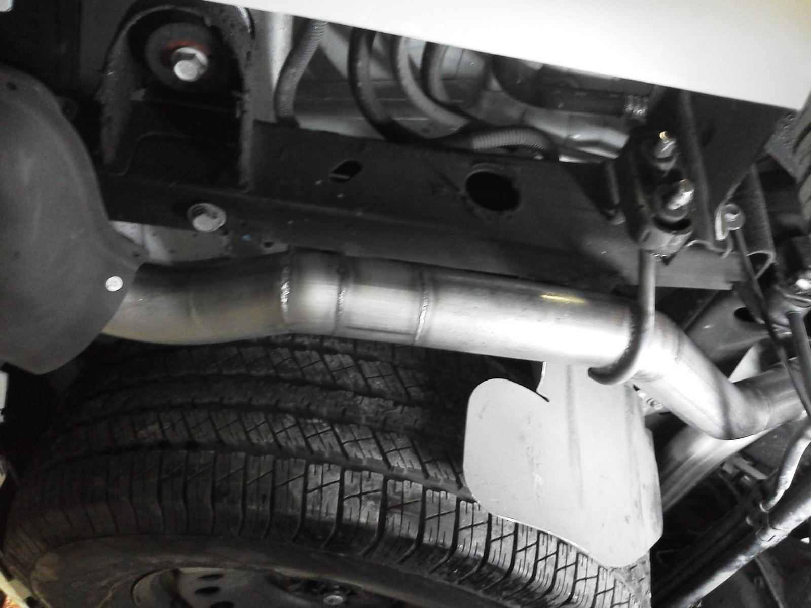

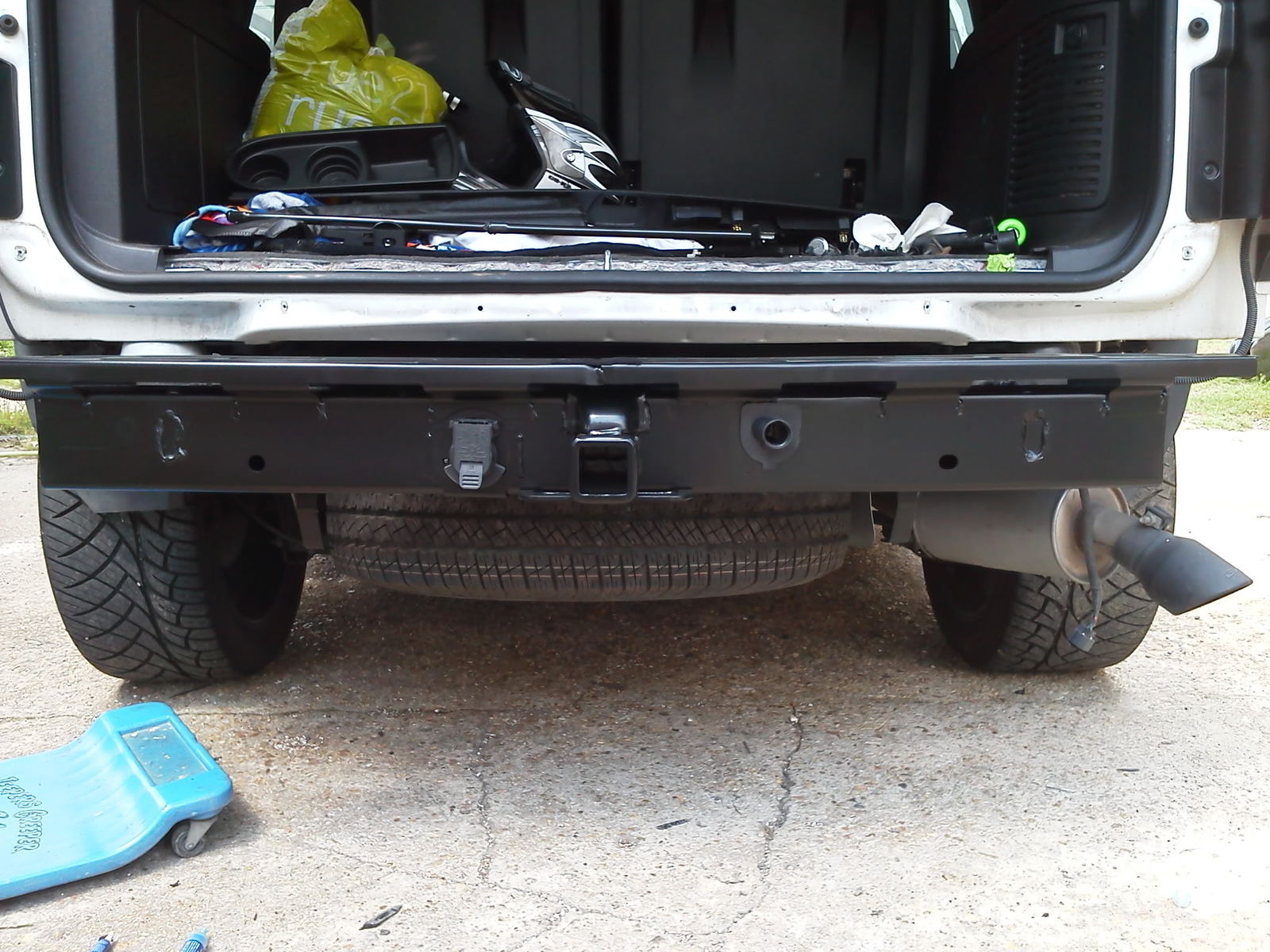

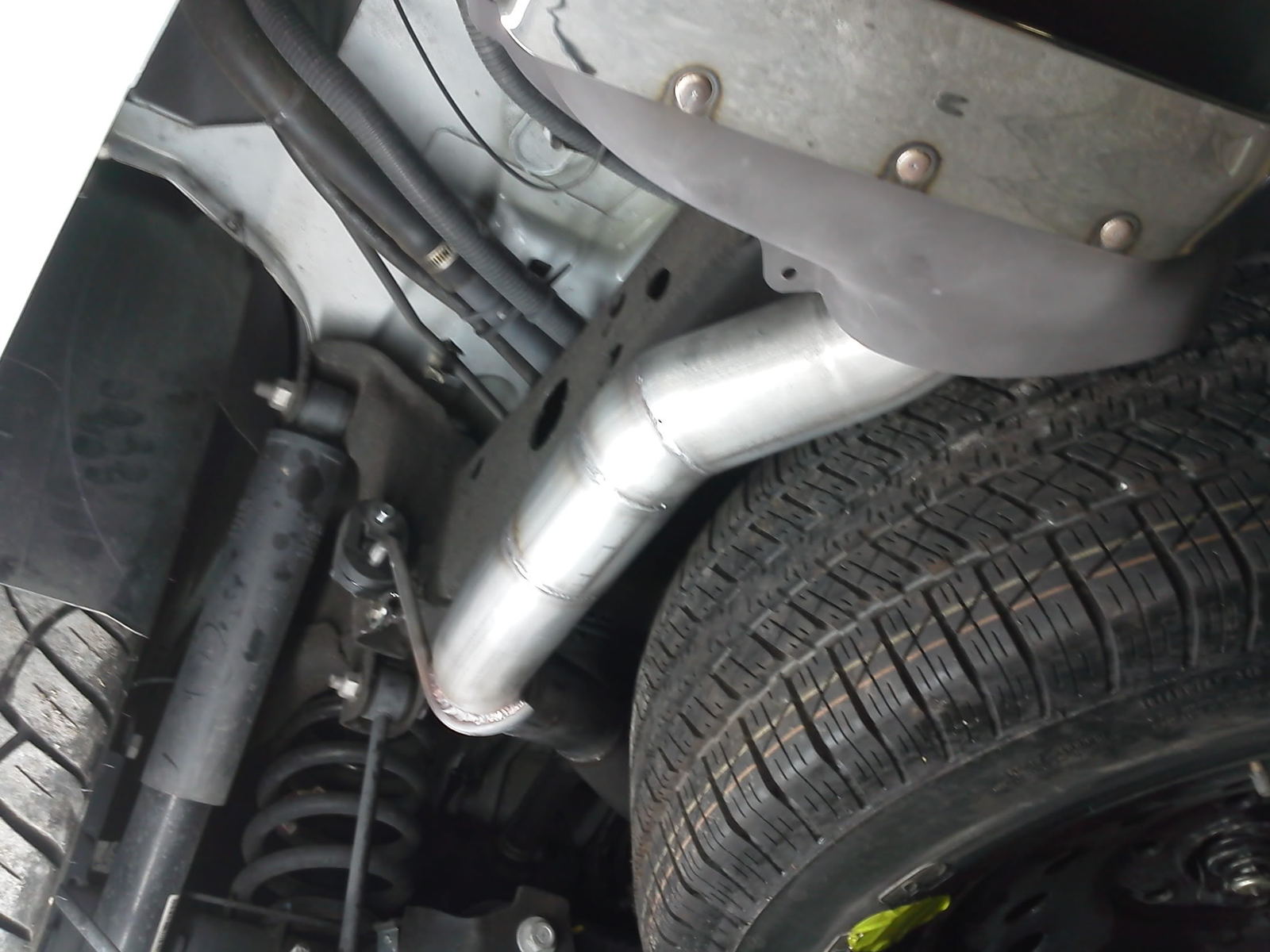

Got busy at the shop but I finally got around to finishing up the install
Reinforcement painted back black
Test fit of the new parts

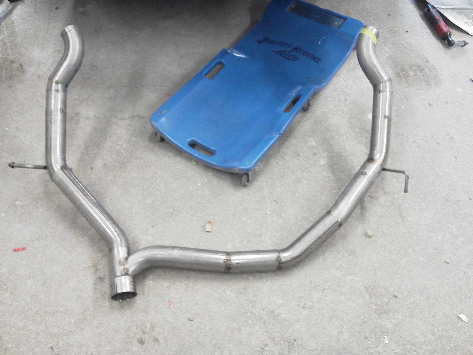

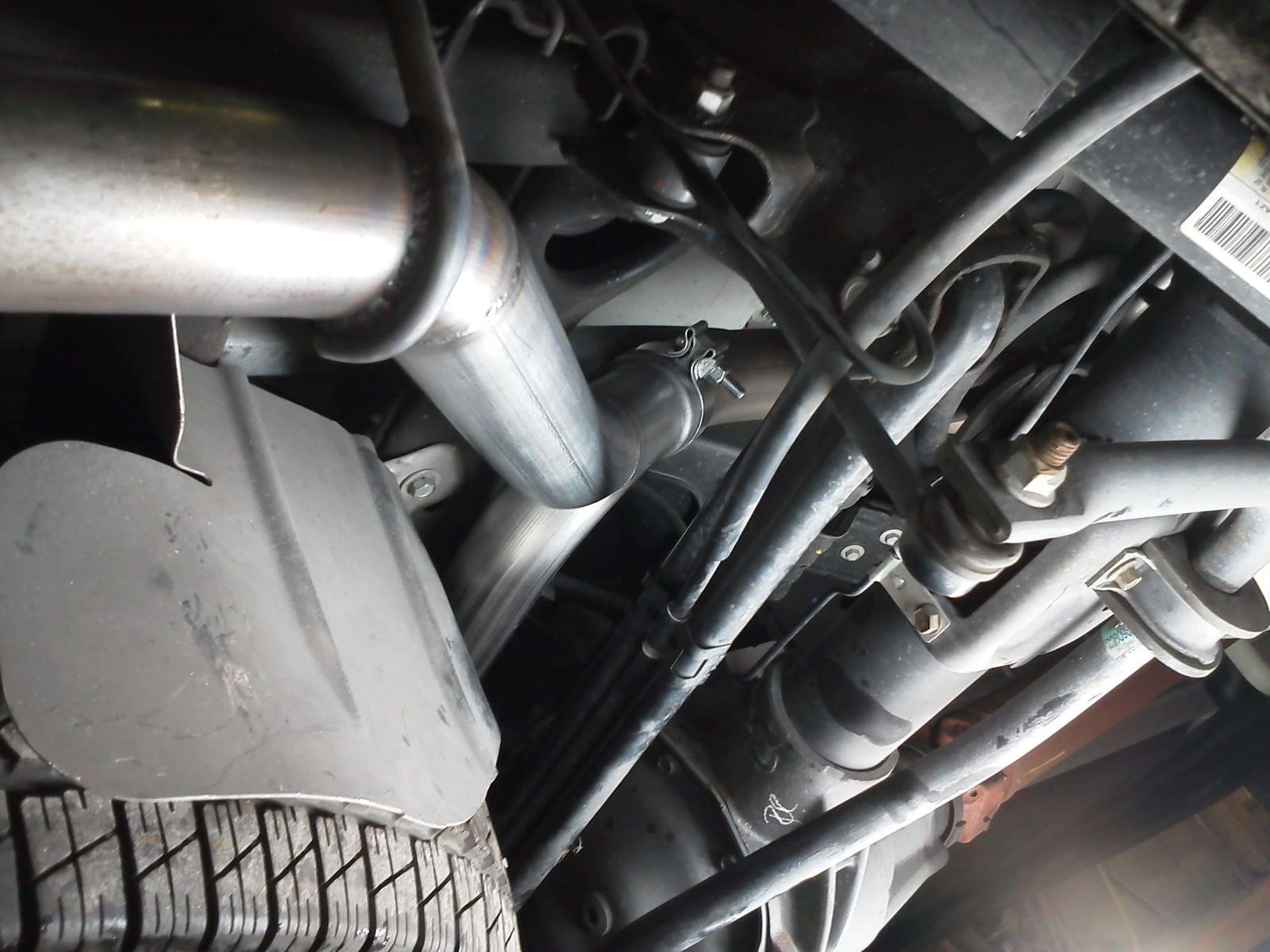

Exhaust tacked together

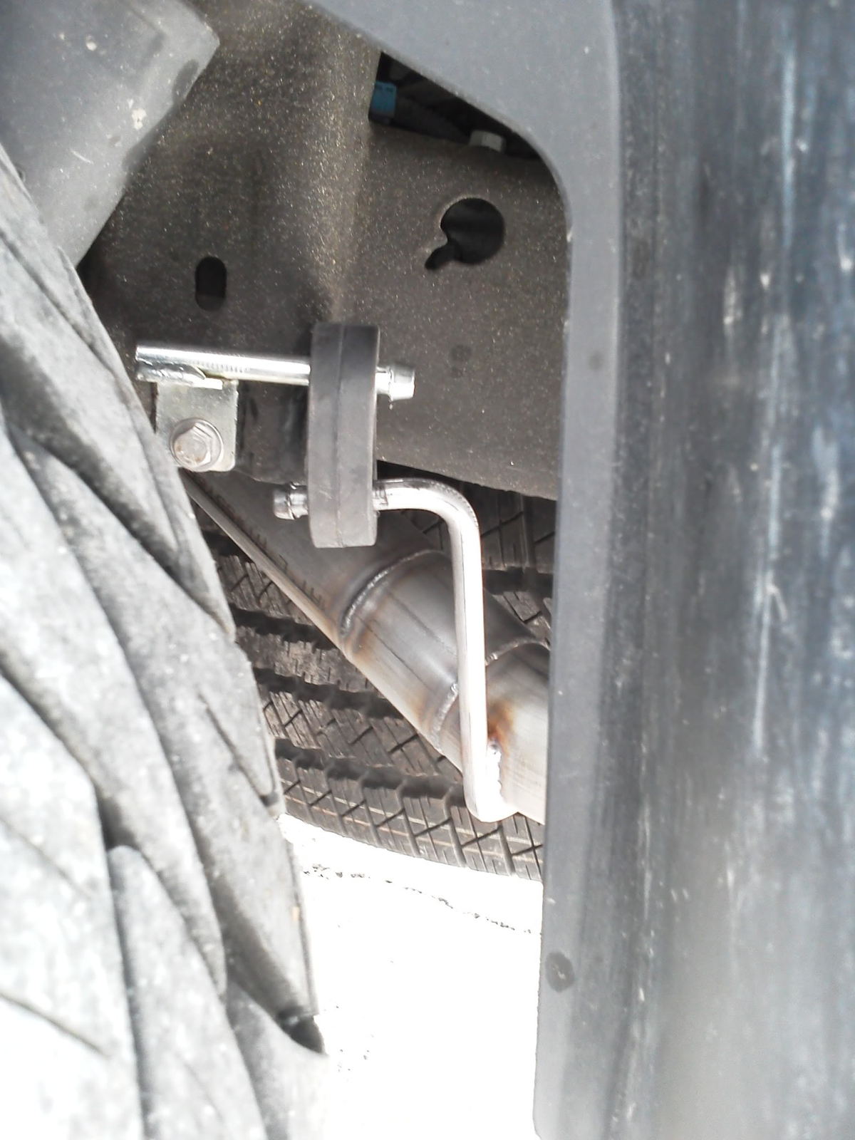

Hanger I added on the driver side

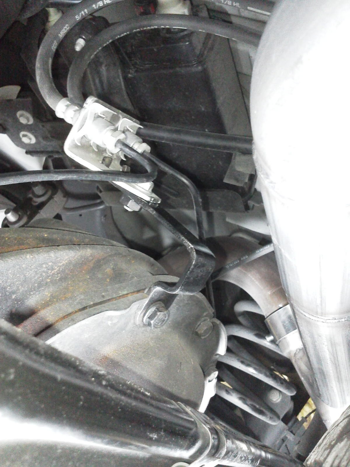

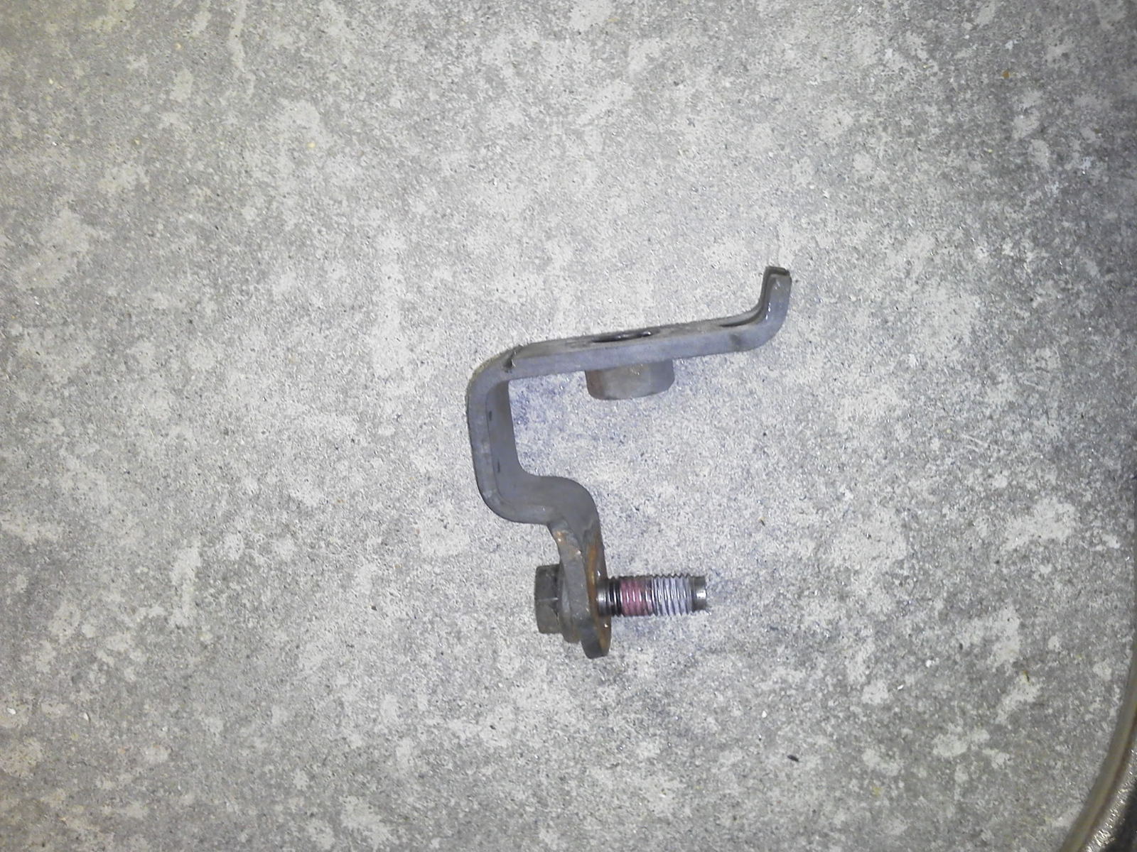

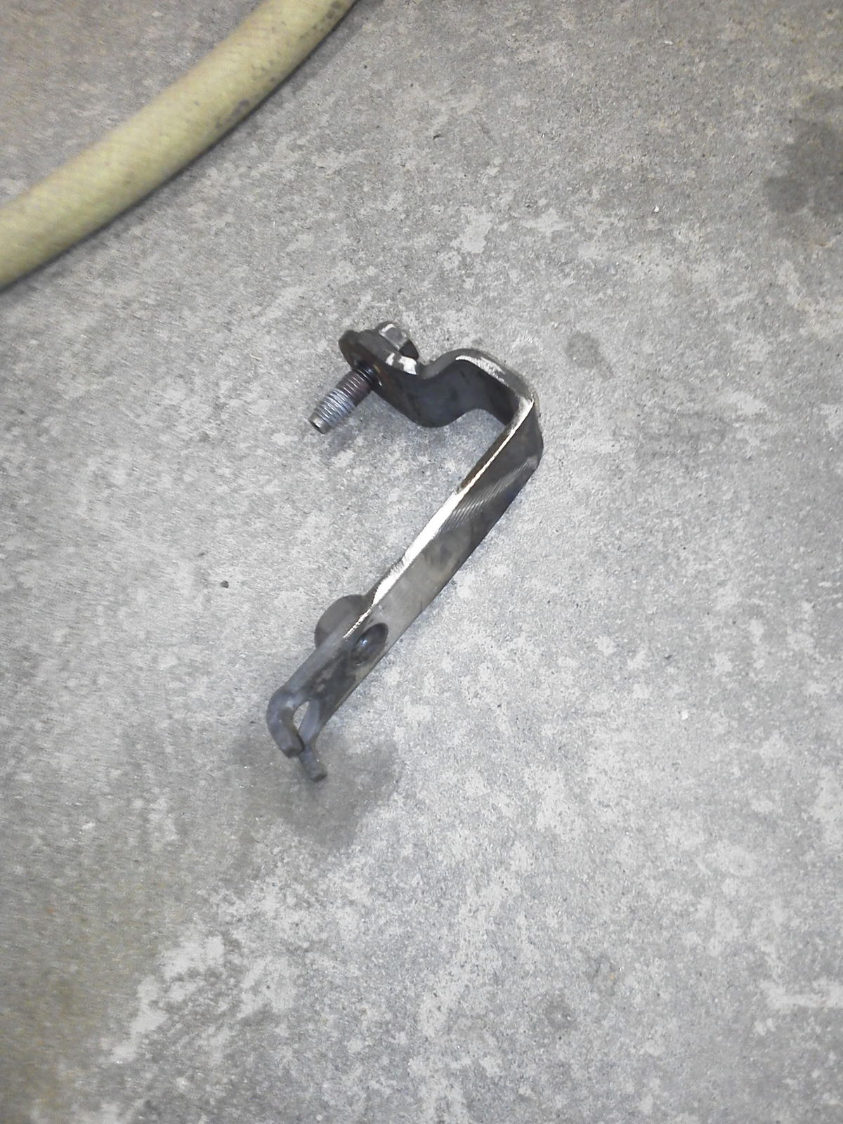

This is the bracket that holds the brake lines on the top of the rear end
I extended the bracket to push the lines forward away from the exhaust pipe that crosses over
Extended Bracket installed

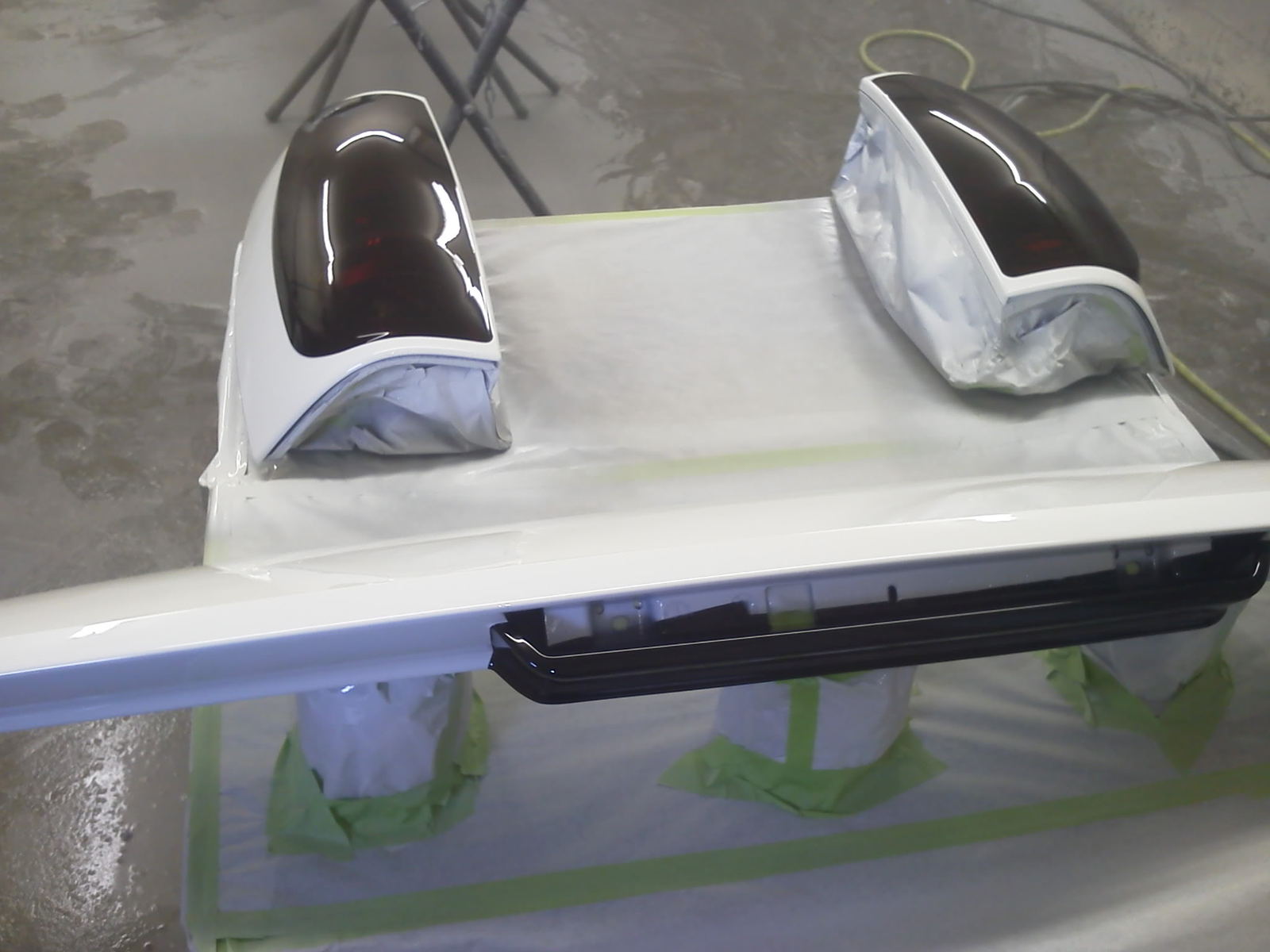

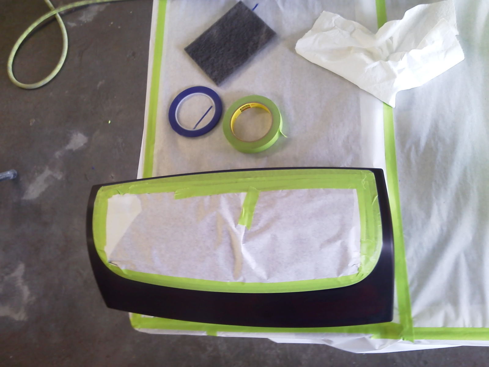

Decided to put a little color around the taillight
Ill get some pics of it completed tomorrow and post some pic of it all done.
I will keep checking the temps of and around the spare as we drive it to see if and where heat shields will go

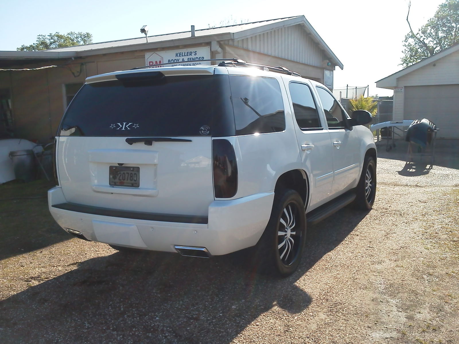

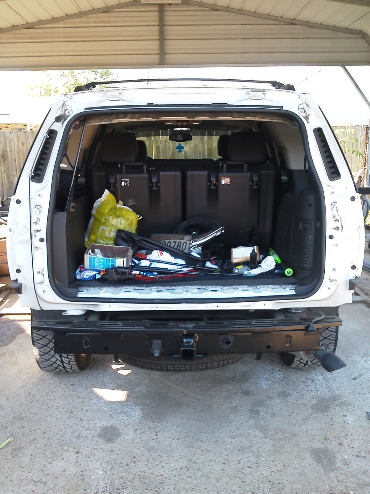

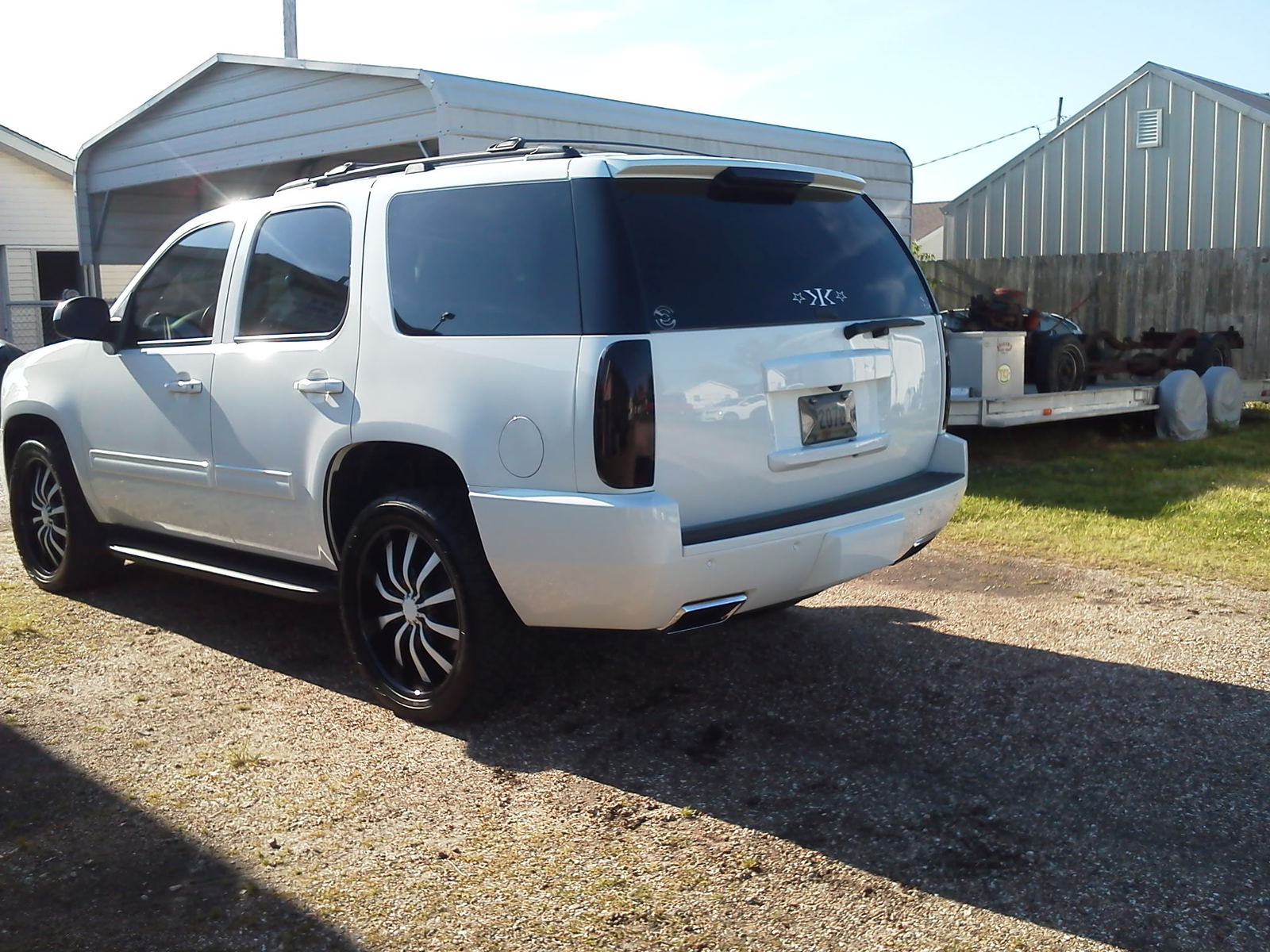

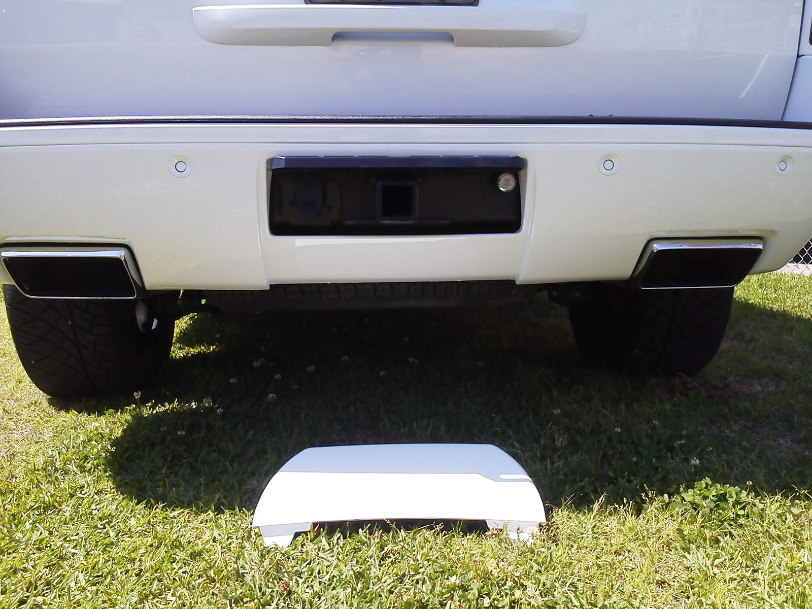

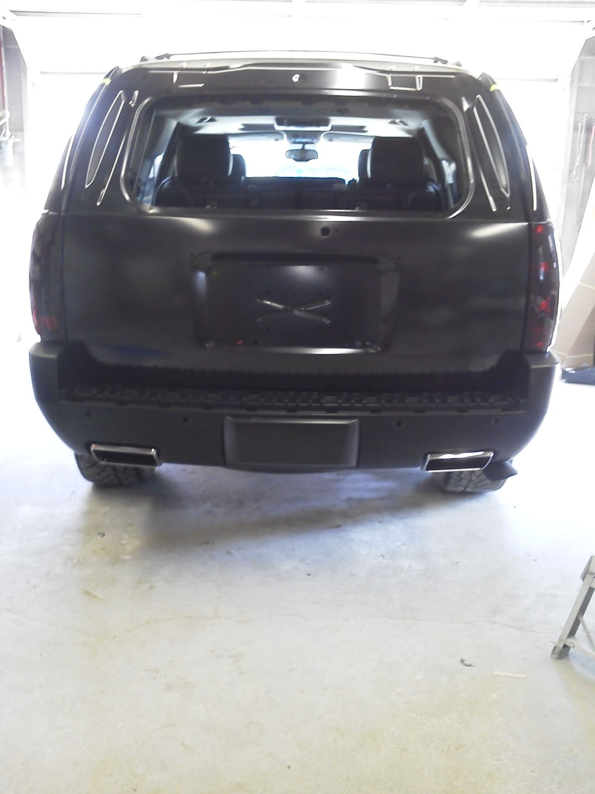

still wanting to wrap the door post in between the two door glasses with some black vinyl but here are some pics of it completed for now
NathanJax
Vacation Nathan
May 9, 2009
49,141
943,577,203
Jax, Fl
Looks good. Need pics with the cover off. Your Yukon has the clean/shaven look to it. Would look good without the side moldings and roof rack
K
KennyK
Mar 18, 2013
62
13
thanks
If I was driving it and not my wife I would take the moldings off
I would be more careful about door dings and I am thinking about doing the escalade/denali roof rack but painted all white

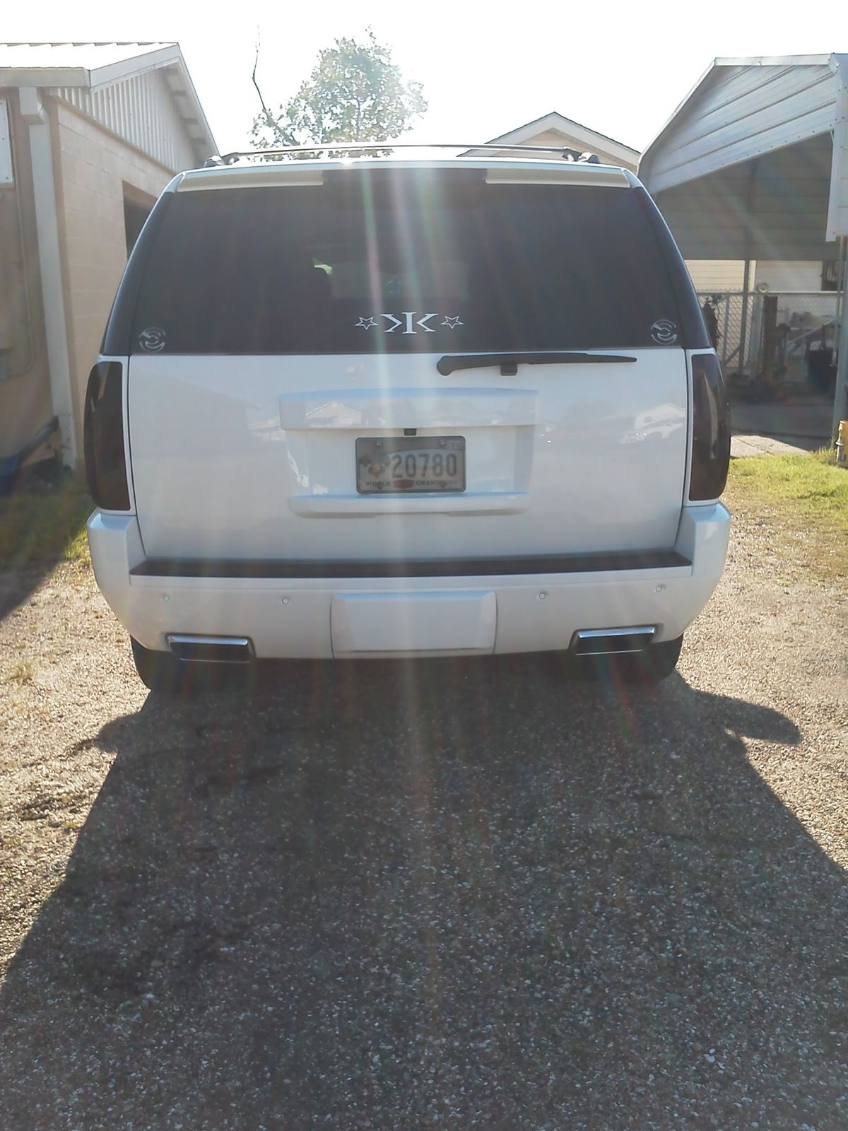

as you requested
992dr
Oct 8, 2009
3,287
1,355
Eastern N.C.
Wow, that looks awesome.
Did you do the exhaust work yourself?
Looks like a quality job, well done.
