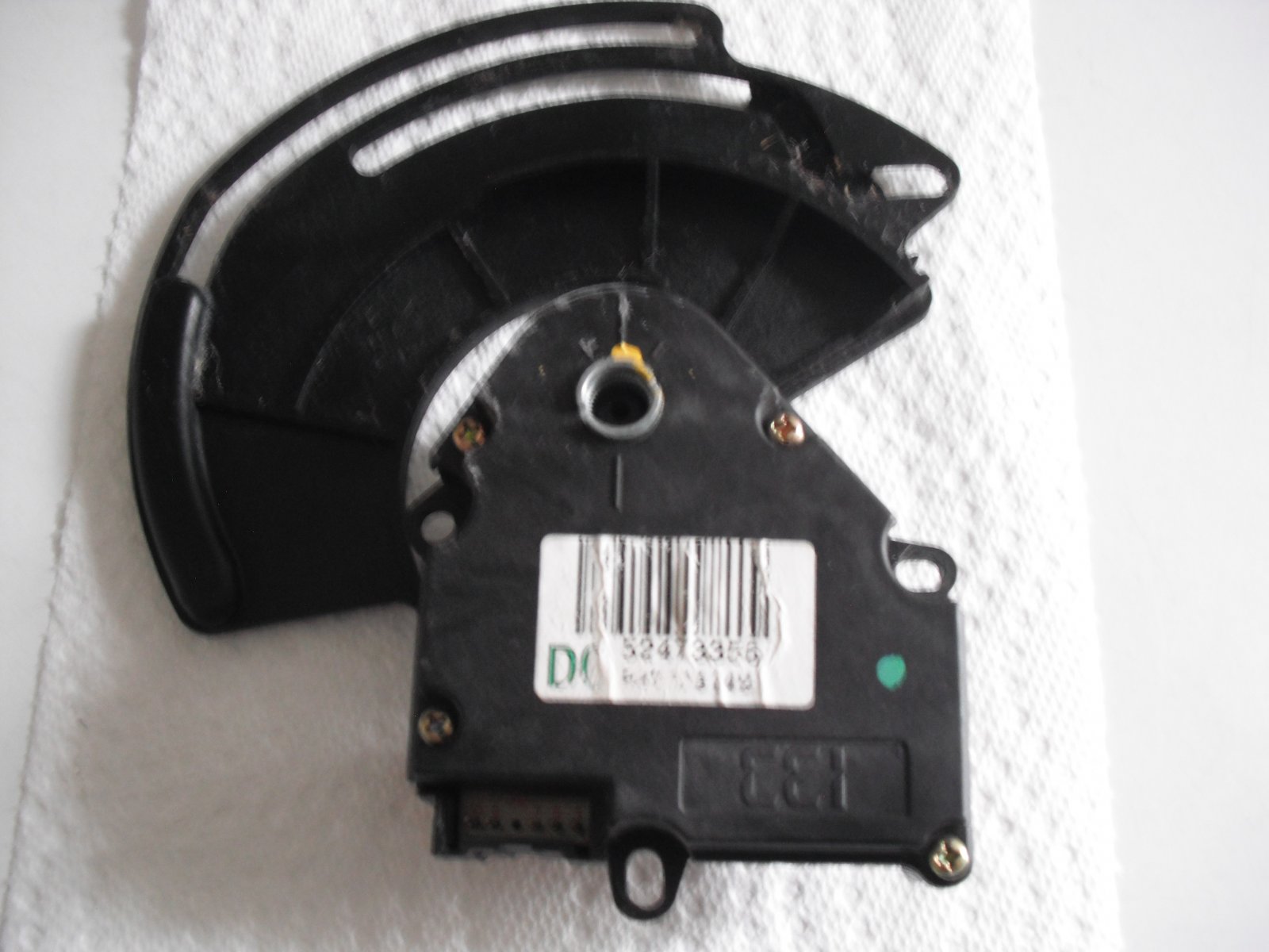

My '00 Yukon Heat was stuck on defrost.DSCF3733.JPG Make sure you remove the correct actuator located on the left side of the heater box. DSCF3735.JPG
