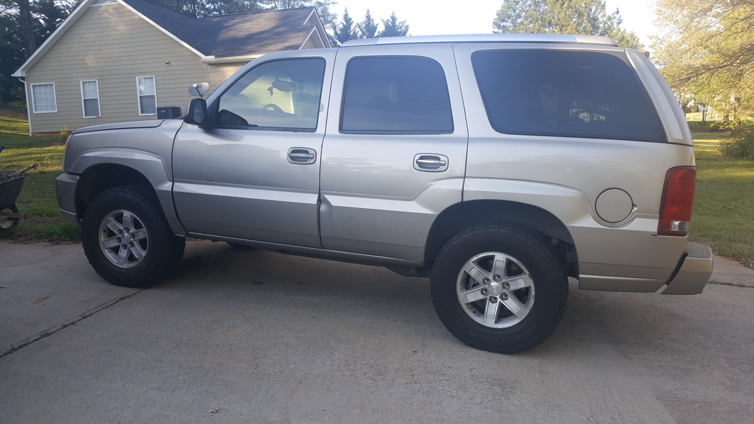

Lifting a 2002 Yukon Denali
TheAutumnWind
Jan 8, 2015
3,222
1,919
  • Tire & Wheel Combinations
  • 32" x 11.50" w/16 or 17 x 8 and 4.5" back spacing
  • 33" x 12.50" w/18 x 9 and 5" back spacing
  • 33" x 12.50" w/20 x 9 and 5.75" back spacing
    *Trimming may be required*

I'm running a 33" tire with just keys up front. There's no way a full 4.5" kit wouldn't allow for a 35" tire.

Hate to be the bearer of bad news but these trucks rub 35's with a 6in lift but it's only when they're almost to full lock turning to the left. But it still rubs pretty harsh.

If you stay relatively conservative on offset, it would be fine.
People are wanting a -76 offset 12" wide wheel to fit but don't take into consideration how far out they stick.
I'll be running a custom front bumper and I'm not afraid to use a grinder if need be to make 35s fit when I go to a 4.5" kit. There is no point in going up any higher if I can fit a 33" tire as it sits.

I had Moto metal 18 x 9 with zero offset with 35x12.50 open country m/t's and they rubbed with a 6in lift.
I heated up and remolded the front to clear the bumber and also still rubbed the fenders before full lock.
I now ride 9in lift with keys on 37's and have no problems even off road!
