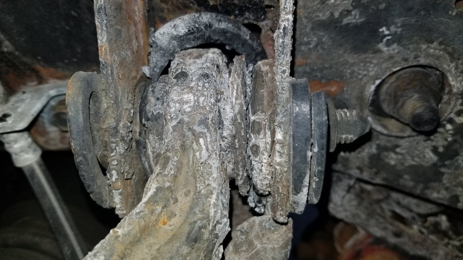

Looks like has been submerged in salt brine for quite a while.
Just 18 salty New England winters...
I got it in October and have signed up for the unlimited car washes.
That coating of salt was just a month's accumulation before I got the car wash pass.
I'll be crawling around this summer to at least get some Rust-o-leum or P.O.R. on there.
Control arms will get changed out before winter this year.

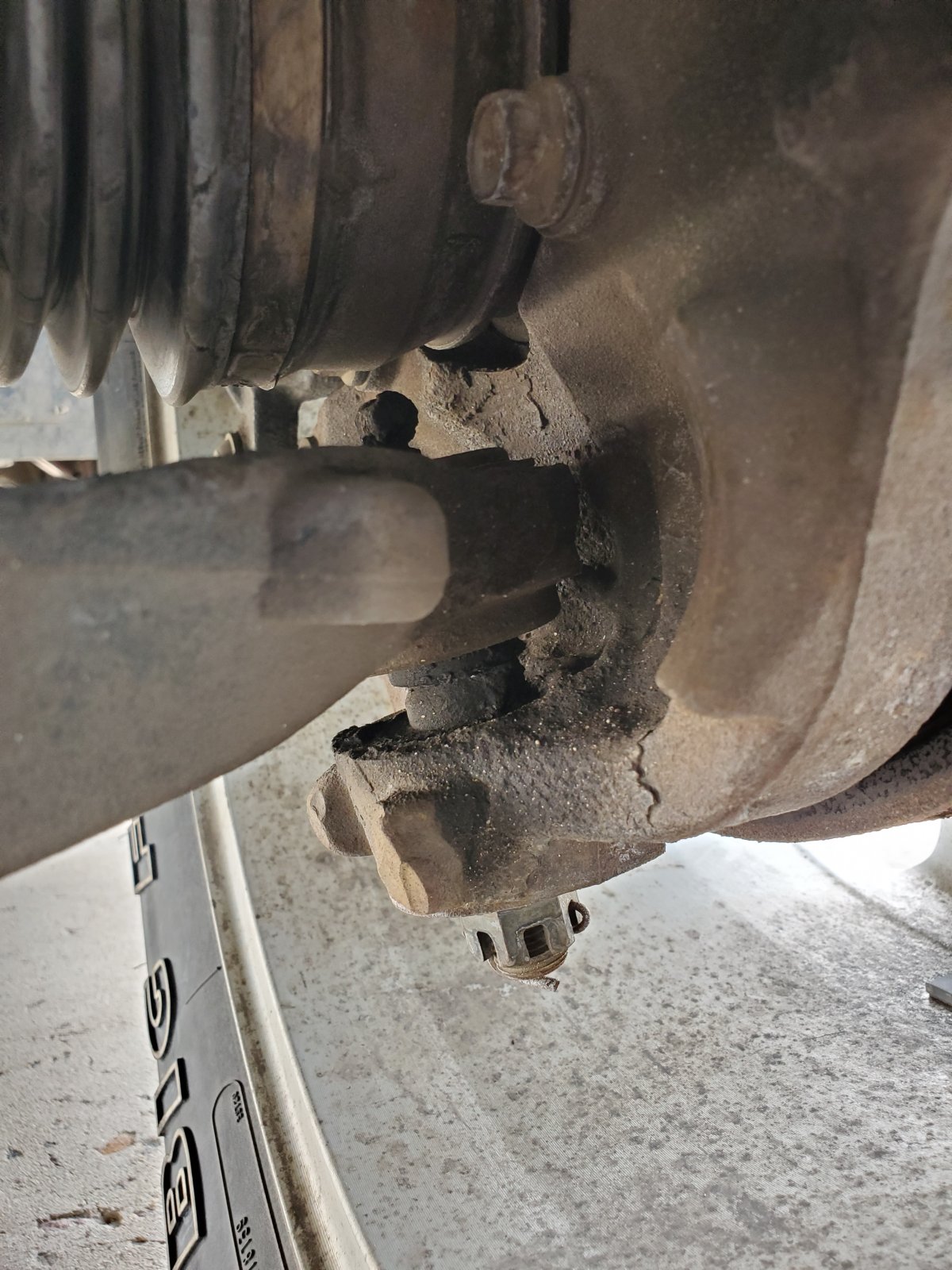

The K6541 is good; it's in the MOOG Problem Solver line. Here's what mine looks like after a few years. Don't mind the random road grime.
