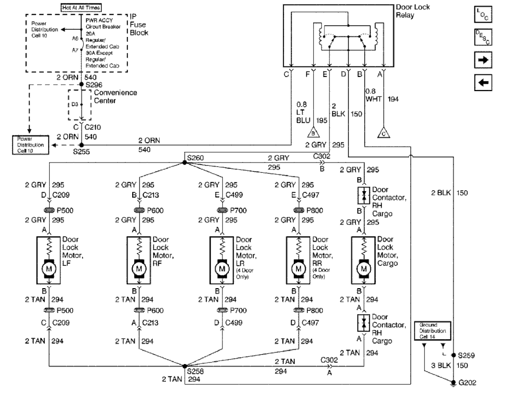

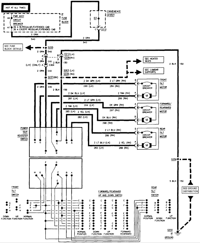

So, I have a problem. Keyless entry and everything worked fine then got home and now it won't work, dome lights won't come on when the door opens, my power seat won't work and the door lock switches won't work! When I push the door lock switch inside, all the interior dome and courtesy lights come on! I dunno what the hell coulda happened during my drive to cause this.... My windows also still work fine. The only thing I did before this happened was had raised my steering wheel all the way up and moved my power seat all the way back. Then put it back to normal and all this stuff happened! Could there be a wire somewhere that got pinched when I raised the steering wheel?
