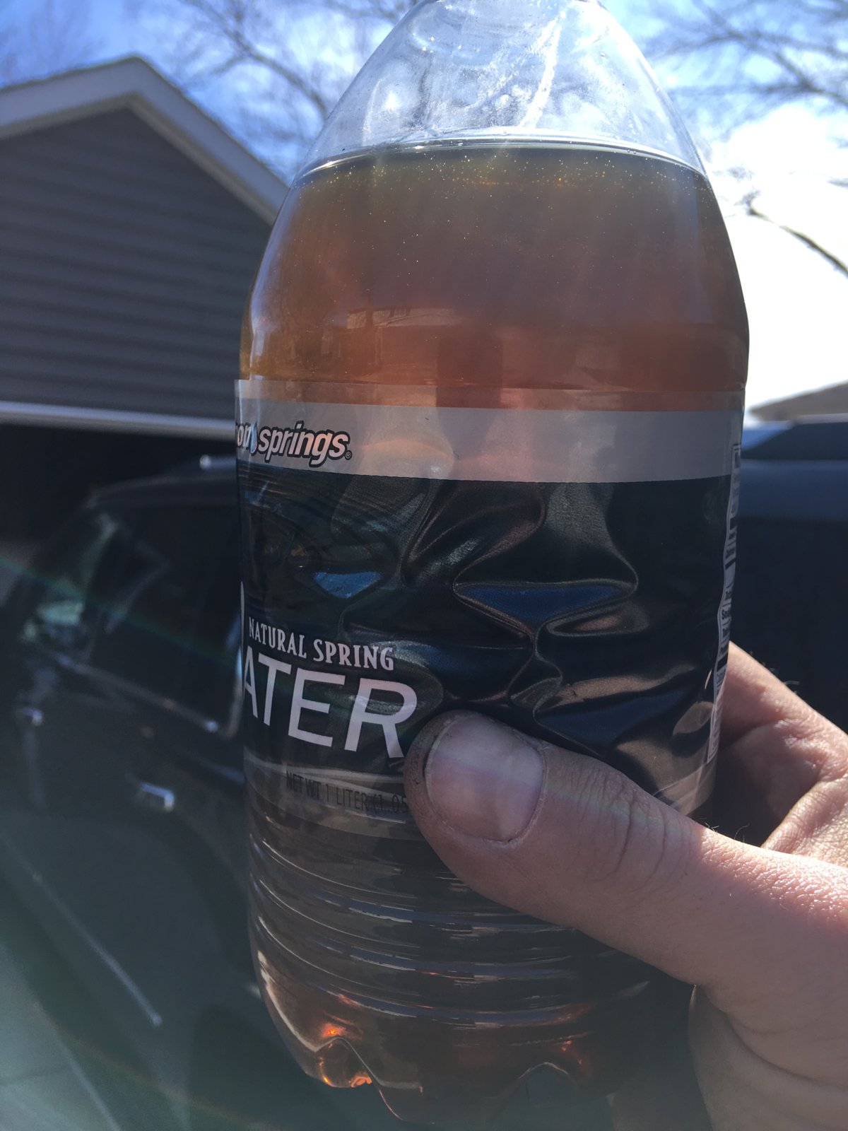

Hello all
I’m **** about routine maintenance with all my cars. Just flushed the brake fluid from all 4 calipers this morning.
The pedal feels more firm and I was surprised. Normally I can’t tell, so there’s proof it was a good time to do it.
51k on my 2015 Yukon. Manual states to do this service at 45k or 3 years, whichever comes first.
Brake fluid is typically clear, unless you’re using specialty stuff like ATE Blue.... here is what came out, glad I did it.

Dumb question. What does it get dirty? It’s a closed system isn’t it?
SuperOldSchool
SuperOldSchool
Feb 16, 2015
150
145
The fluid breaks down from heat. Brakes get Hot!
Plus, I think air does deep from the reservior cap- minute amount over time.

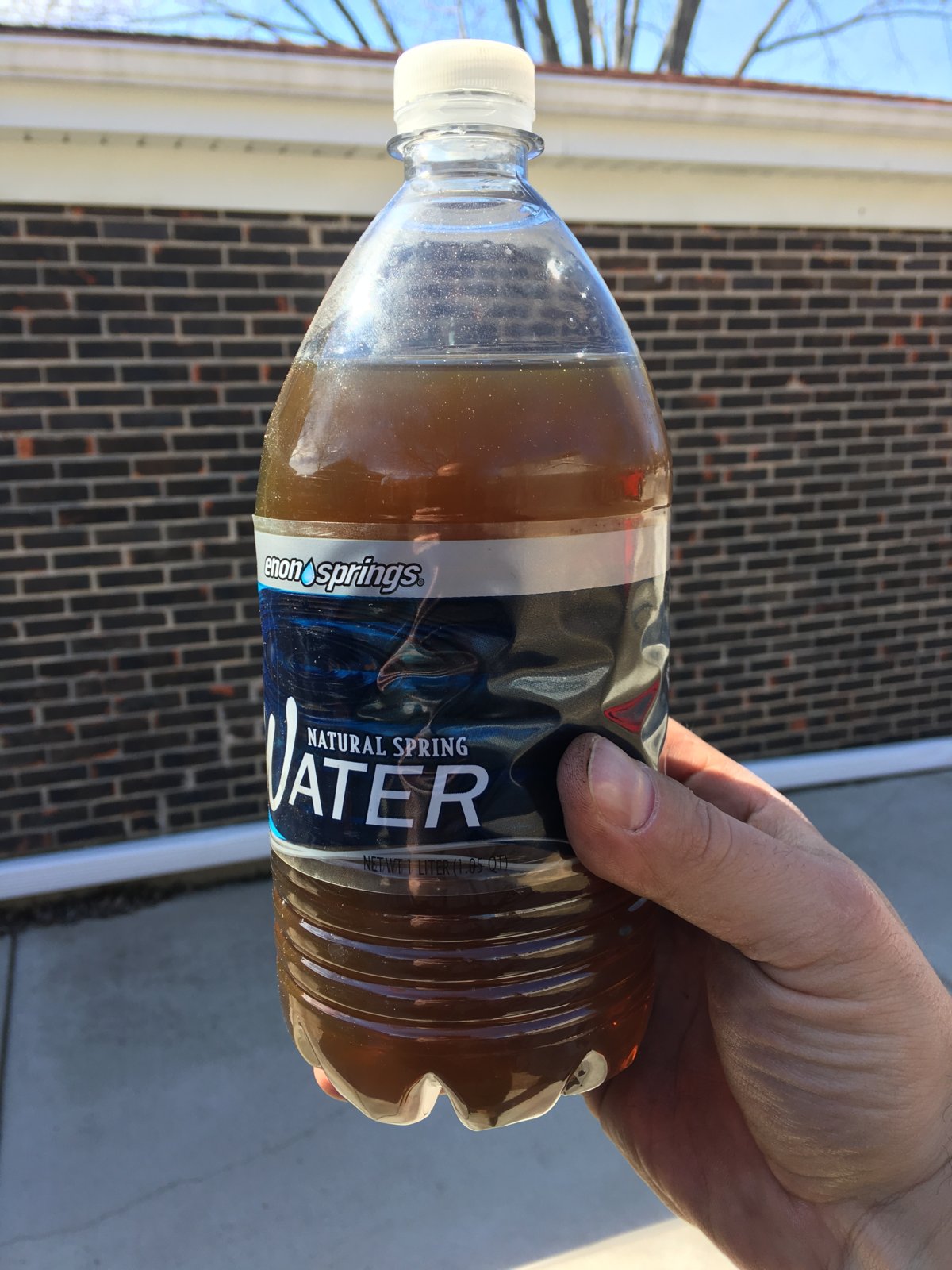

OP here with update.
It’s almost exactly 1 year since the first full system flush. Now at 70k and I put new rear rotors and pads on, flushed again on rear calipers:
Fluid gets dirty quickly.
I put front pads and rotors on at about 60k, and flushed front calipers at that time.
I think I’ll do annual flushes going forward.
Take it for what it’s worth. I like clean fluids in my vehicles.
Have a great day!
