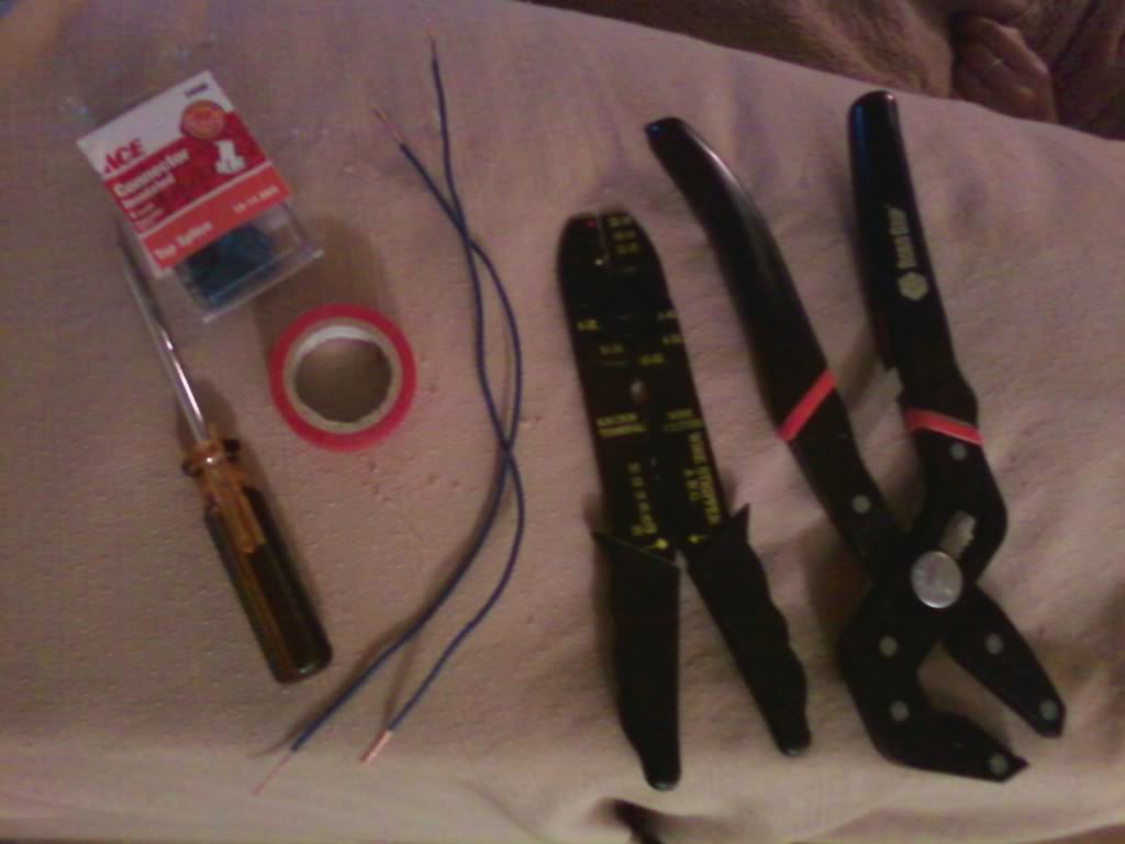

Start by gathering some tools:
12-18ga wire
appropriately sized quick splicers
a terminal
some electrical tape
pliers
wire stripper/cutter

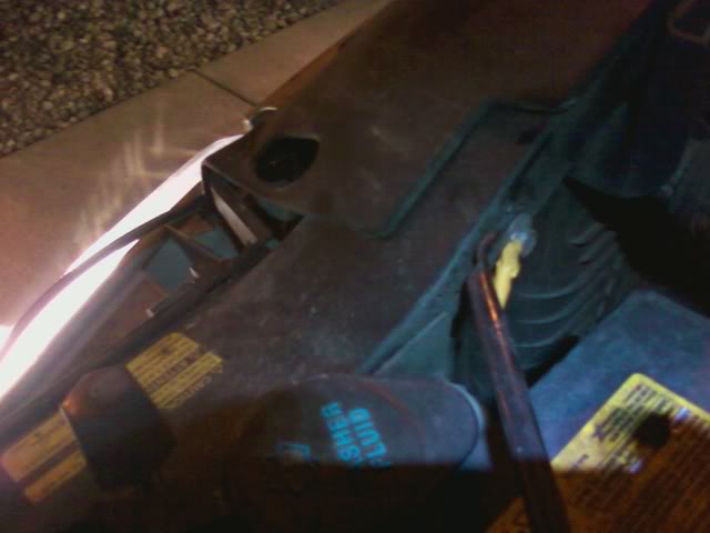

Perform the normal SUPER EASY 4-Hi Mod by splicing a wire to the ground (yellow) of the low beam, and connecting it to the diagonal brace just in front of the battery with a terminal. Cover the crimping with electrical tape to identify the wire and help prevent corrosion. Torque the bolt.
The lowlamp splice:
and its ground:
You can stop here if you just want the normal 4-Hi mod with the Lo's and Hi's on together when the High is toggled. The next step lets you keep the DRLs on with the Lows and Highs, allowing for the 4-Lo/6-Hi mod.

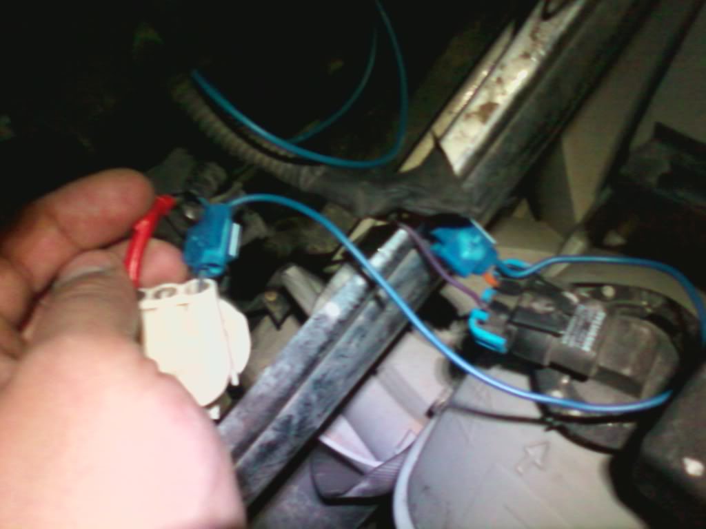

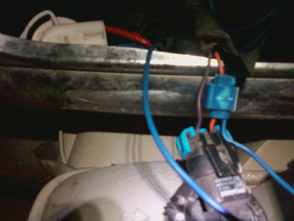

Attach a wire and quicksplice to the hotside of the highbeam assembly, the orange wire in the orange/purple pair on the highbeam of the driver's headlamp assembly.
And connect it to the dark blue (positive) wire for the DRLs. The negative is black, but I have red tape on mine in the photo.

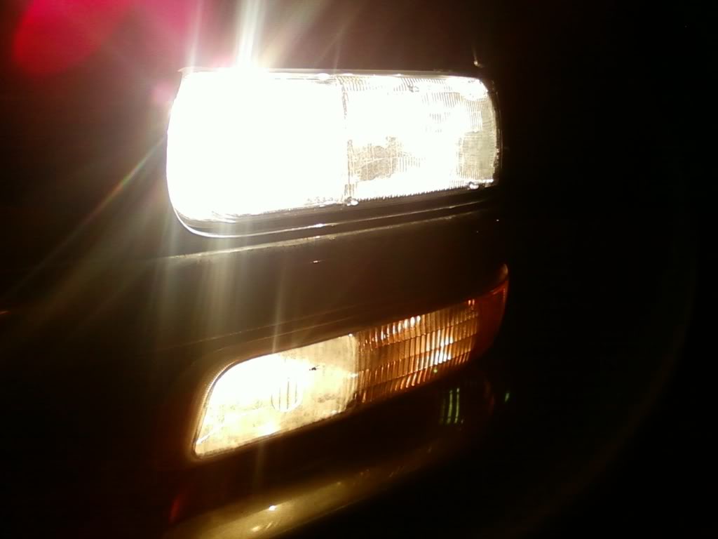

Crack a and enjoy your work!
AHL and Headlights ON - 4-Lo:
High Beams ON - 6-Hi w/ DRLs:
