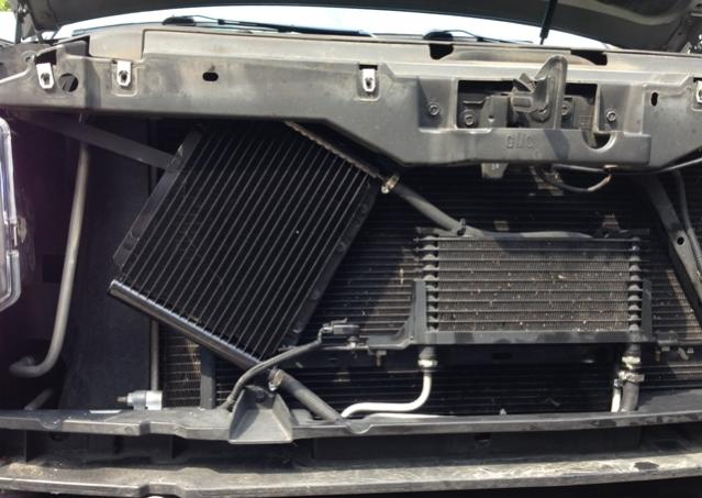

1st pic is what it looks like stock, not a bad size cooler but not big enough.

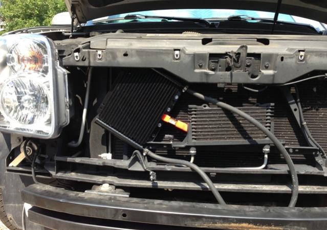

2nd pic shows the new cooler clamped in place and starting to bold it to the crossmember. Note the crash sensor unplugged and hanging down, be very careful with that.

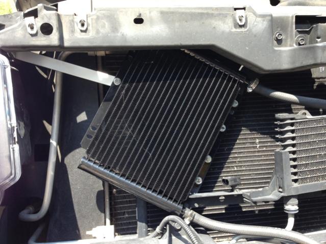

3rd pic is the cooler bolted in place, and an extra brace that I fabbed in place.

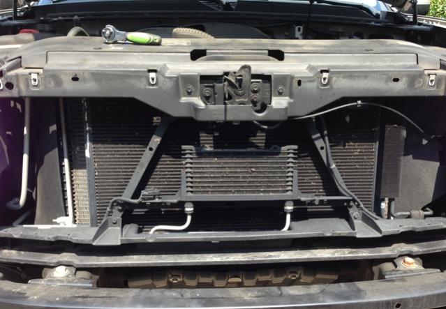

4th pic is the final installation, everything silver painted black, the cooler plumbed, crash sensor plugged back in.
As you can see, the new cooler is probably 50% bigger than the stock cooler so I should have plenty of cool trans fluid now. Best $60 and 2 hours I've spent on the Denali.
