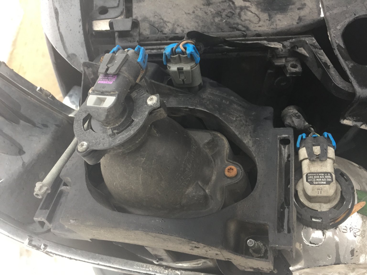

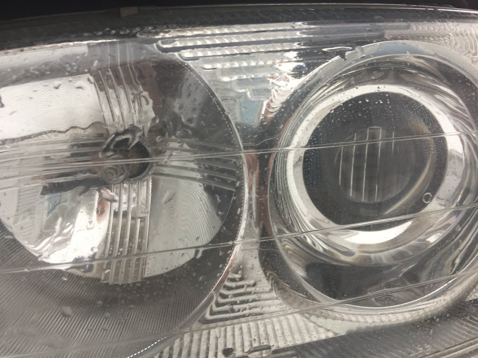

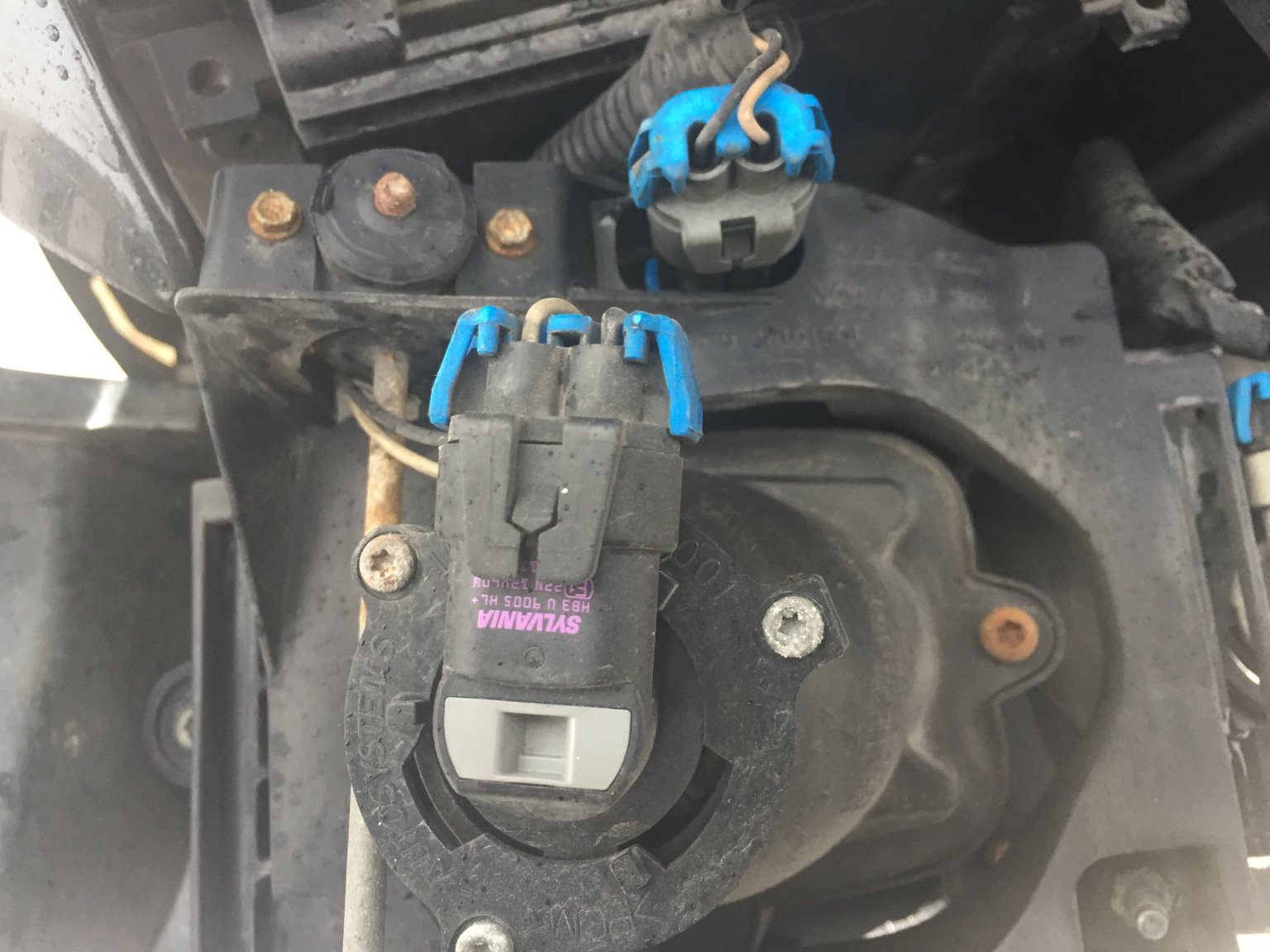

Well I am not the OP but here are my pics. I am to the point of wondering if they light up anything. Thanks

Weird; I was expecting to see some cheap aftermarket housings but those look like the original Denali projectors. The good news is that they work good with an inexpensive PNP HID kit. That will definitely light things up nicely. Those housings are in pretty high demand by the non-Denali crowd just for that reason. Most factory halogen projectors will scatter HID lighting so much that they don't work well or they blind oncoming traffic but the Denali projectors focus the HID good and they have a good cutoff line so they don't offend oncoming drivers. If you go that route, you'll want to do the 4-high mod so the lows stay on when you hit the brights otherwise when you go back to low beam it takes a few seconds for the HID's to light up again. Also, I did the auto headlight disable because it kept burning ballasts due to trying to fire up the HID's when the starter was turning the truck over and the voltage was low. It might sound like a lot of work but only takes a few minutes for each mod. I can steer you to the info if needed.

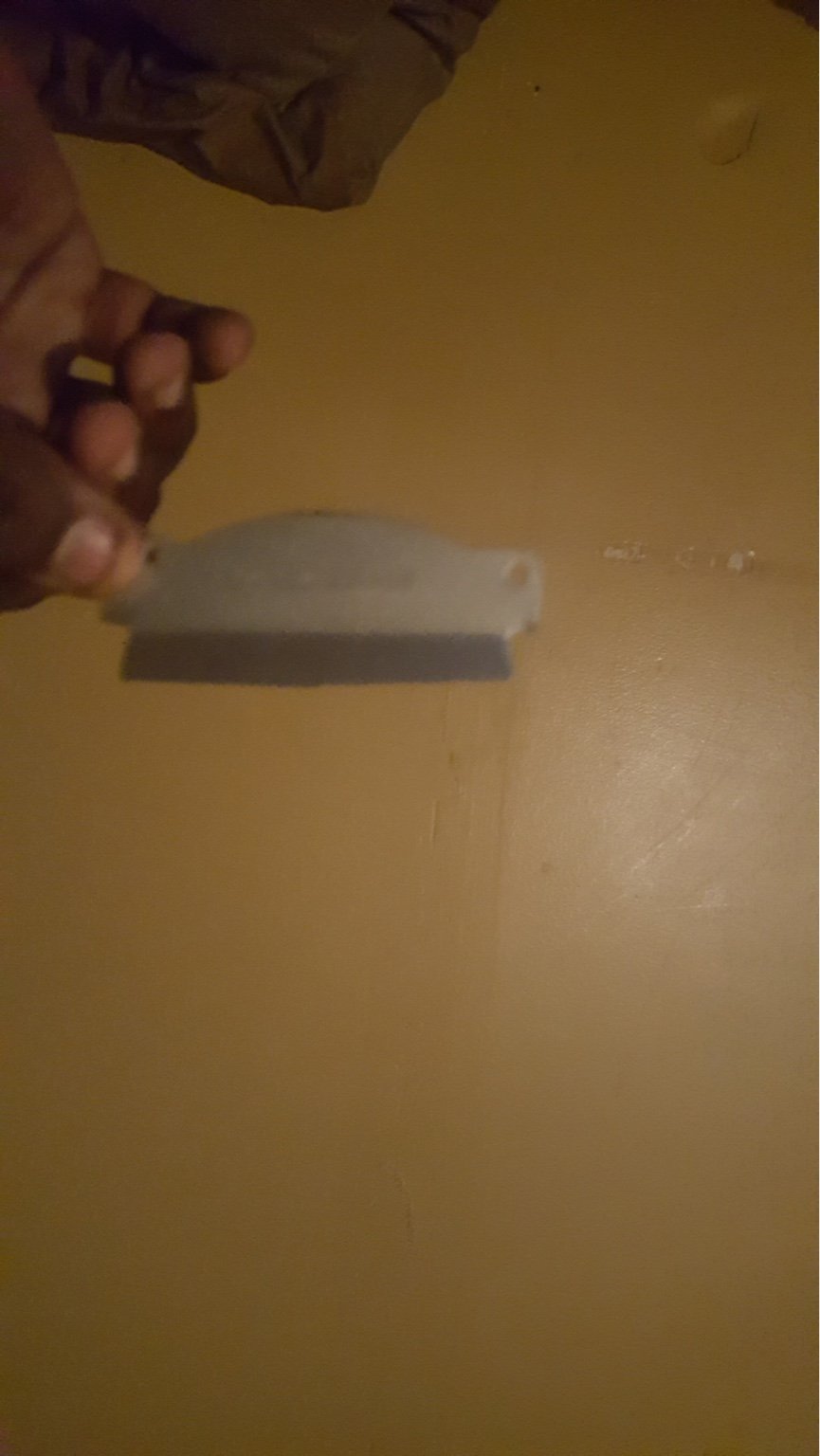

Perfect I am all ears and eyes....cause I need to do something cause I feel like Ray Charles trying to drive st night. Can't tell if it shows in pic but there is a plug for the low beam and that plugs into a short 6" harness that then plugs into the 9005 lamp. I assume this is all original. If these are referred as "projection" it's almost like there closed.

They can't be closed, there's no shutter like the projectors that combine high and low beam in one lamp. You might take the projector portion apart to see if they're dirty inside. Here's a link to the 4 high mod for an 03:

well i removed both headlight assemblies...they apear to be clean, and i then swapped low and high beam lamps and reinstalled..low beams still seem to not be very bright and hick beams are still very bright. I need to figure something out cause i almost feel there not a safe amount of light being emitted
