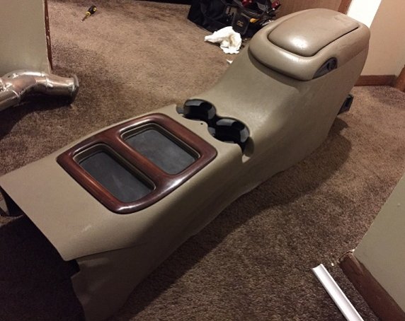

    found this beaut on CL the other day. fully intact, no cracks or holes.disassembled it and gave it a thorough scrubbing with some dawn.looks pretty good.its just the wrong color.
    any tips on painting vinyl/plastic? specifically what brand of paint you used and how well it has held up?
    been told by some that dupli color sprays on nice but doesnt hold up to wear very well. ive heard sem is the way to go.
    opinions? concerns? slanderous accusations against certain products?
    id like to eventually paint the entire interior black.
