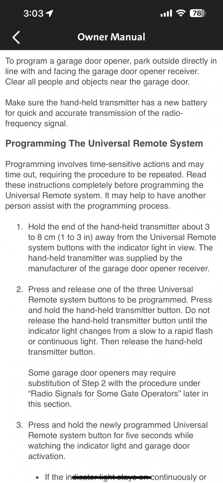

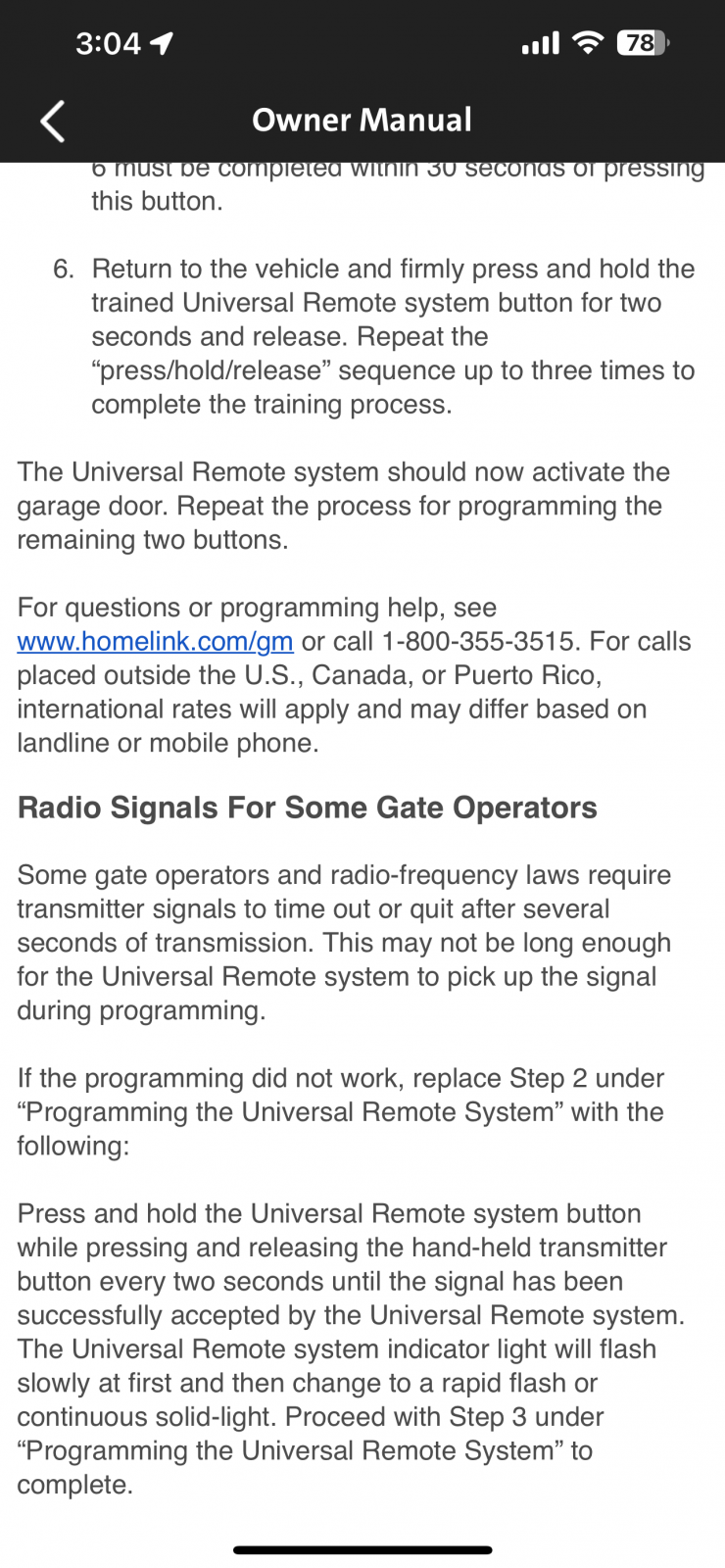

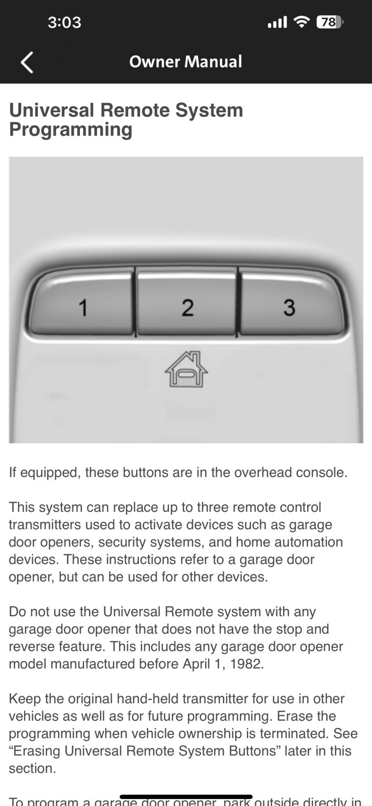

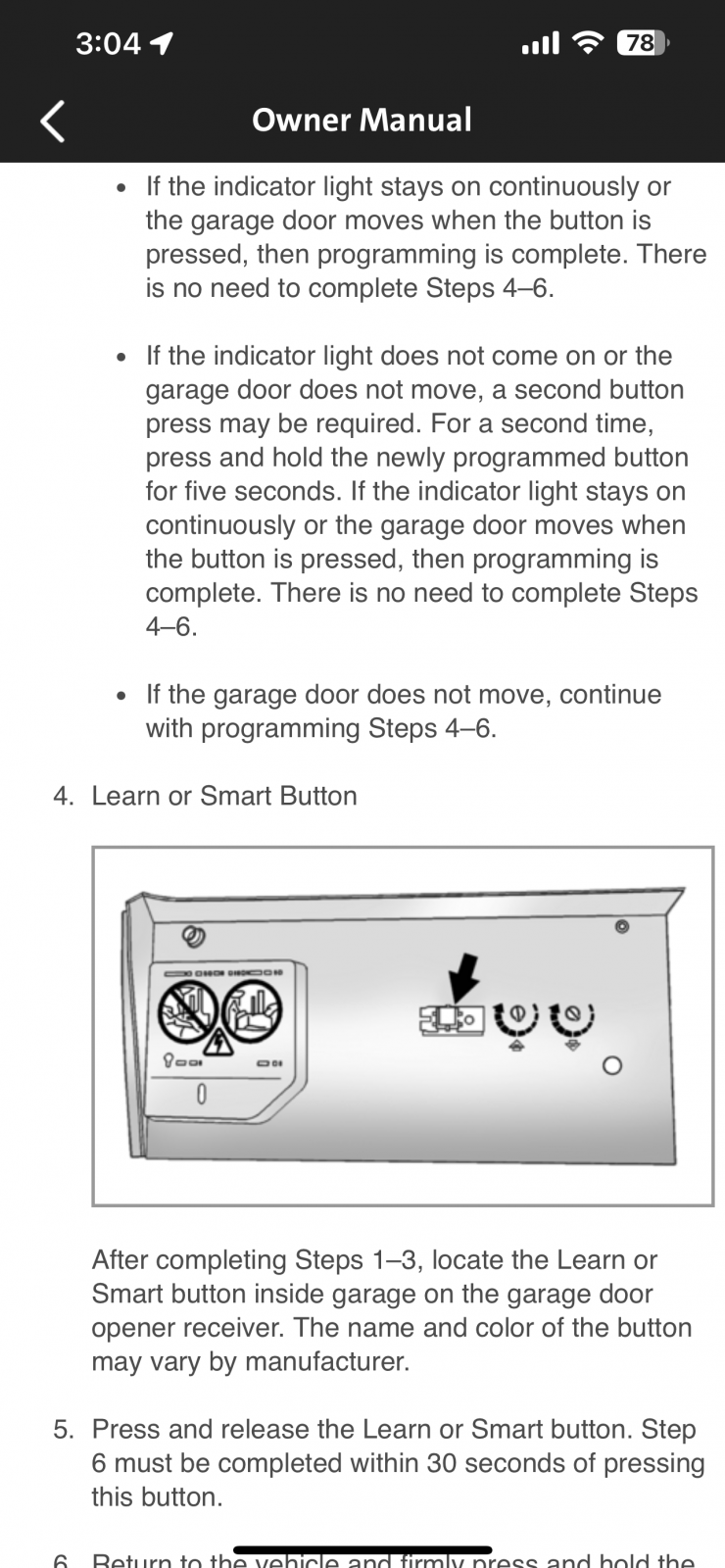

Hey all,
I've watched various YouTube clips, and I've read the manual, but I just can't seem to get my garage door opener to be learned by Homelink ('23 Yukon).
Seems that the problem, for starters, is that I ONLY get a fast-blinking Homelink light to begin with, where everything says that Homelink will start by blinking slowly (and then blink quickly when the opener has been learned). I think I'm starting off on the wrong foot here.
Btw, I have not yet tried to sync these things by way of pushing buttons on the actual garage door unit inside of the garage itself. I don't have easy access to it, so that's going to be the absolute last resort.
Anyone have any thoughts on this? Thanks.
