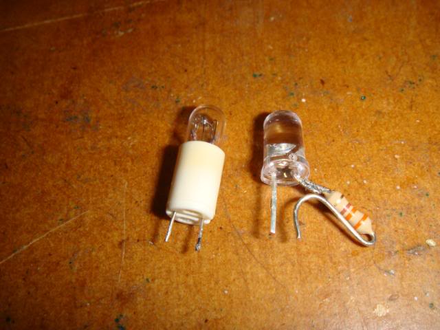

I have like 3 or 4 bulbs lying around from when I did my LED conversion.
The one on the left is the stock AC panel bulb.
