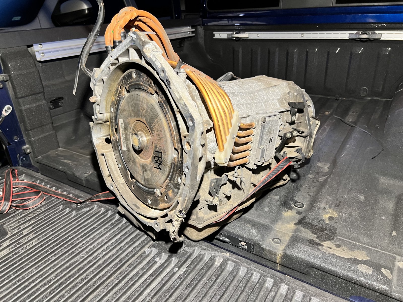

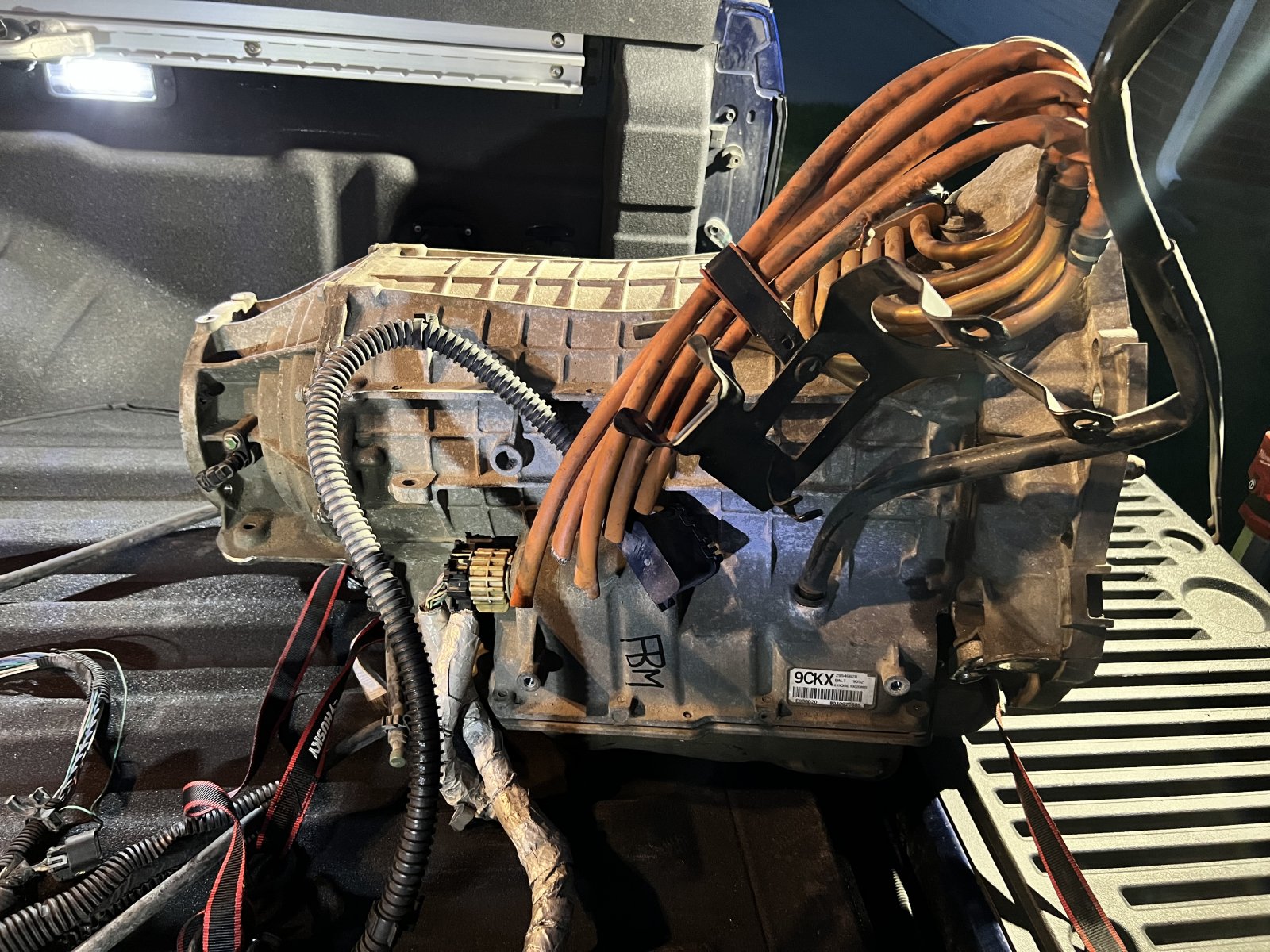

They do not sell any parts to rebuild these transmissions. I recently was able to find a used one an are about to remove and replace the damaged one. You have two options find a
used one or spend 11,500 Chevy will build you one takes about a year

Cobra transmission has parts for these listed on their website and Transsatar may have some parts as well. What drives the cost/scarcity way up are the hydro-electric motors as they are very expensive ($1500+) to replace if bad.
I havent worked on one of these units (yet) but have done a bit of research on them as every once in a great while someone will call inquiring about overhauling one of them...seem like interesting transmissions...
