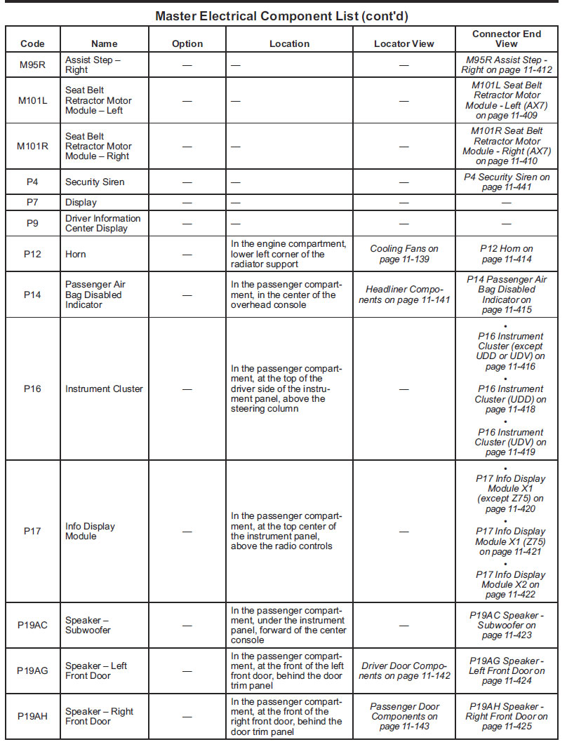

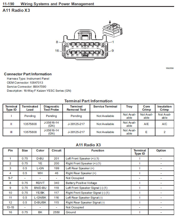

Here are the wiring schematics for the Stereo and Amp. If anyone wants any other wiring let me know and I will post em up.
Radio
Amp - it is located behind the jack bracket in the rear of the vehicle.

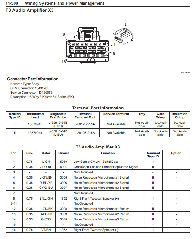

Very interesting. Multiple subwoofers in the same room (vehicle) perform in some very interesting ways when given the same signal. This is a common technique used to clean up modal response problems. The remaining question is which one, or both, are being used for ANC.
Rush
Nov 7, 2014
177
21
NC
We definitely know T3/X1 is being used. Don't know about the others.

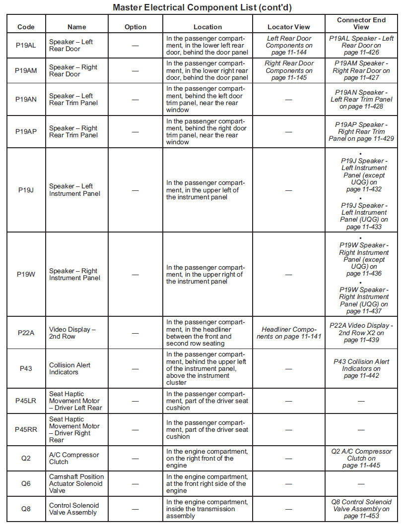

There is only 1 Subwoofer - if you look at the diagram above there is only 1 positive and a negative for subwoofer. There must be a misprint or they are using a postive signal from the one side and a negative from the other side to sum a mono channel to the subwoofer.
Look at the following sheets - no mention of a second subwoofer.

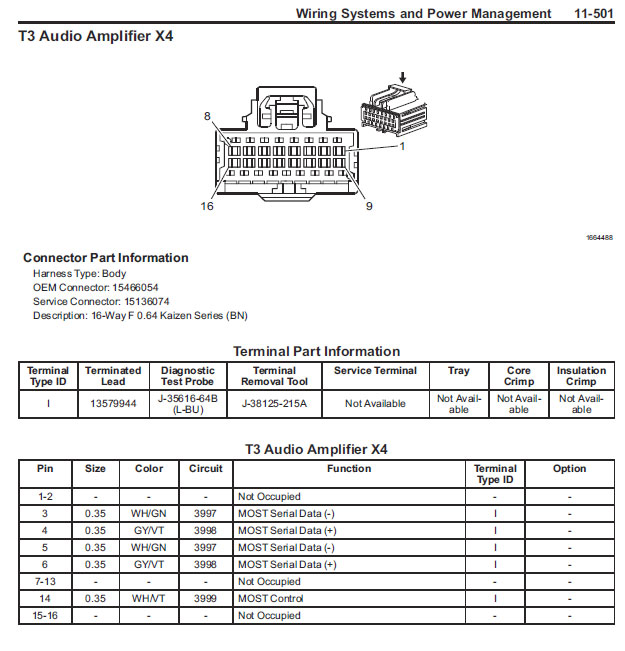

Radio schematic's rocked.
X1, X2, X3. X3 only has the low speed data, no canceling mic's. this is 2015 Lt with 9 speaker Bose.
X4 has all MOST wiring. Brown connector.
