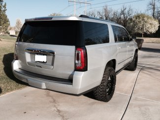

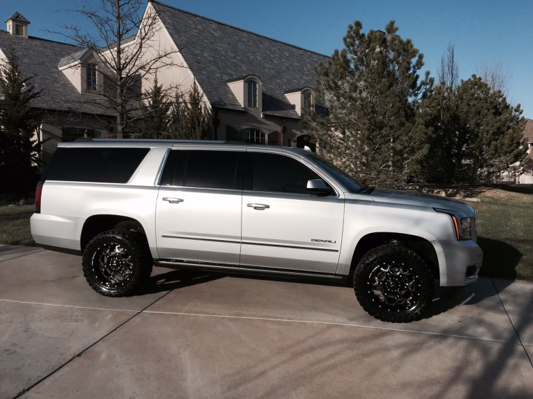

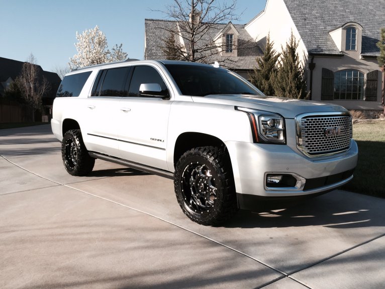

Here you go...cleaned it up last night!

Looks great! The front seems a tad bit lower than the rear still? Those m/ts on a 20x9 with 0mm offset?
Wristdoc
Jan 15, 2015
15
Thanks. Yes, the front was raised 2.5 inches and the back 1.5 inches. I think this leaves the rear 1 inch higher than the front. My driveway has a slight slope to it and that, combined with the angle of the picture, makes it appear more dramatic in the photos than it is in person. Still, I would much rather have the truck level or the rear slightly higher as opposed to the other way around!
They are 20x9 wheels with 5" backspacing and zero offset...you are correct.
