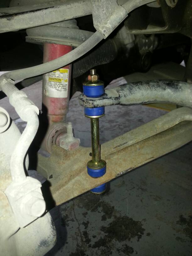

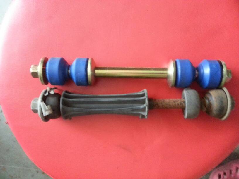

Was a very easy job. Old ones were destroyed.
It started when my wife was complaining about a popping/clunking noise. Upon inspecting the factory links, the bushings were dry rotted (the ones that were still there).
I bought NAPA replacements (Moog makes these for NAPA) and saved some money.
Very easy job.
If anyone is wondering, the factory links use a 15mm bolt/nut. The replacements use a 14mm bolt/nut
NAPA P/N: 265-1206

Good enough for me. I'm not much of a grease monkey, do I need a jack to install? What other little parts like this should I look into replacing?
A jack, jackstand (for safety), 22mm socket or 4-way for lugs, 15mm combo wrench, 15mm socket (in your preferred drive size), ratchet (in your preferred drive size), penetrating spray (in your favorite flavor), replacement links, and time to remove and install.
My replacements required a 14mm combo wrench and 14mm socket.
Optional is an impact (makes life easy)
Added p/n to first post!
