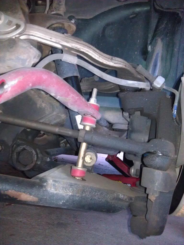

Sure thing, will do. I'm switching my rims so I'll have the wheel off anyway. I bent a rim but they are discontinued and I can't find a set with the backspacing I need so I'm going back to a stock setup. But forewarning my tahoe doesn't sit as low as others with the same components for some reason. I have yet to figure out why...
MeanGreen03
May 31, 2009
358
TX
Here you go:
Mind you, I'm also body dropped. Like I said I have no clue as to why I don't sit much lower.

Only difference is spindle but you should sit a lot lower. How much are your key bolts turned in?
MeanGreen03
May 31, 2009
358
TX
My drivers side is all of the way in and the passengers side is all of the way out. The passengers side is still a tad higher but I'm out of adjustment. I'm pretty much the same height all of the way around so I'm ok with it. It really wouldn't be too drivable if it were much lower with my 24's unless I got some smaller tires.
