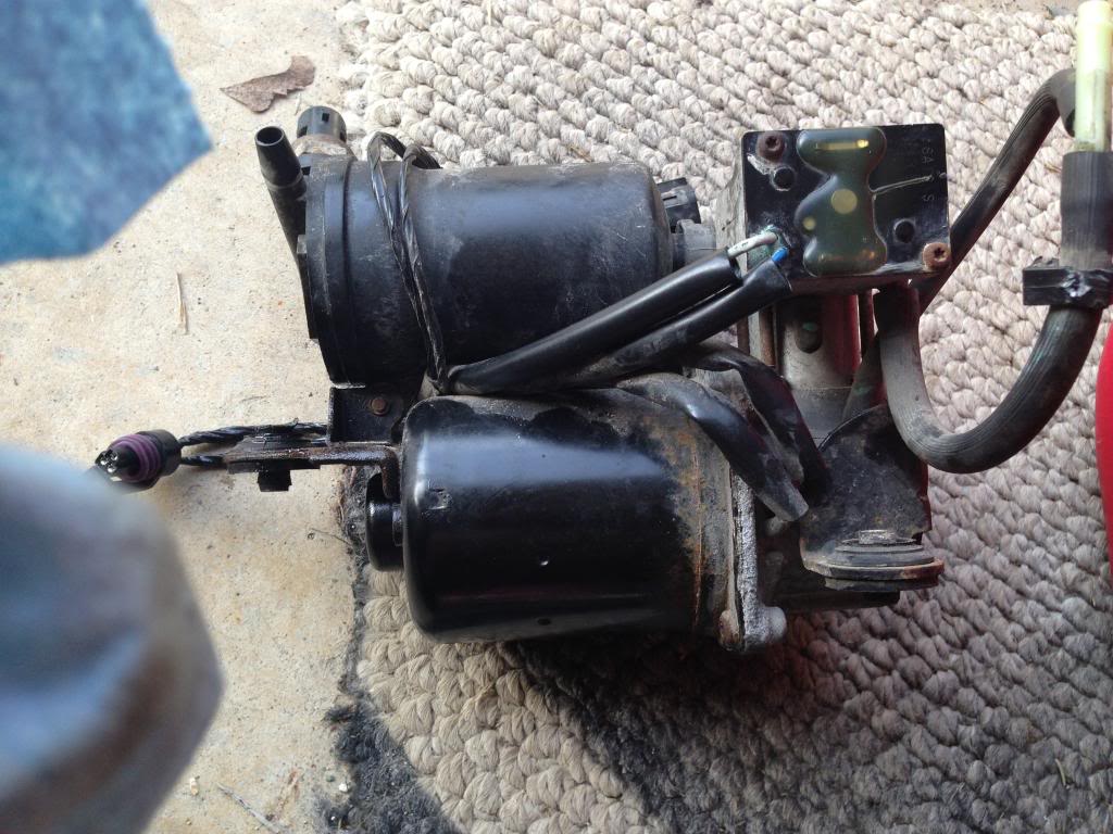

On the pass side behind rear wheel the compressor hides...we noticed that the bushings were pretty loose and worn out...still have to replace or come up with something sturdier.

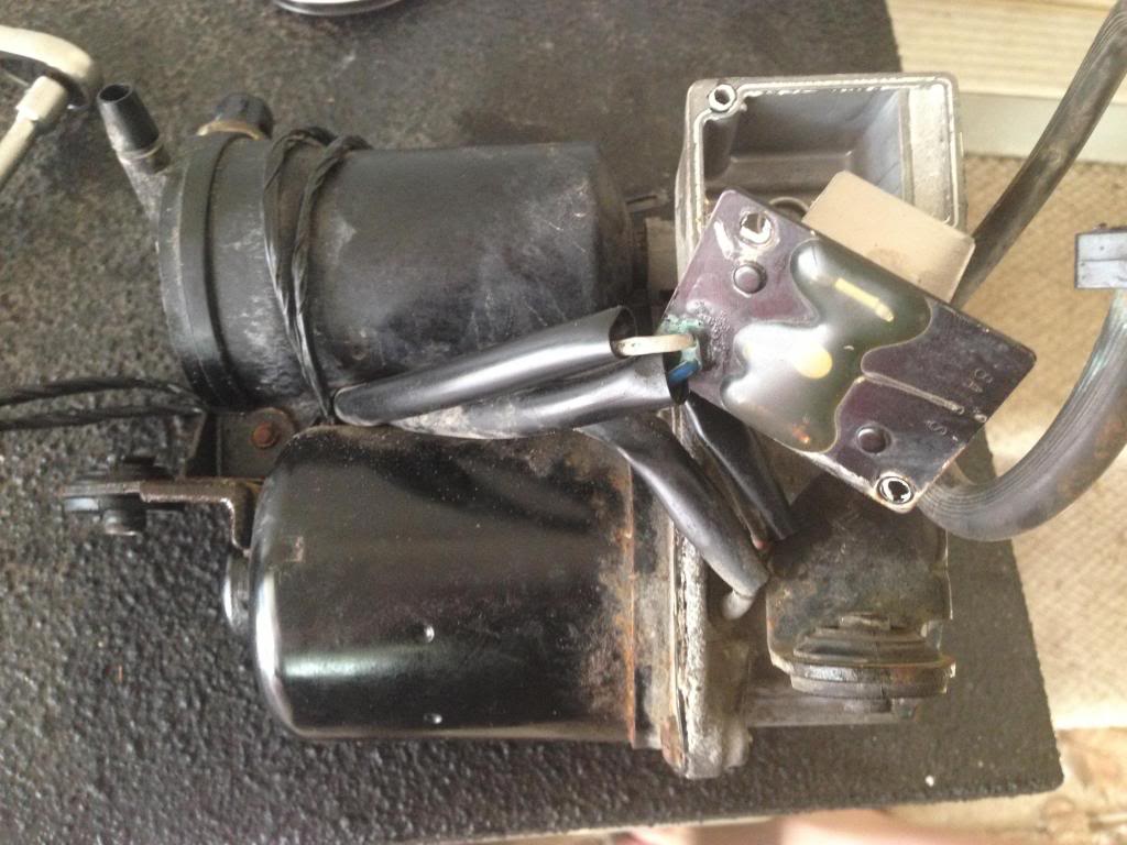

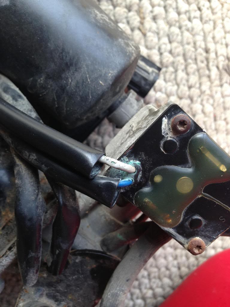

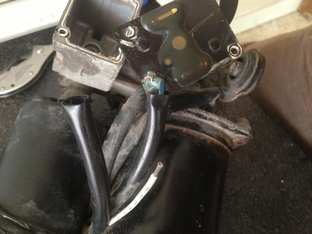

Here is the compressor removed, and you can see the white wire exposed and corroded...it literally was about 1/2 of corrosion under the wire coating.

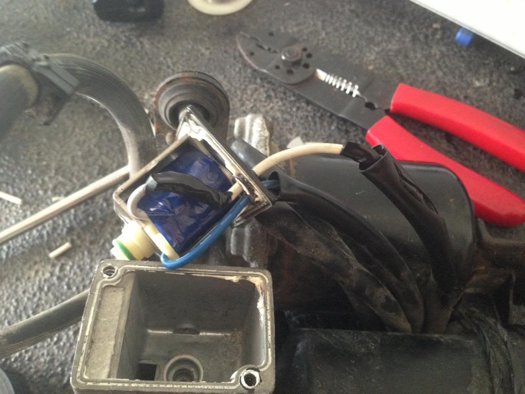

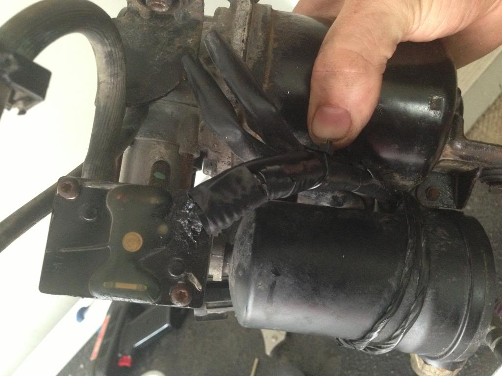

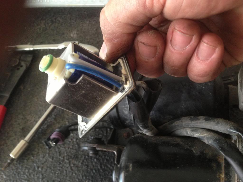

We opened the little assembly to the right...it was sealed and had an oring at the bottom...not sure what this does, but we were careful not to damage anything.
..and the wires ran inside...
We basically just extended the wire, sottered, resealed with rtv and put it back together.
Put everything back together with more protection around the wiring so it doesnt rub again.
Started it and aired right up. Stance with air up: 35.5 and 35.25 on rear fender heights
Hope this saves someone some money on a new compressor if its just a tiny wire corroded. :rockit:
