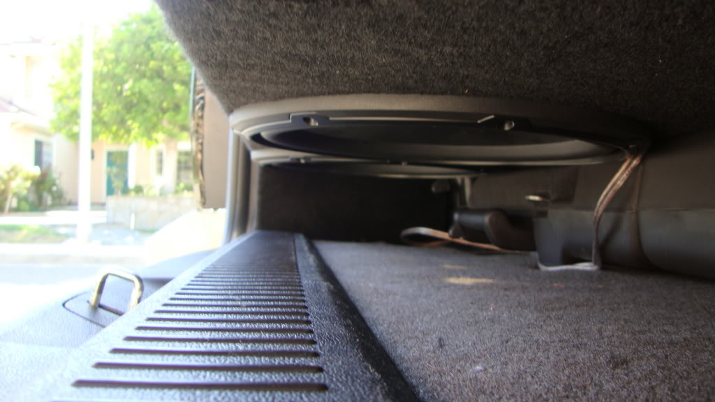

Yeah I have a box behind all three rows. Had a local shop in my area build it for $60. It fits my 2 12" JL W3. It was one of the my favorite mods Ive done its just soooooo convenient.
Feel free to ask questions

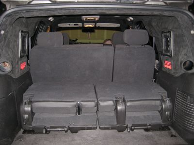

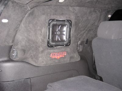

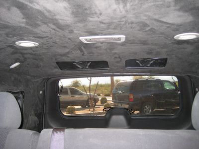

here is my install, sorry its on a new body style but it works.. 1 8" Kicker L7 in each rear window powered by a Kicker 1000.1 amp and it hits 134.6 db at the last USACi stereo competitionpicture.jpg,picture.jpg,picture.jpg

Very very nice... i was just measuring today to try and find 2.5-3.0 cubes behind the 3rd row.
Im guessing that if you needed cargo room (ie groceries) you could pull the box, remove the 3rd row, and then put the box behind the second row without issues?
Syndiacate Steve: for show that is very cool, but on my people mover, visibility is already uncomfortably restricted an blind spots abundant.
