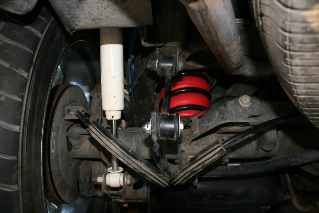

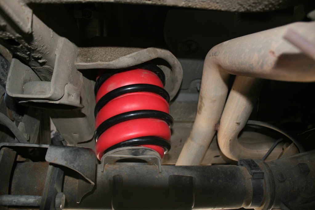

Just installed my helper bags! :D
BlizzardX23
May 3, 2009
4,365
8
Sacramento, California
Air Lift 1000 - Kit/Part Number 60769 (Thanks Max for the info!)
Took forever because the people who did the hackjob trying to cut one bump stop bracket off didnt seat my coil isolator...so I had to run to the store and rent some spring compressors to fix the isolator so there'd be no issues with the bags...anyways, after half a day, they are finally in! I know Max is running around 5 psi he said, but Im running at least 10 psi till I get new shocks..sad thing is, I still cant drive the truck till my new fender gets here!!! :(

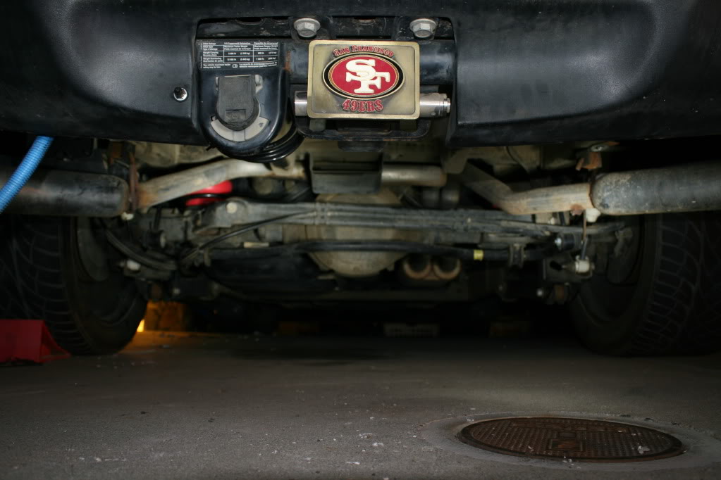

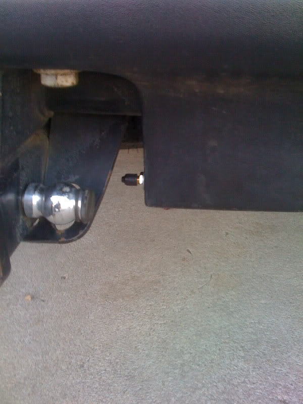

Can anyone spot my AirLift Valve Stem?
Just fill the bags the same way you fill your tires :) very easy!
Max
Mile High
May 3, 2009
3,570
33
Denver
I almost put mine there, ended up hiding it behind the hitch
BlizzardX23
BlizzardX23
May 3, 2009
4,365
8
I was going to do that...but some hoses are harder to get into spaces like that...so I made it somewhere easy to access..and I figure, the bags have to do with towing...so I placed it next to the other towing piece

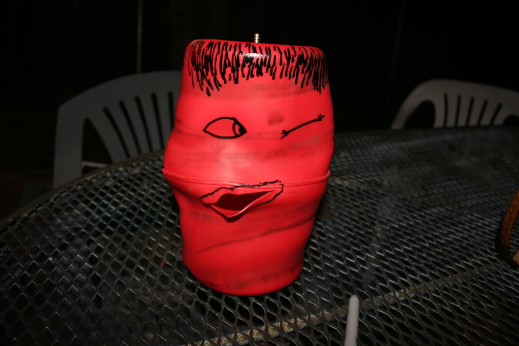

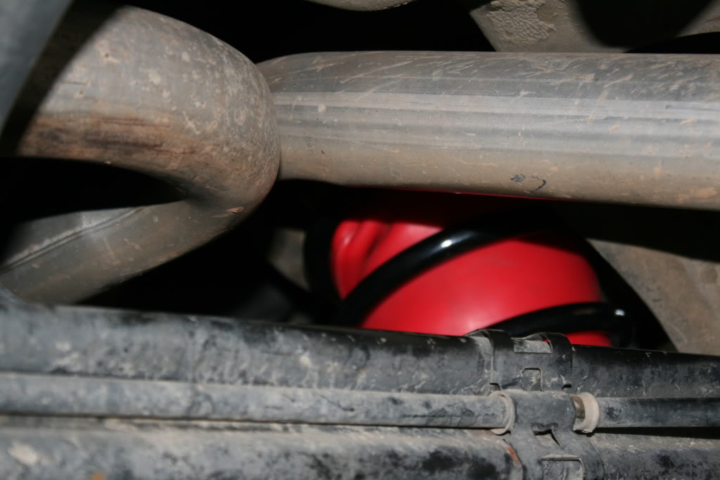

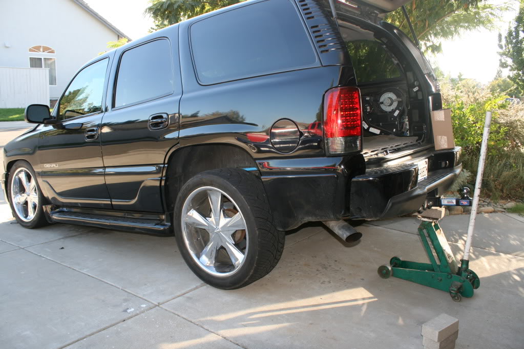

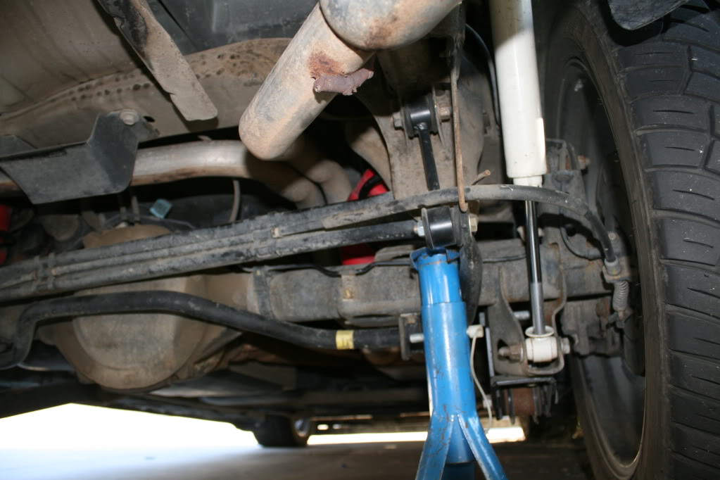

After I blew my airbags, I had to crawl under and reinstall one...here ya go
I call him AB the AirBag
After jacking up the truck with those bricks..I saw the truck sliding forward...so I lowered it and rethought what I was going to do...last thing I wanted was to be under there and my hand get stuck between the spring while removing the bag..
goozdenali
Banned - Bad dealings with members
Sep 6, 2009
103
massachusetts
if i remember correctly he put too much air in it, he didnt realize how fast they air up.

Did you ever figure out why it blew the one bag? I might have missed it and if I did I apologize. Percocet owns me tonight...
Yup
