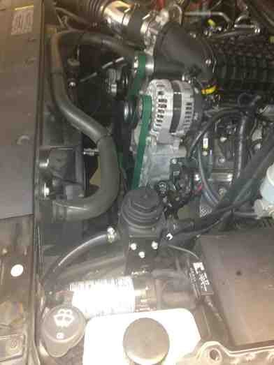

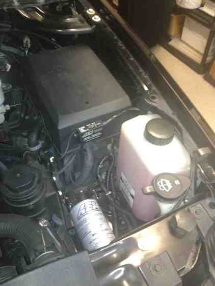

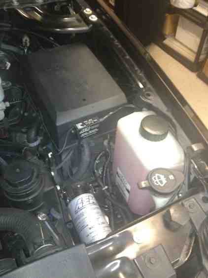

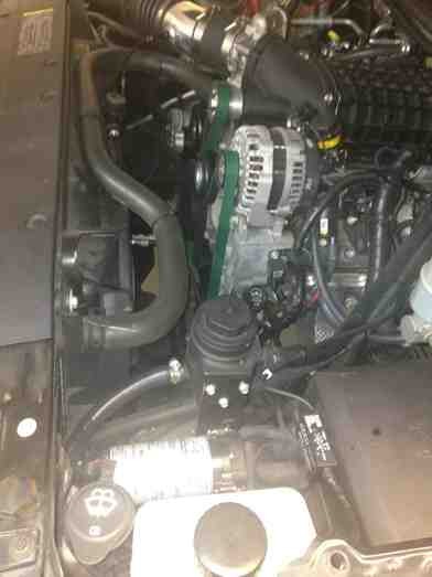

I'm a fan of the 4l80. Strong as hell. Here's the pics of the meth under the hood. The reservoir fit perfectly where the spare battery would go. ImageUploadedByTapatalk1347991495.820185.jpgImageUploadedByTapatalk1347991505.920994.jpg

I'm a fan of the 4l80. Strong as hell. Here's the pics of the meth under the hood. The reservoir fit perfectly where the spare battery would go. View attachment 18141View attachment 18142
Level10 is ready to build up an enforced 6L80 transmission(together with transfer case) that can work with 1000hp engine. And Denny's is ready to build a new driveshaft. So let's see :) i still hope to use this esky for daily driving, so think to have 6 speed gearbox is more useful for me. And hope new 1000cc fuel injectors will give good idle also.
Actually, if I'd start a new project with another esky, I'd start with LSx short block... Darton sleeves are really good, but too complicated technically to install them right.
As for the meth, I'll see the numbers of Hp and Torque engine will show on a dyno. The potential of two superchargers approximately 34psi so that can be more than enough not to use any power adders like meth or nitrous.
