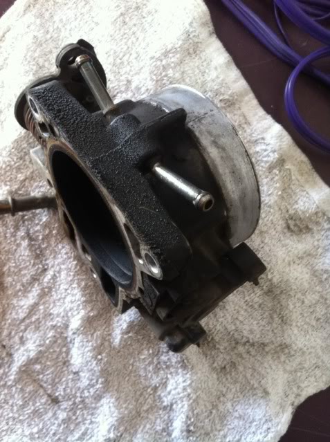

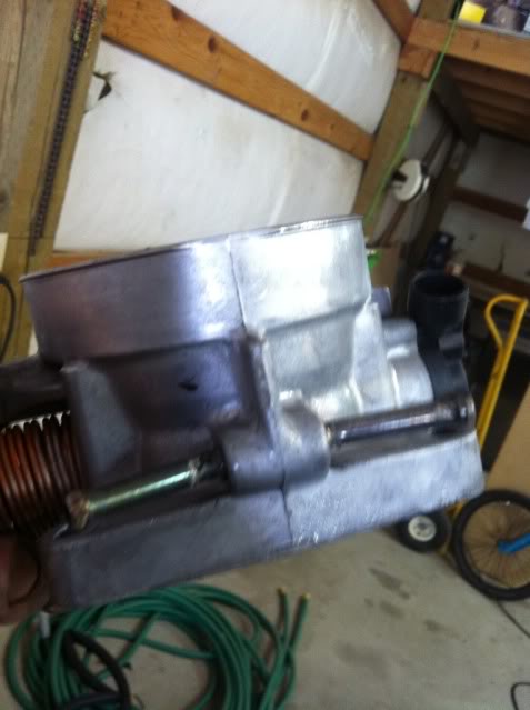

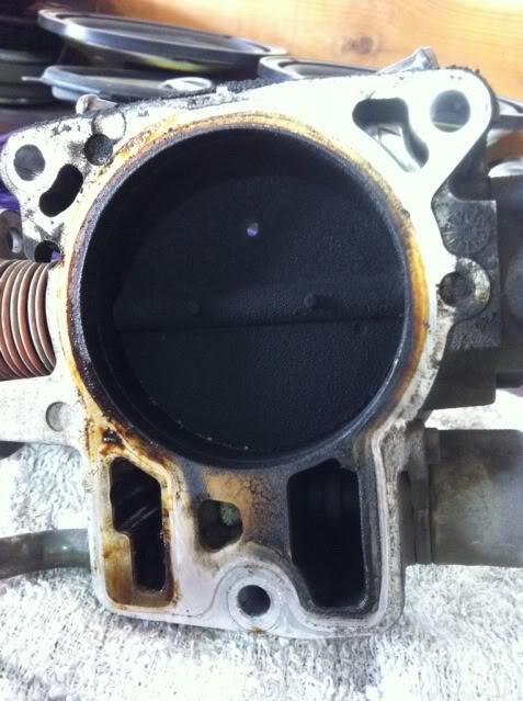

So for the last day I have been trying to figure out what the problem is. I pulled the tb off and cleaned it. It looks like it has never been touched! But still no help. Also is their a way to test the maf sensor? I'm also thinking that it could be and injector but I am not sure which one since I have no codes. I'm picking up a scanner today and will see if any have been stored. I'm hoping that one is in their and will tell me whats going on.
Before
After

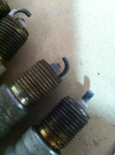

Also here is a shot of the old plugs.

You can eat off your TB now. But a dirty TB wouldn't cause a stumble anywhere over idle speed.
Those plugs were definitely wiped out.
What did you replace them with?

1. yeah that is 205k miles on that tb.
2. Those plugs are beyond gone. Are they not supposed to be platinum type?

I thought that all the 5.3s used platinum plugs. He definitely wore off the platinum on those babies.

If I remember correctly the Delco plugs have a spot of platinum on the ground electrode that you can see as the little white dot on the plug on the bottom.

there iridium for 2001 look like this:

BTW, why is there a hole in the throttle plate?

They are worn out but I really can't see those being original plugs. 200k miles. I just cant see that happening. Not impossible but I cant see it happening.

damn.. that throttle body was nasty as hell... im pushin 240xxx on mine and ive only cleaned mine with a tooth brush and a rag with it still on the motor.... kinda been leery on yankin it and actually CLEANIN it... was it a pain gettin the butterfly out? and how much of a pain was it installin it back to the manifold?

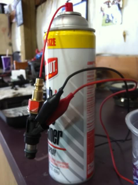

I put autolite xp iridium plugs back in. As far as the plugs being factory that's what it's looking like. They are acdelco ngk pztr5a and are long gone! Lol... As far as cleaning the tb while it was still bolted up I didnt want dirt and gunk travel down stream to my injectors. After I cleaned that I pulled both fuel rails and made a little home made injector cleaning setup. And I'm on my last injector... Ill put it all back together and see how it runs. If it still running bad then I guess it's gonna be one of the coils.

This is the home made setup I made to clean the injectors.. Dont laugh lol it works..

O and after all the injectors were cleaned and put back in it still is missing! so I will be getting it on a scanner in the morning to see what is exactly going on.
