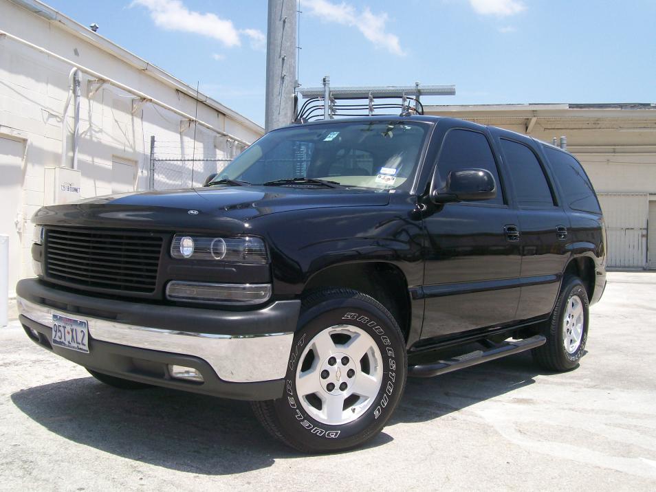

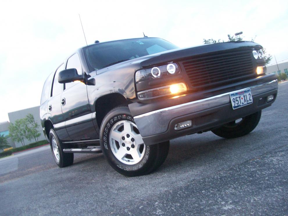

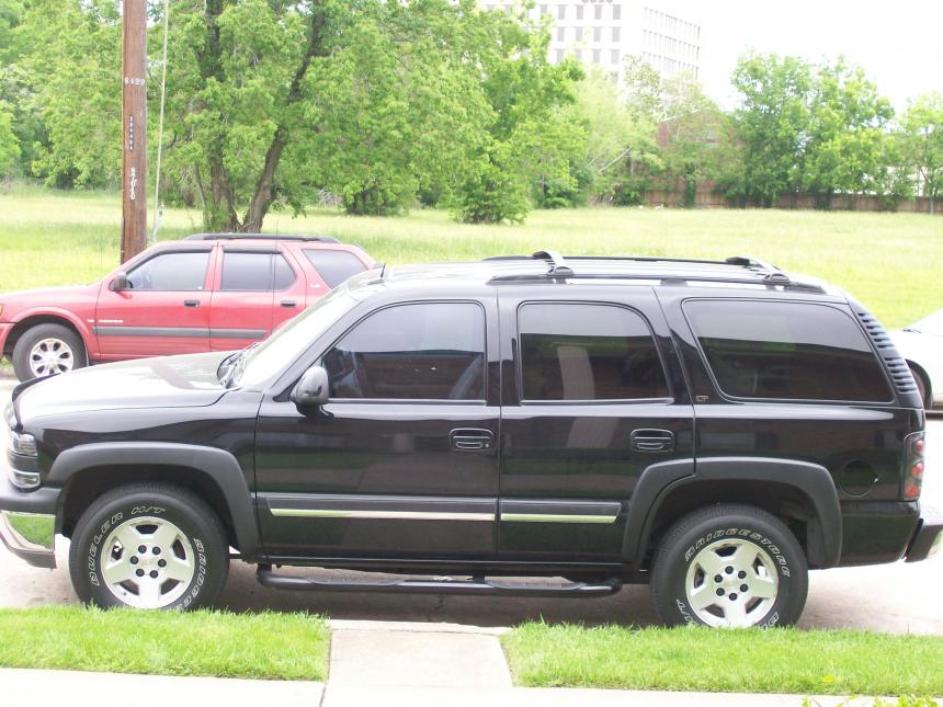

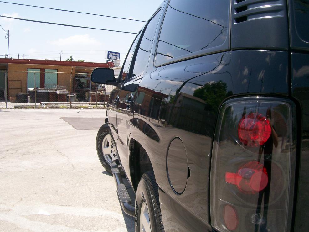

well, just took mine off...came off way easier than the door moldings, that turned into an all day thing. dunno, I used a heat gun and I think that made it leave a thin film of goo that took forever to get off...
with the flares I just pulled them off, I think I got lucky, a lot of the adhesive already wasn't sticking anymore....and the wife volunteered to pick off what was less, just with that I was ecstatic lol...anyways, an hour and half total i think to pull them off, use some goo gone, then clay bar'd and waxed
As far as those peg holes, they are tiny, don't think anyone is gonna be looking, but at any rate I just put the plastic pegs back in. I'll get some before/after pics up by the weekend.
brndns_hoe
May 4, 2009
864
Plano, TX
ok here's some before/after.... mine's an 05 so over time the edges of the flares i guess wore a bit on the paint, but very minor, even in the close up pic it's not noticeable.
Looks great! I'll see if the wife wants to do this to her rig next weekend...
