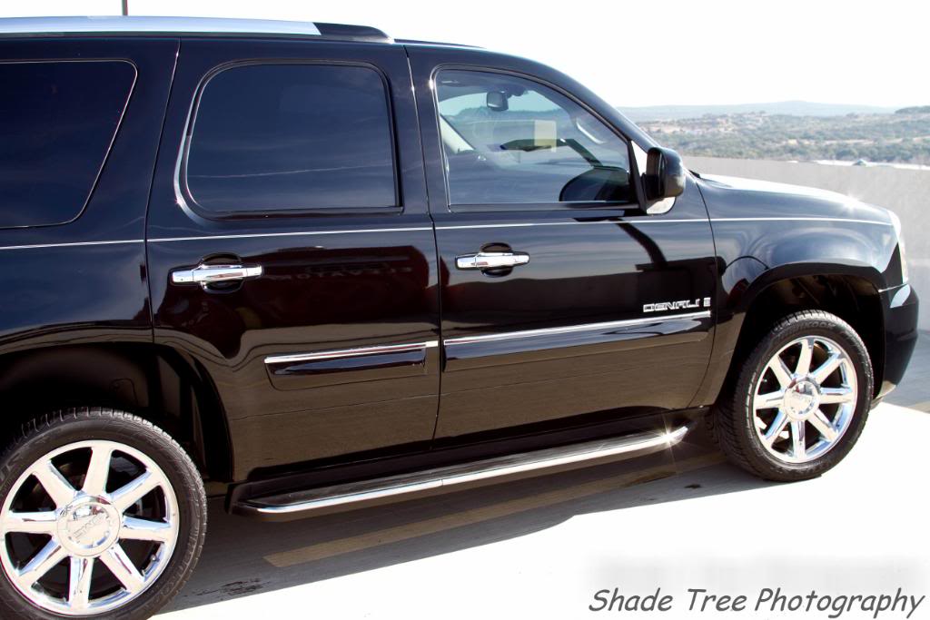

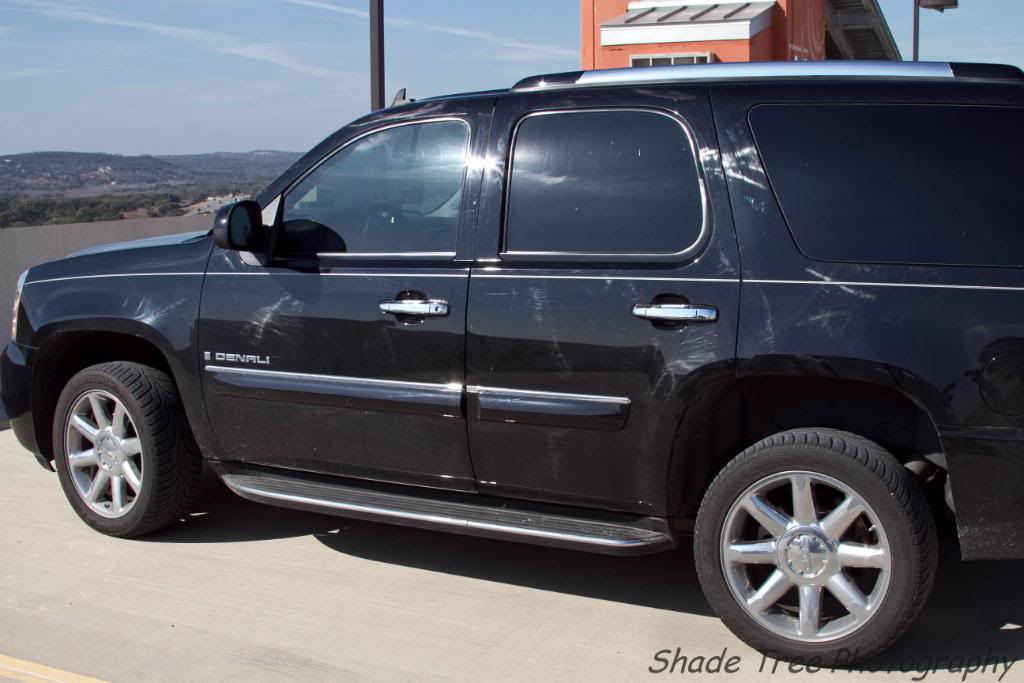

PC is your friend ..........
Before:
After:
