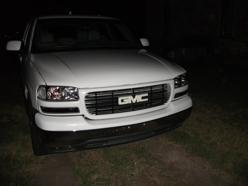

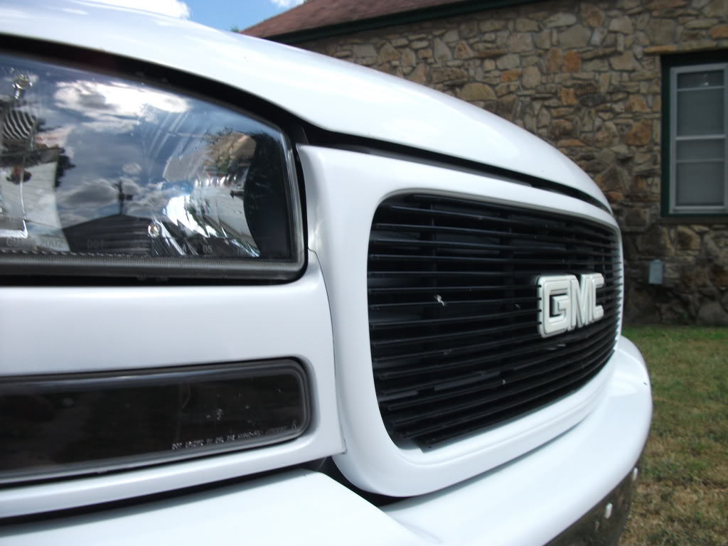

Finally got around to color matching my grill shell today. Next is bempers!

Yep. I used duplicolor exact match. The color is dead on I just need a better clear. Those were the only pics I took because I was pressed for time, but it wasnt to hard. I ruffed it up with some 320 grit wet or dry sand paper. Cleaned it real good with dish soap and a rag. Sprayed 3 coats of adhesion promoter. Then a light coat of self etching primer. Two more heavy coats of primer. Sanded with 600 grit. Washed cleaned again. Hit it with a tack cloth after it dryed. Shot 3 more coats of primer. Sanded again with 600 then finished with 1500 for a smooth surface. Cleaned again. Tack cloth again. Used two cans of the duplicolor exact match paint. Dont remember how many coats it was. Then finished it off with a can of clear. Im not to happy with how dull the clear turned out. Im gonna wait 48 hours then hit it with some polishing compound and wax see how it ends up then, but ill probably end up re spraying with some better clear.

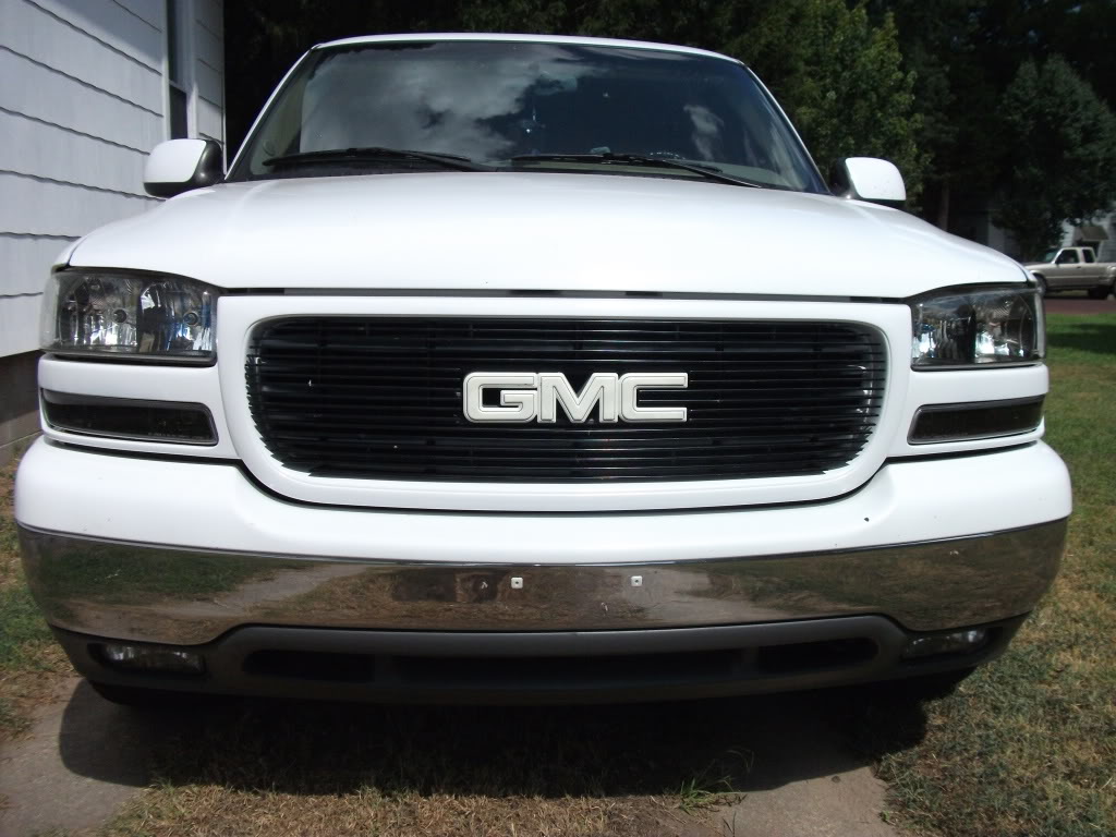

How about a 3/4 shot from a distance? I have a white Yukon and I have an newer style W/T grill that I can paint but I am on the fence about painting it white and having the chrome bumper.

Exactly what I wanted to see. Thanks. :Handshake:
I just didn't want to paint the grill before I got a paintable bumper.
