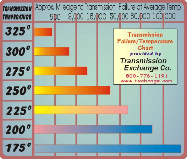

In the winter mine has been running 140-160. Now that is has been warm it has been running 170-185. Here is a good chart I found on the 4L60E
