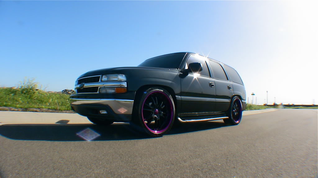

there is my grille before and after
only problem is the body color turned out a little bit darker because I have 7 year old paint
I just need to do my bumper next.. the tricky part will be the textured plastic

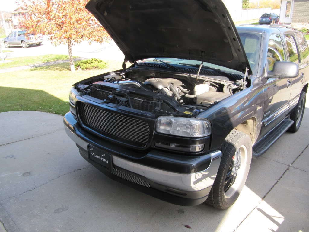

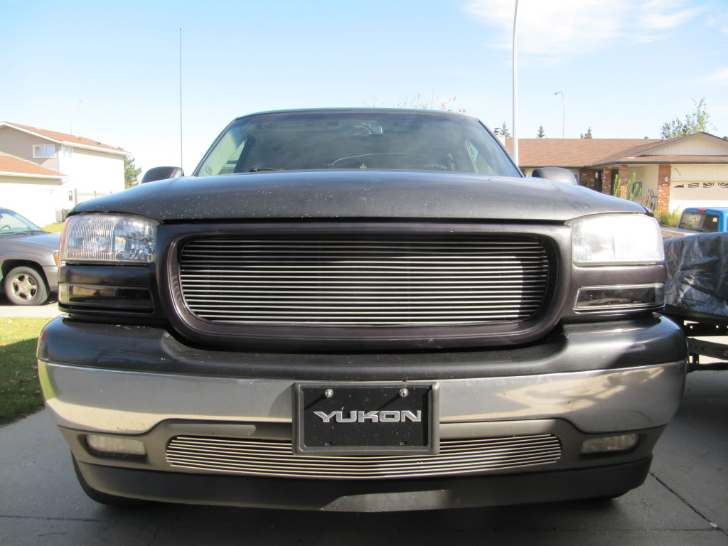

found some better pictures
and yes I know the turn signals look like shit in those pictures but they got cleaned up real nice ;)

painted grill here, no problems what so ever
that looks great man. It was just that I saw a late model Tahoe with chips all over the color matched grille and it had me a bit apprehensive. I guess it was a rattle can job or a lack of clear

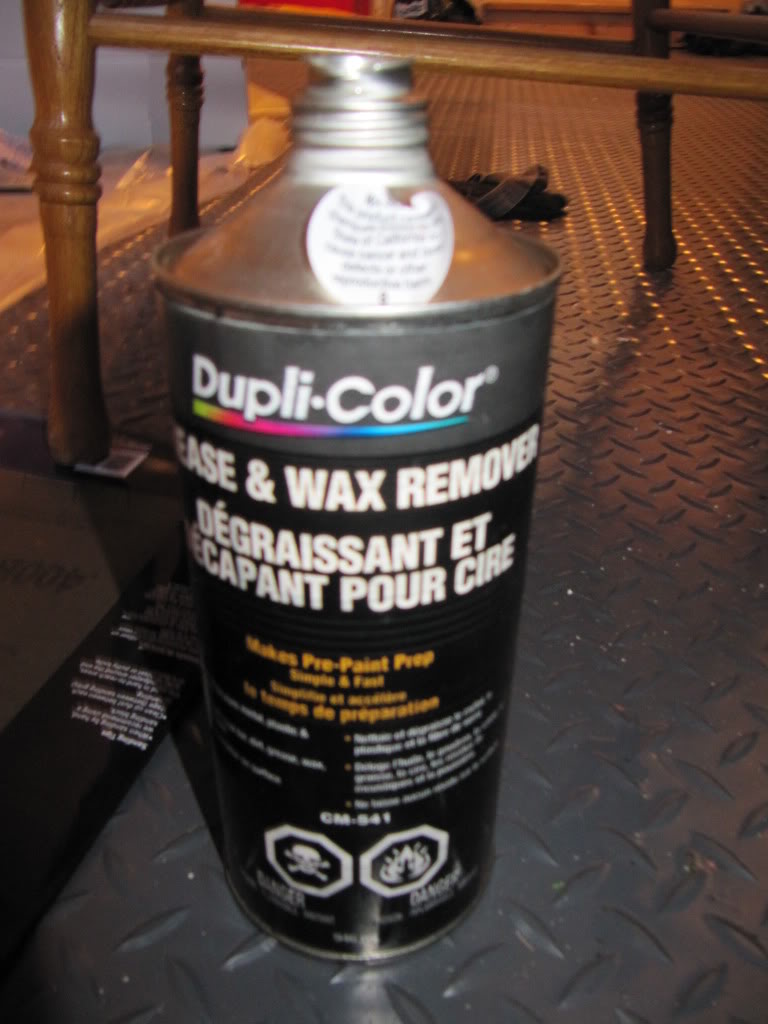

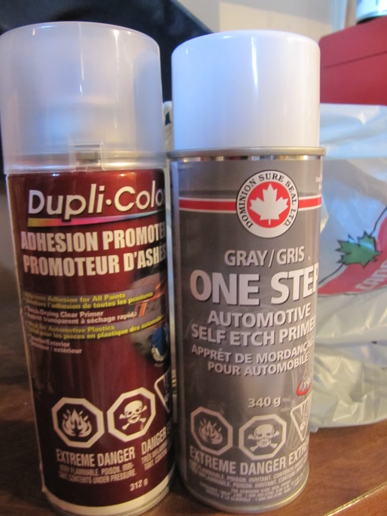

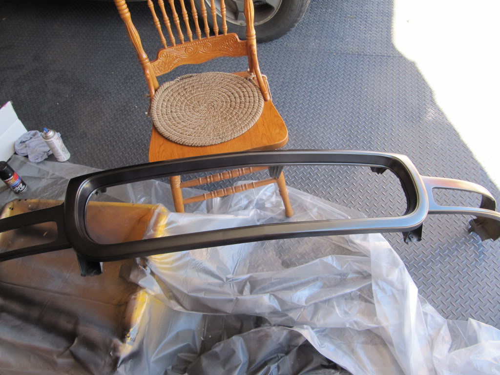

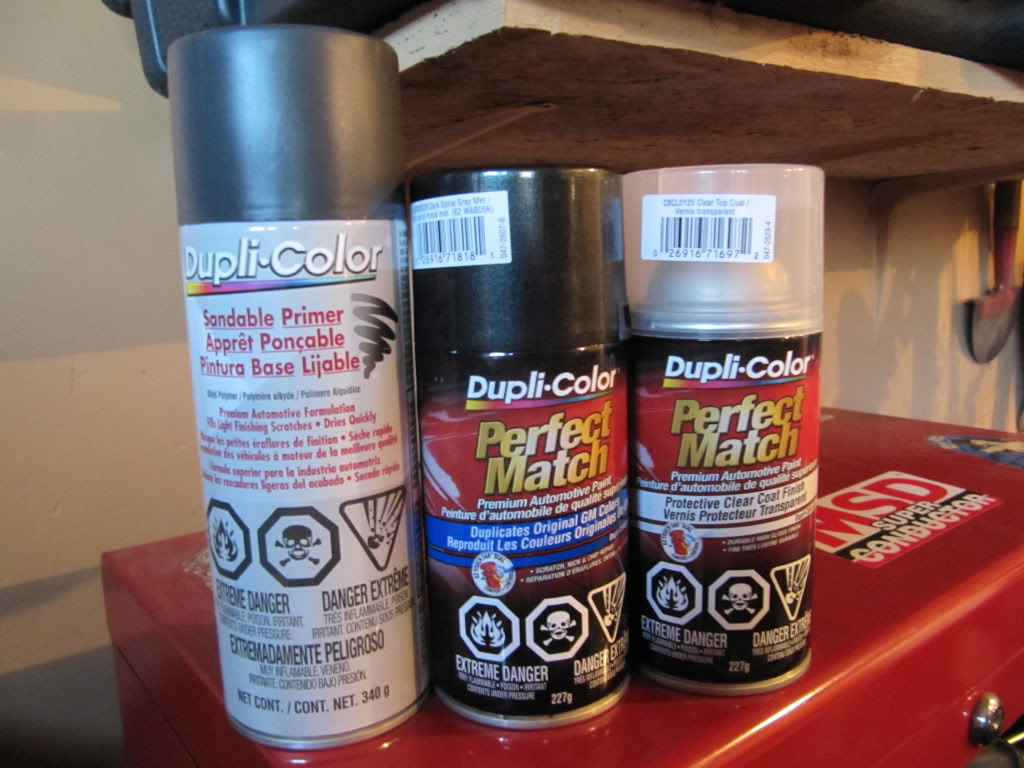

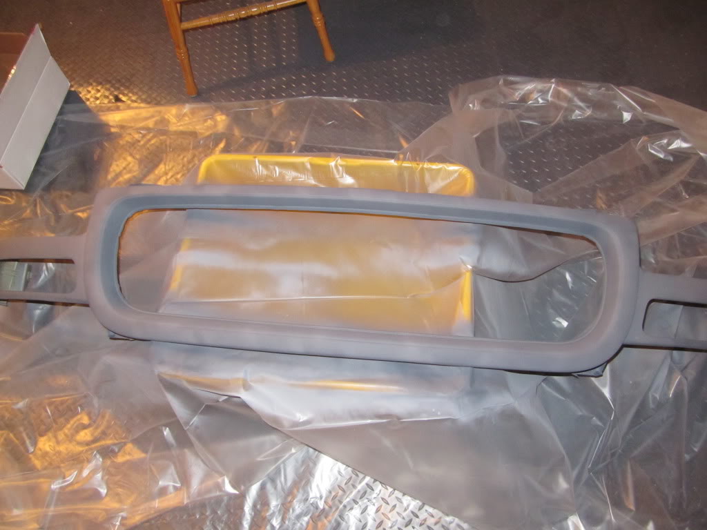

so for those interested heres the pics from my painting my grill
the degreaser and cleaner
The adhesion promoter and self etching primer
then reg primer, paint, and clear coat
so i cleaned it sanded it with 400 then followed the rest of the steps
self etching
primer
paint
then some pics of it installed

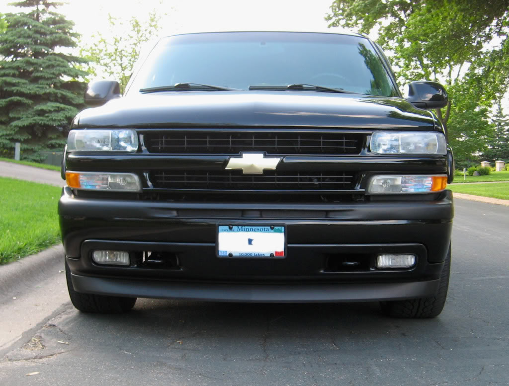

Painted Valance
I used Krylon FLEX to paint the grey valance on my Tahoe. Used alcohol to clean off the wax and grease.
