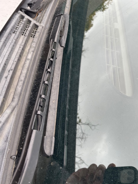

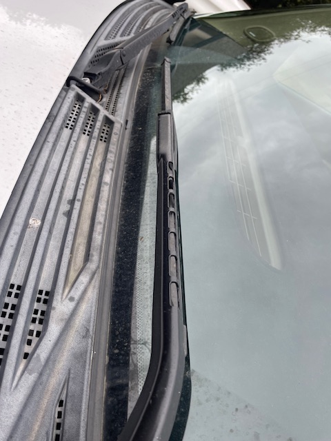

Y'all,
One of the things that's irked me in the four months I've owned my '13 Tahoe is that the windshield washer squirters are positioned on the trailing side so that the entire upward stroke of the blades are dry, just what you don't want when trying to wipe the glass clean. What a terrible design!
I had been pondering fitting on-arm squirters from another car when I noticed our '23 Honda Accord rental this past weekend had arm-mounted squirters that were positioned on the leading side, wetting the glass ahead of the upward stroke so the blades are actually wiping fluid, not grit & grime. Unfortunately, it slipped my mind to get a good picture of them.
So, has anyone modded their windshield washer squirters to a "leading side" arrangement? If so, what components did you use?
Thanks in advance,
Scrappy
