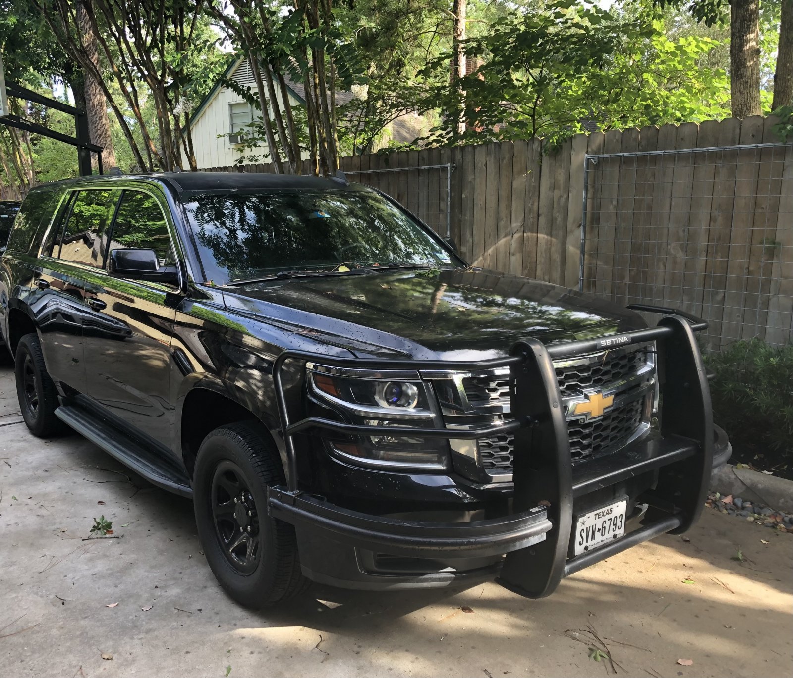

Edit: 191,000 miles. Bought it at 172,000 from the state of Texas. Previously was a state trooper car.
Runs great, occasionally get vibrations on idle at a stoplight.
