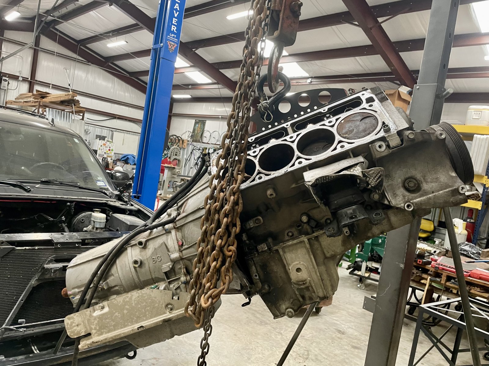

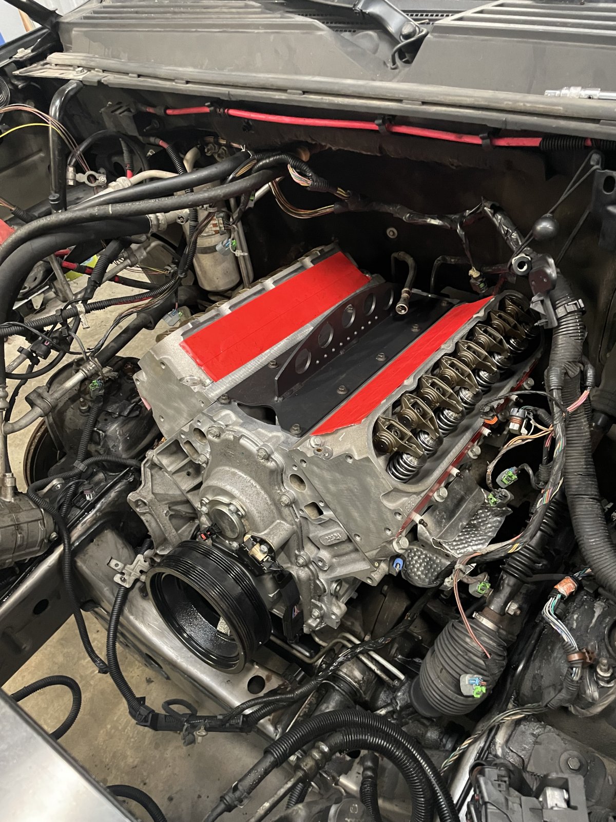

For what it’s worth, I just removed the engine and transmission from my 2009 Yukon Denali (AWD) as one unit. The engine was seized and there wasn’t anyway to disconnect the flex plate from the torque converter. It was a beast of a job and I ended up having to pull the heads inside of the engine bay to get the angle I needed to clear the firewall and the front support. In hindsight, I should have removed the radiator support. Didn’t want to discharge the working AC, so moved the compressor to the side. Put the new engine in and then put the transmission in from the bottom. Fun times!IMG_2176.jpeg IMG_2146.jpeg
