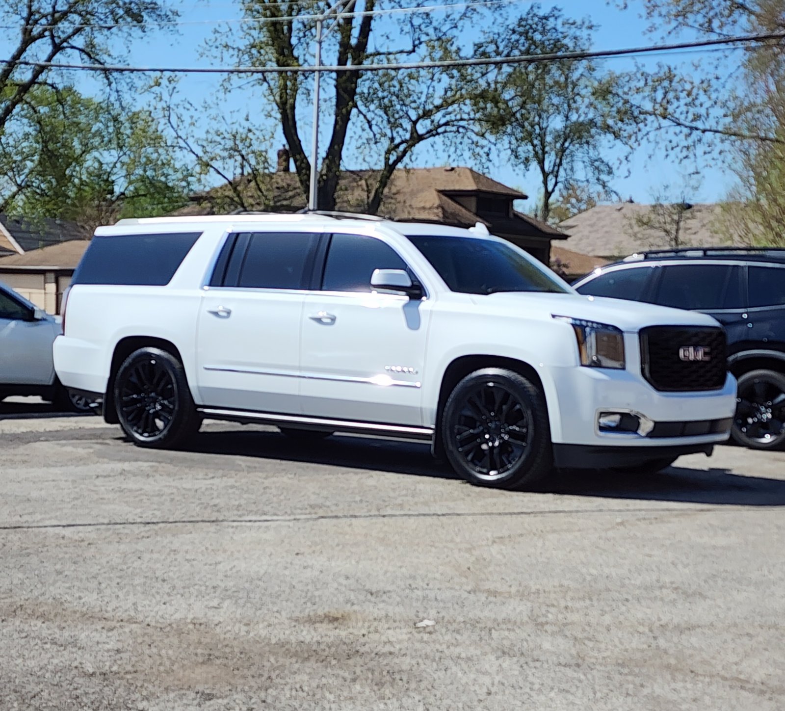

Pics of the truck, please.
I cannot personally assist you with your issue, but other members of this Forum much more knowledgeable than me in this area will chime in.
@NickTransmissions is our resident transmission expert, and he will chime in with his perspective on your issue.
Thanks for the welcome! I honestly don't think I have any photos of it. I'll have to take some after a good wash.
