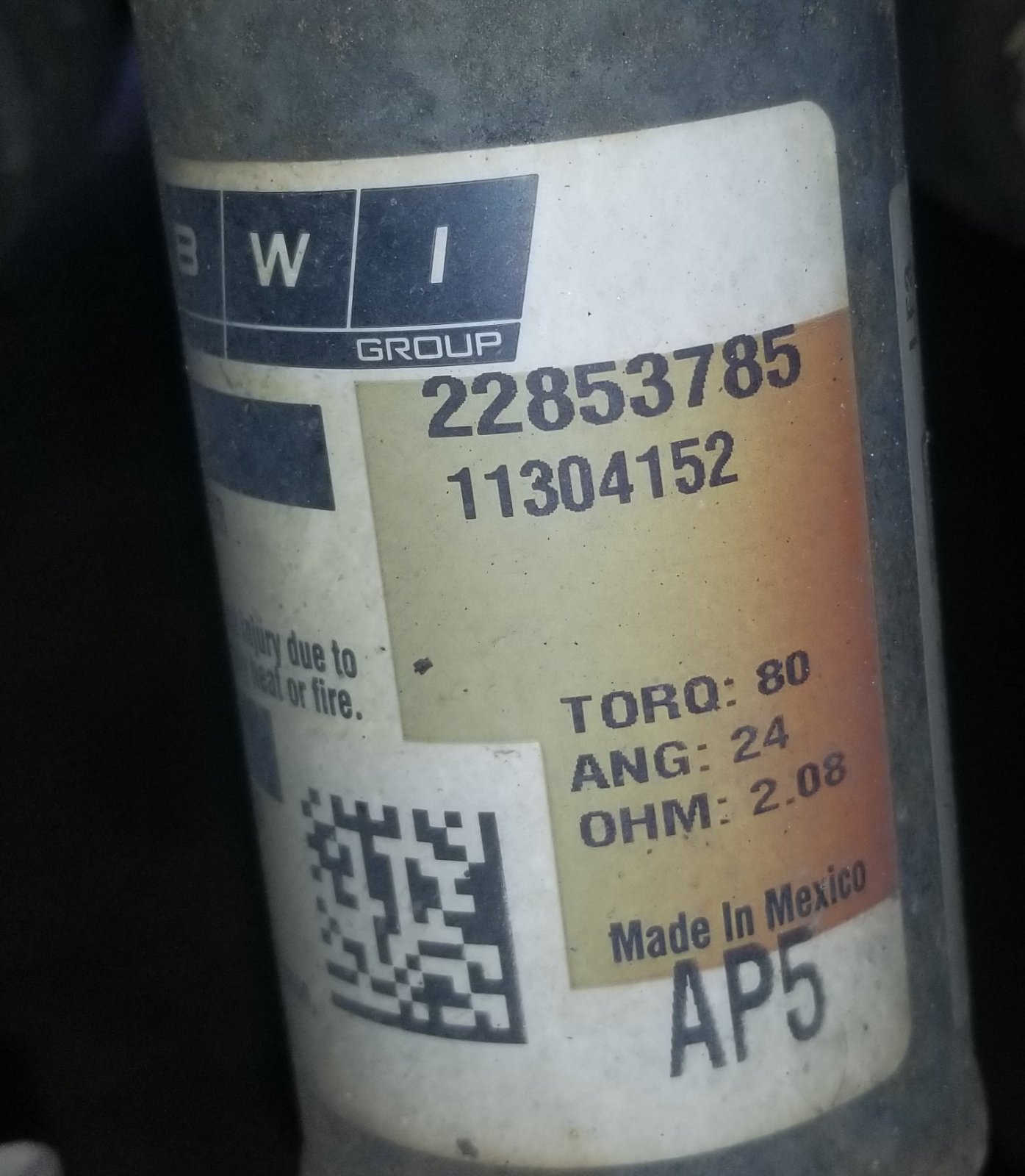

This is a pic of my front strut, safe bet these are OE with 120K miles....ouch.
I purchased this with 92K on the clock and these have been on my to do list.

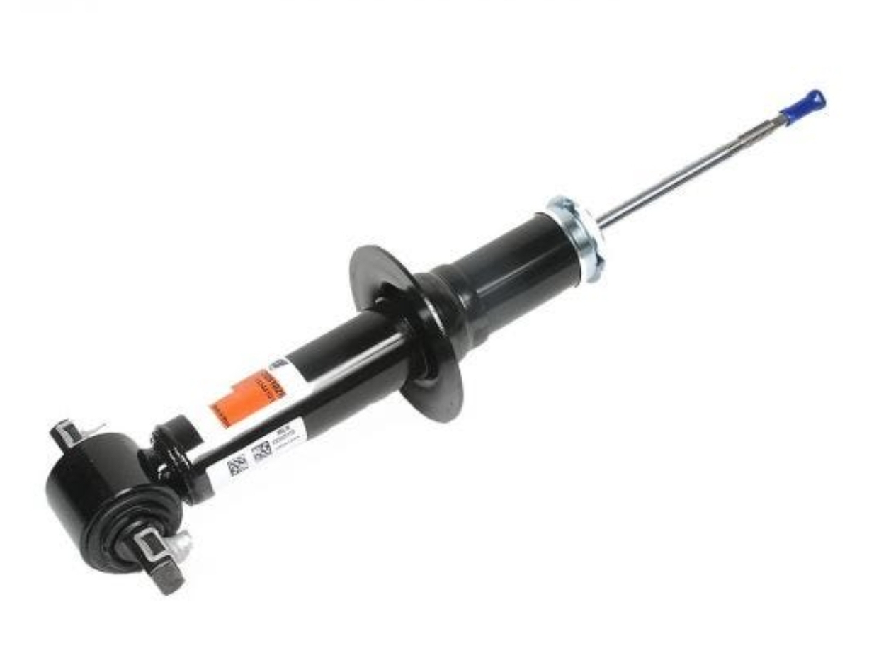

I have no idea if this is the correct part number, but this looks exactly like the one I have, identical stickers as well.

I wouldn’t just go ordering shocks. There are a bunch of different part numbers of the electric shocks depending on options of the vehicle like wheel size and the difference of magna ride and auto ride. Try calling GM Parts Direct with your VIN and see what number they give you.
That one looks right to me.
Also available on Amazon (at a higher price but with free shipping and returns) and the comments suggest that it's the right part for the Z55 suspension.
Or you can get the Chinese knocks-offs (still magnetically controlled) for hella cheap with the springs already installed. I would be willing to try these on an older truck just for $hits and giggles.

Thanks for the link, that's the one I keep ending up with also.
However like @91RS mentioned, there are many variables.
If you take the last two digits, ie..580-4xx and change them by one number, to 32 or 31, etc, you get a different 8-digit cross reference to the OE BWI number on the strut cartridge.
So safe bet it would work, but how different is the internal valving/damping between each one? That's my dillema right now, trying to keep it OE.

It’s very weird to me how the part number on the shock doesn’t come up on Google or any of the online catalogs, usually that’s the easiest way to get the right shock. It’s also even more weird how you’re saying the dealer catalog (which is not the same as the 3rd party catalog on all the parts web sites) is giving a part number for a non-electronic shock. The dealer may need to call GM’s parts help desk. That is why I suggest calling Flow Auto Center that runs GM Parts Direct, they should be willing to do that for you if you order from them. They might be a little more expensive than Rock Auto but will still be cheaper than list price at your local dealer and you’ll get the right part. There’s also a parts guy on here that might be willing to call for you but I can’t remember his username.
The part numbers for mine are probably different because mine is a SWB. The fronts are prossibly the same but I’d bet money the rear shocks are different between a SWB and LWB.

Anyway, here's what I have and my RPO codes, usually the dealer has all the info but all of them come up with the same part# 19420494
