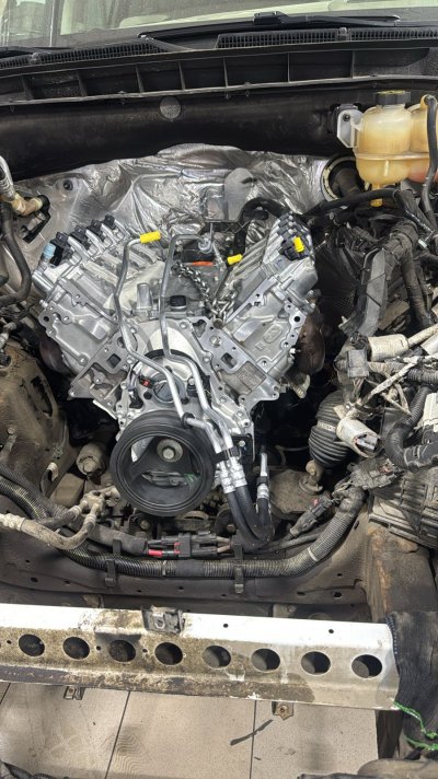

I don't know if they will handle old engines. In our experience, 9 engines out of 10 need to be improved, such as we are doing with my new engine

The next day, the engine was assembled and installed in the engine compartment.
