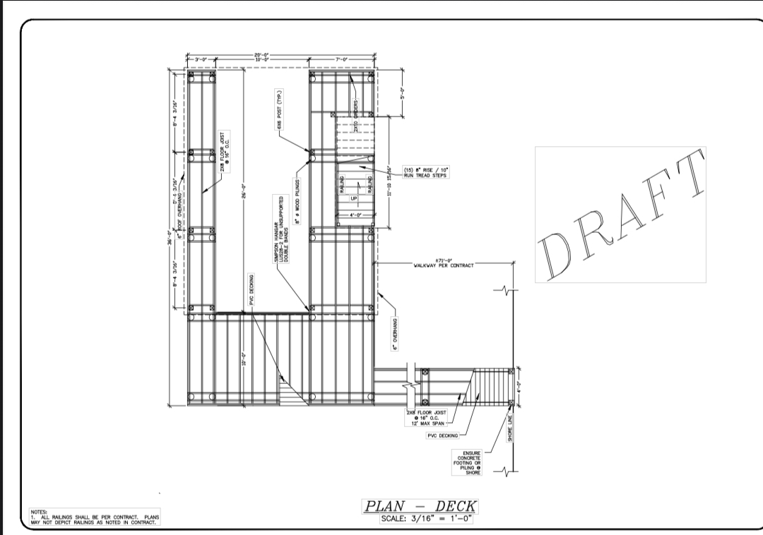

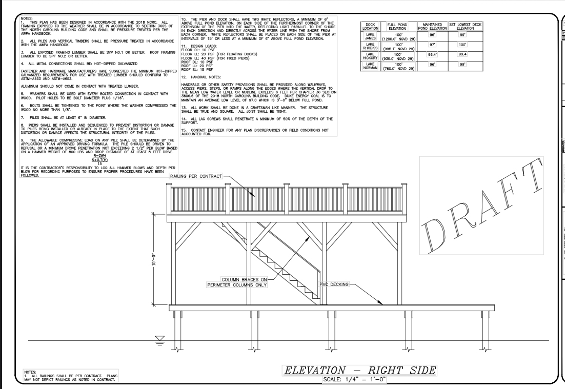

Small update... Engineering plans were sent to us today for the dock. There's a few pages but I only attached 2. The only thing we noticed was the timber was 6x6 and not 8x8, so thats being adjusted. The vertical posts will all be 8x8 and go from the lake bed to the second floor continuously. The railing on the plan is just for illustration, our railings will have 2" black aluminum upper and lower rails with 8 metal cable rails in between. Thats for the upper deck only. Really stoked to see this all go down. They are estimating permitting to take 4-6 weeks and then another 2 weeks before they start demo of our old dock.
Second story is going to be a nice touch
