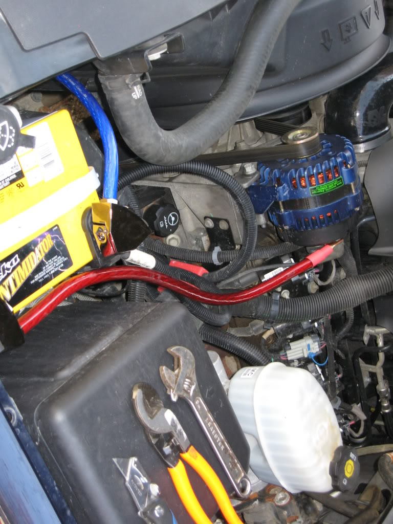

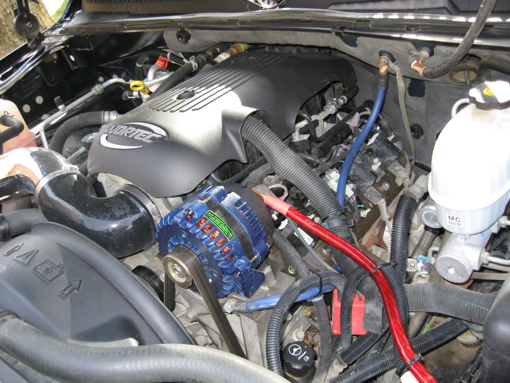

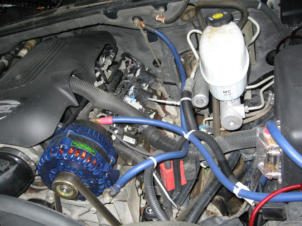

Lets start at the electrical upgrade.
Thing still works great!

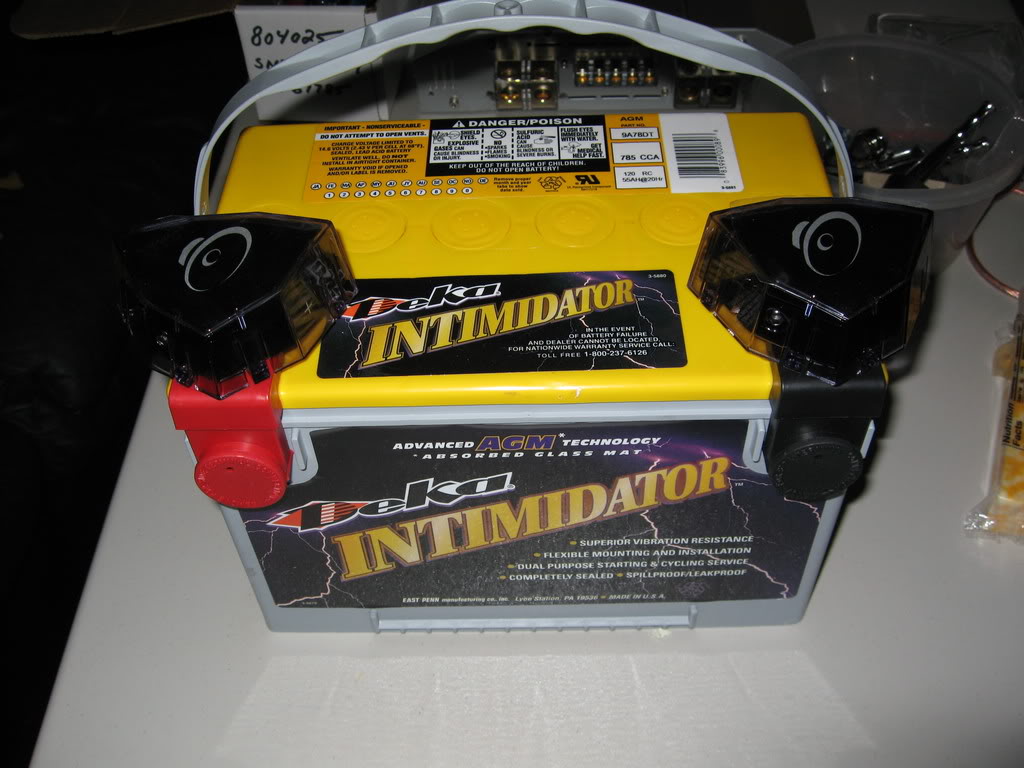

Big 3

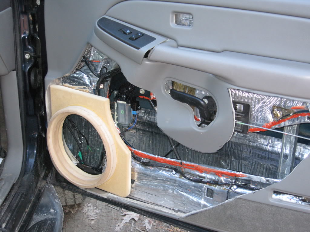

Deadening. Still have to do the rear doors and roof.

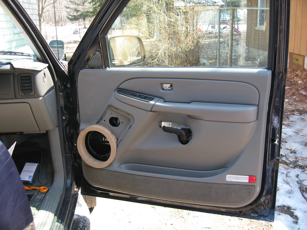

When 8" midbasses were a good idea. It could have gone a few ways I guess.
And then the 10" midbasses were an even better idea!
I'm gonna wrap these panels as they stand and I'm going to start some panels from more of an MDF base. I'm going to keep the top portion of the panel to keep the hangers and cut the rest off.

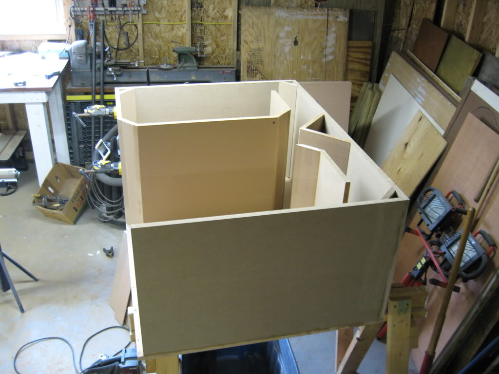

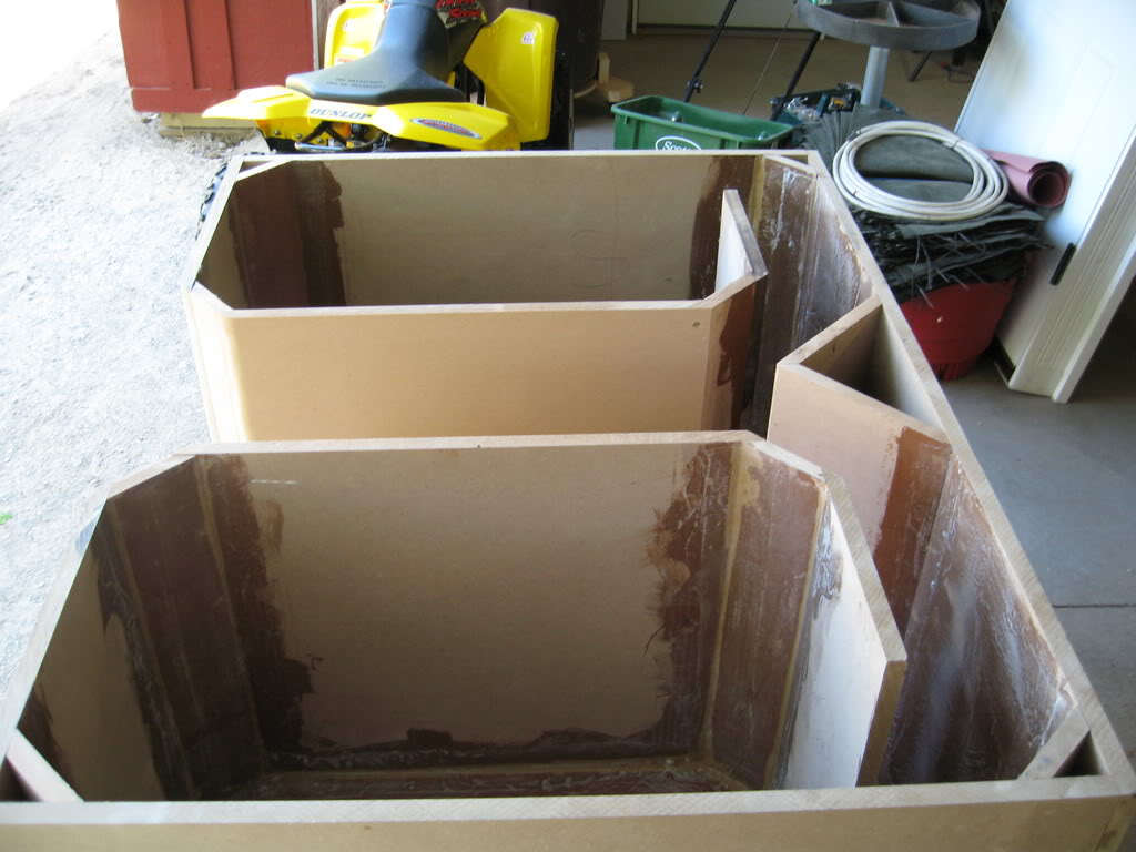

Lets get to the woofer enclosure. The only update on this box is that it now houses Q's instead of BTL's. Now if that raised a brow each chamber is 6 cubes and thats the low end for the BTL's but its damn near right on for the Q's and they sound sweet! I also sprayed some rubberized on the box to coat it with something don't really care...lol

I think the box could be a smidge bigger lol... Those door panels came out great man... Nice work!
Actually your right. With the BTL's it could have been but would have choked the box because of being too close to the lift gate. Now with the Q's its perfect! Even port area! I could probably put any 18" woofer in this enclosure.
Yeah the panels are sweet but wait til I get started on the finishers!

looks great, how much are those alternators? I need a bigger one, esp if I add another amp and more speakers.
W
WrenchGuy
WrenchGuy
Jun 1, 2009
179
Actually I tried to get mods at TF to let a group buy come through.
Nate at EA likes a group buy and cuts a little off the top. I think I paid $420 or something like that for the 300 amp.
If the mods would like I can still set one up I'm sure. Mainly its running dates and at least 10 alts have to be ordered to benefit the group buy.

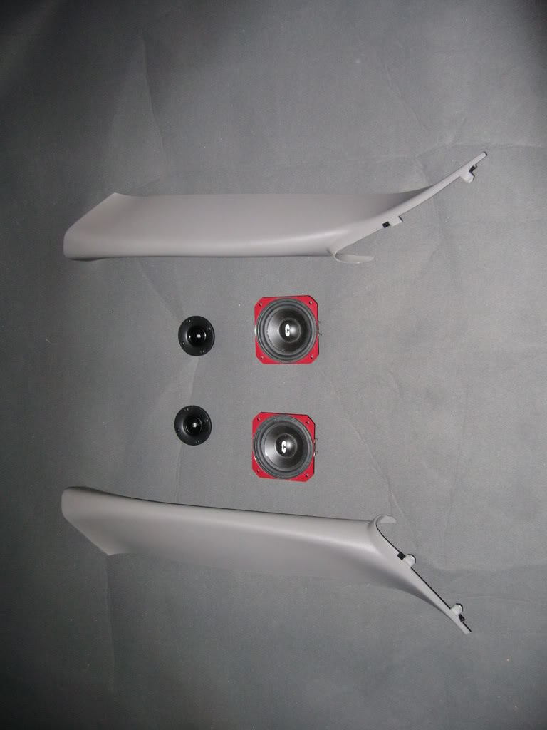

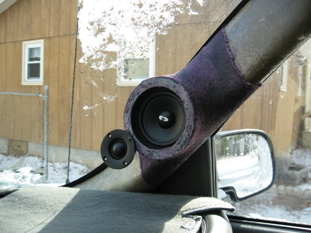

No I actually took the midrange out of them.
I might just get new trim and mount a 1 inch in them or make a couple standoffs that will hold large formats. The tweeter area is tweeter dependant at the moment.

hey u got any finished product pictures of those A pillars? i really like what you got going on there.
I want to do some upgrading to my stereo (dont have enough balls to go as far as you have)
No. I'm actually still trying to figure out what FINISHED is....lol
Don't be scared. I was skeptical but its all been worth it. A Pillar replacements are 20 bucks at the salvage. I invested 140 bucks in panels. Its really a cheap start after you start buying all the shit to stick in em...lol
